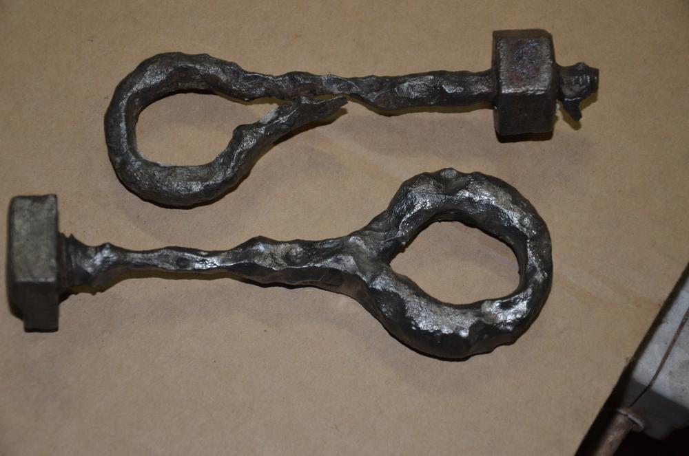

I was told that soaking in molasses is a good way of cleaning rust metal. I was a bit dubious but I gave it a try. About 20% molasses to water and the rusty objects were left in for about 3 months. Here's a before/after pic of  wrought iron railway spikes. I think it worked pretty well so I've thrown a couple of dozen in the mix. The other pic shows two very rusty eyebolts after the treatment. Perhaps I can find a creative use for them.

No negatives if you give it a good clean off with water mate.
Yeah, I scrubbed the gunge off them pretty well.
Really brings out the grain, good job
Attracts critters in the shop; finding dead mice floating in the bucket is not my cup of tea especially when I'm not checking it every day...
Vinegar works great, is a lot quicker than 3 months, is cheaper and surely not as messy.  I prefer molasses on my buttered biscuits or pancakes. ^_^
