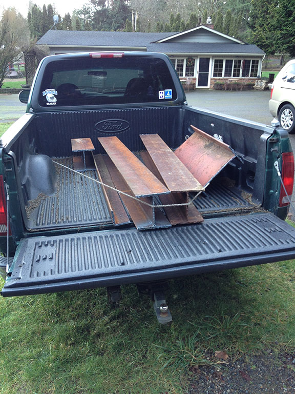

The frame is 8" x 8" H-beam with an 8" x 16" I-beam as the top cross member. I tend to overbuild, because I'm not an engineer, and that happened to be the smallest stuff the scrap metal yard had, that was big enough. My dad's an engineer though, and after measuring it and some mental calculations, said, "it's skookum enough"

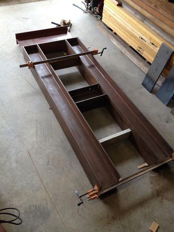

Well, I'm close to having this press finished. Here's some pics showing the sequence of the build.
Now my dad and I are having a debate over the specs of the press. I've been following Jim Batson's booklet and so have purchased a 5hp 3450rpm motor, with a two-stage pump - 11gpm/3.6gpm and a 5" bore x 8" stroke cylinder, which should give me about 24 tons of pressure with a ram speed of 2.16 inches per second (i.p.s.) with no load and about .69 i.p.s. with load. My dad thinks that's way too much horsepower and thinks I (or Jim Batson, as the case may be) has some figures wrong. My dad thinks I could achieve the same results with a 1/4 hp motor. I say that the ram would move too slowly. I'm thinking about metal cooling rates while I wait for the ram to cycle. Dad thinks the ram doesn't need to move so fast.
