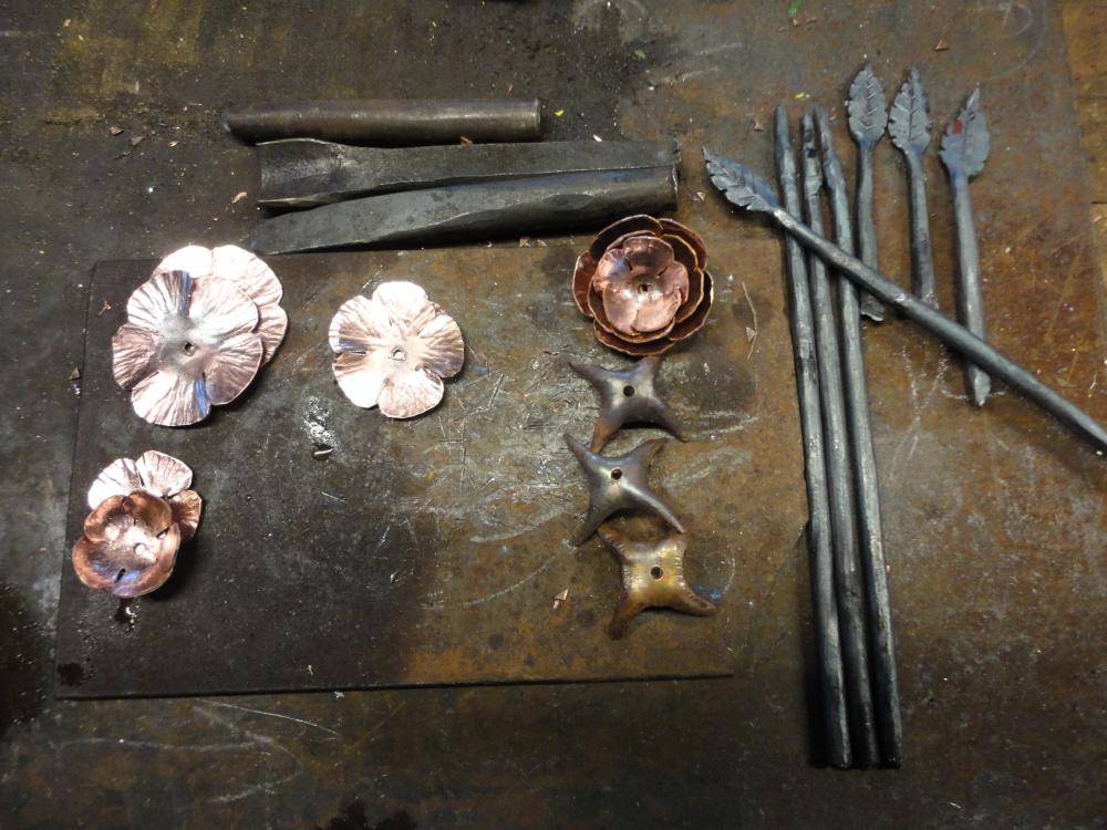

I've notched between the petals with the super thin zip disk and made a really narrow chisel to cut out the outside.  Not the fastest but does go good once your in a groove.   The material I have been using for  petals has been a 45 gal drum.  the stems and leaves are made from 3/8 round. P1040397.thumb.JPG.186f23f404d0c7268e031DSC02609.thumb.JPG.812ad73ec38dce9ecf03cDSC02610.thumb.JPG.13c23fc1368fec9867090DSC01613.thumb.JPG.86c4ab83e477db254ab9b

In the picture of the chisels you can see the start of some small copper roses.  1/4" round for stems and leaves and the tubing I had kicking around was 1/2".  with the copper I have been using three layers of petals.  I'd have to dig out the measurements for the diameters on the petals but can post if you like.  Other thing with copper pipe/tubing is anneal between steps.  Comes fairly hard as drawn.

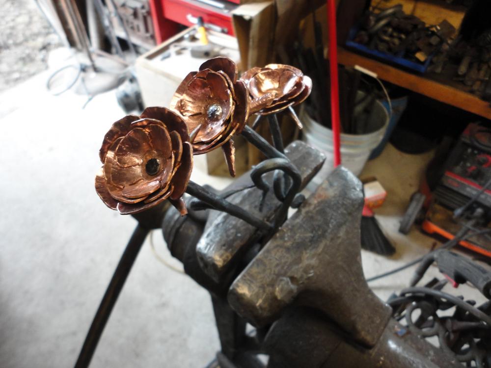

That must be a piece of 3/4" tubing Das.  The 1/2" tubing I unzipped this last weekend is 1 7/8" wide when flat.  I cut out the circles, drill the 1/8" center hole.  Stack like petals together with a nail or drill bit though the holes.  Clamp in vise and cut between the petals with a hacksaw.  Then a few nips on the corners and the right shape is achieved.  Texture and Dish. Anneal, DSC02611.thumb.JPG.c99f623437302f7618a14then they are ready for assembly.  I hope my plans are clear enough to help out.

so do you forge tenon on the end of the bar and stack on the petals and heat up the end of the tenon and rivet it?thanks for the pictures and the replies, they have helped out a lot. Dogsoldat, I really like the curved chisel that you made to help cut out the petals. assuming that you made it, to get the curved end, did you use a swage block, or what. thanks for all the help so far everybody!
                                                                                                         Littleblacksmith
I was trying to remember how I had done it before when I had started a few more this last weekend.  I think how I was doing it was step it down behind the lump. and take it to the bench grinder till the tenon fit the monkey tool I had made. Stick it in the clamp and set the shoulder with the monkey tool.  You do have to be careful if you reheat the peened end as the copper heats much faster than the steel and you never seem to get a proper fit afterwards.  This is were a good known mild steel works best along with a long slow cool down so it doesn't harden any. I do remember I ended up with a piece of medium/high carbon round that would air harden easily being so small.  That set of stems ended up in the scrap bucket simple couldn't peen the end over.  Can't remember whether that curved chisel was for roses or something else but it does help on the copper sepals.
