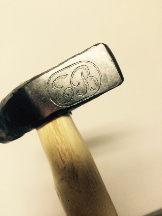

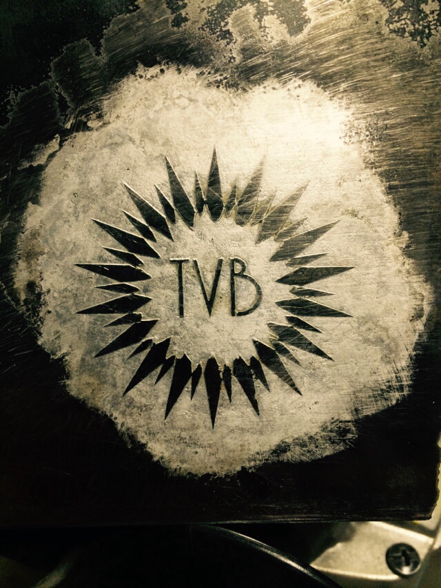

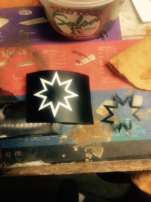

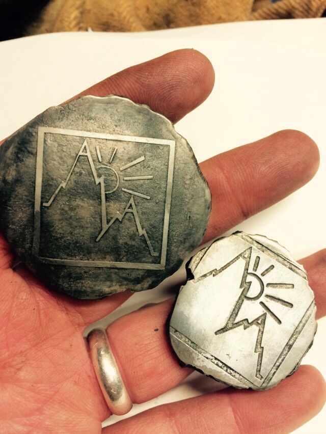

teenylittlemetalguy Posted March 2, 2016 Share Posted March 2, 2016 I use a Cameo Silhouette cutter to cut the vinyl . They are under$300. then etch with a battery charger and salt water. I have a video but can't seem to post it now. Will try later. here is a quick example Couple more examples Video clip, sorry about the poor quality. The vinyl comes in rolls and you cut what you need up to 10' long and 12" wide.capacity in the cutter. it is just like a sticker. Quote Link to comment Share on other sites More sharing options...

Frosty Posted March 2, 2016 Share Posted March 2, 2016 Etch it then have it galvanized. There used to be a plating shop on Mtn. View Drive maybe 2 blocks from you Tristan that electro galvanized. They also made Alaska Husky batteries. It also makes good sand blast masking, not to mention silk screen patterns. Handy gizmo. Frosty The Lucky. Quote Link to comment Share on other sites More sharing options...
