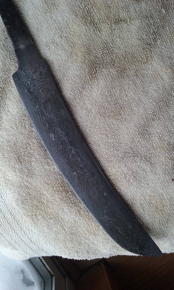

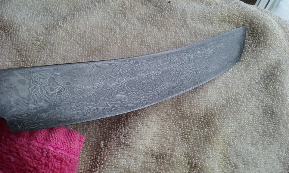

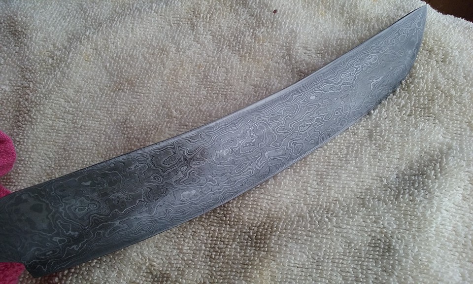

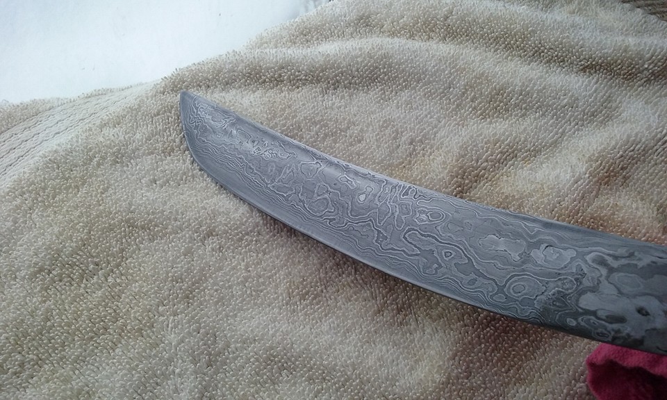

January 17, 201610 yr So my teenage daughter asked me to make her a samurai sword... Gotta love the young people. Since there are no swords in my future, and she doesn't even have to slightest clue what to do with a katana, I decided to just make her a katana shaped something. While I was waiting for my steel order to come in from Kelly Cupples, I just decided to have some fun and weld up whatever I could find lying around. I wasn't actually planning to make this when I started... I just wanted to get some more practice in with my forge welding, but everything was welding up good, so I just kept going until I decided to give it some shape. Figured I'd do my best to give it a katana "look" and then my daughter can hang it on her wall and tell her friends how cool her dad is. Blade length is 9". Steel is a mix of old leaf springs, an old file, part of a lawn mower blade, and whatever else I happened to lay my hands on. Came out at 132 layers, and then did it san mai style, drawing it out and wrapping it around a 5160 core. It will never see any use, but figured I'd practice that too. I haven't really been to worried about the fit and finish on this one, but its still coming out kind of cool, especially for a teenager's decoration.
January 17, 201610 yr That turned out extremely well. Very nice profile too. Are you going with a tsuba style guard? I can't wait to see the end result. I believe that your daughter will love it. Good looking tanto. Robert

January 22, 201610 yr Nice, I love doing Frontier damascus, it's a lot of fun to play with and you never know exactly what the pattern will turn out like.
