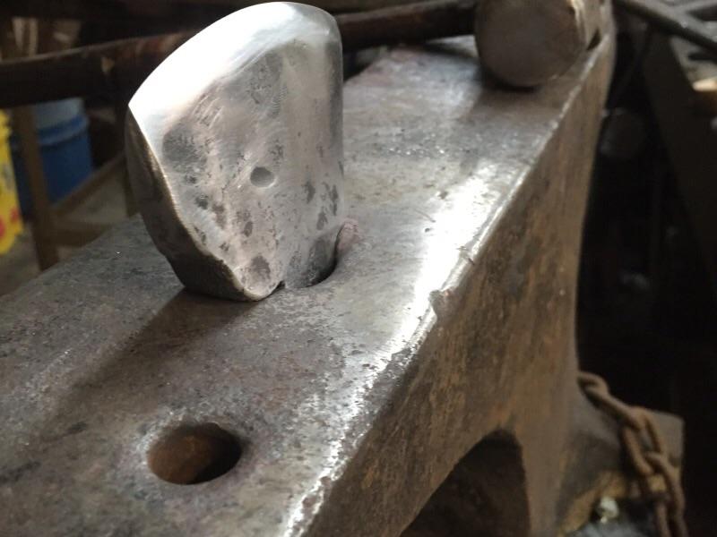

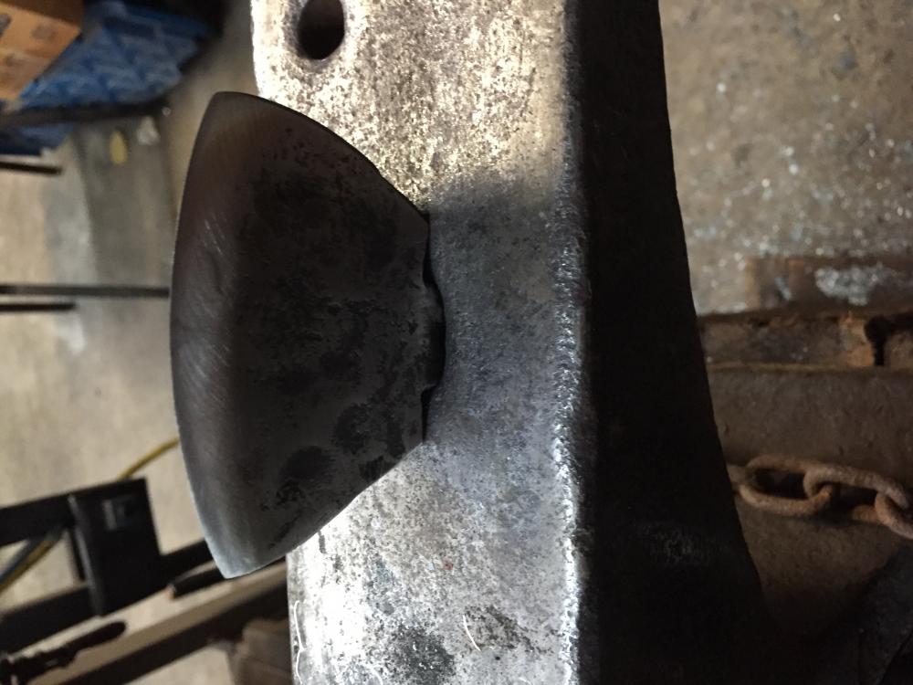

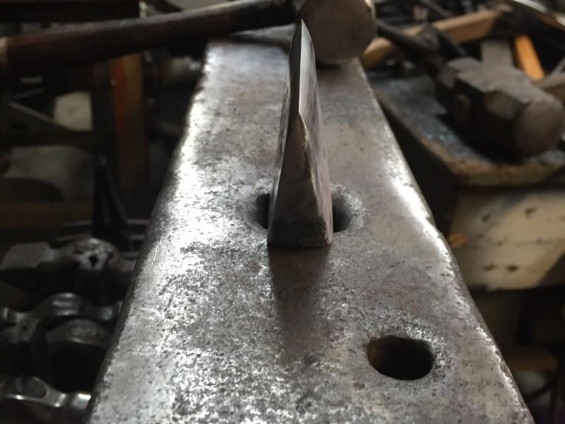

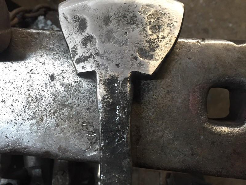

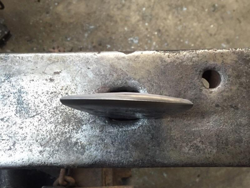

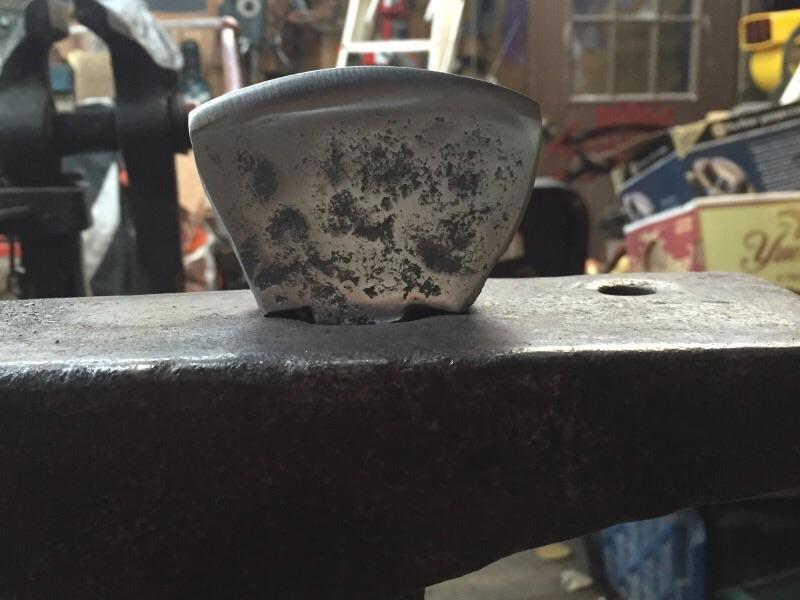

Ok so while I was attempting a nail header and failing I worked on my first hot cut hardy. Here is what I came up with. It was 3/4" by 1 1/2" stock. My hardy hole is about 7/8 if I remember right. I actually haven't tried it yet and that's the best test. But I finished it up at the end of the night.
it fits great( tight) actually. i have other tools that that is a great idea for tho. :)

Do you know what kinda steel or was it mystery metal?? But a nice looking cut off, if it cuts which it looks like it will just fine that's what matters if it doesn't hold up make another
Remember, spring is the important part, not a solid wedge, iether a thin peice with a kink to stedy the tool or one shaped like a holddown. Depending on the shape of the hardy tool
It's mystery metal. And yeah it it dosn't hold up i'll make one from truck axle and see how it holds up.
Well it was good practice alteast! Axle would be good I used a peice of 1 1/4" torsion bar of a dodge ram for mine, could be tougher but it holds up just fine for me , get ready though next one will be more of a workout to forge.

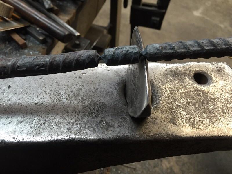

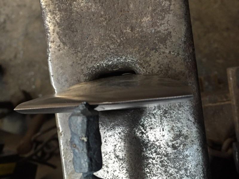

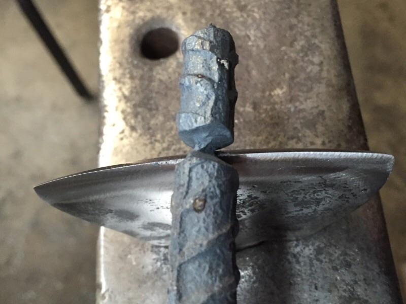

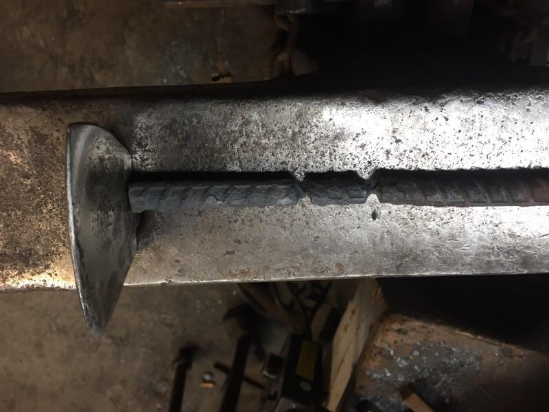

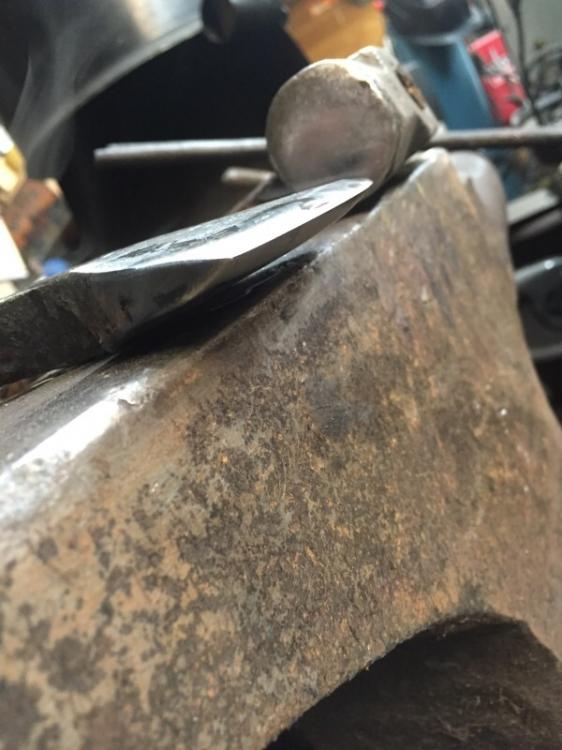

Ok so, it worked great. It dulled a hair but it didn't dull bad. Tried it with 6mm rod and round about 1/2 rebar.

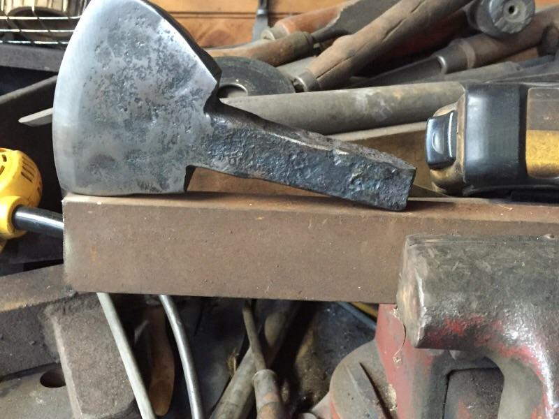

sorry, the last pic is the parent material..
Looks like it worked just fine, when I started using mine it dulled a bit but it has more or less stayed where it is since the first couple of uses so it seems you have a fine cut off.
Hmm...looks rather like the one I made from a jackhammer bit, shown here with the spring clip that hardens up the fit in the hardie hole:
Didn't have a jackhammer bit, but ya can't beat a good design.
