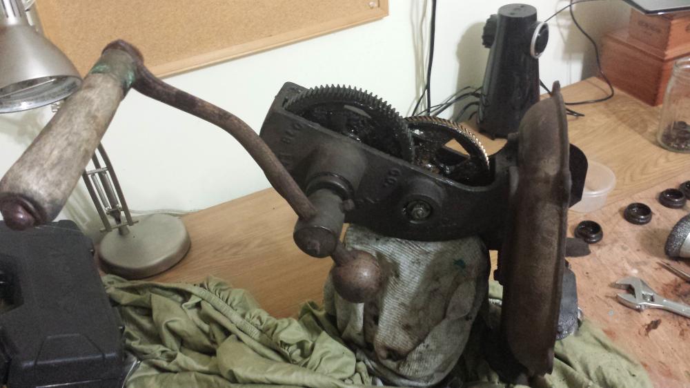

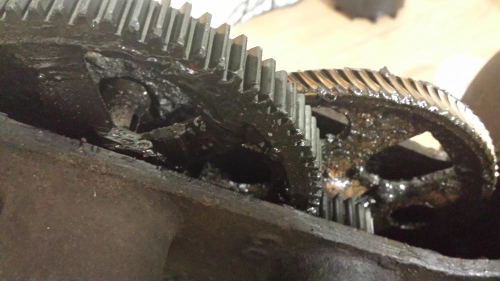

Update - lagging a bit in my own breakdown efforts. My 400 is really stupendously coated in grim and greasy grit. I've decided I'm going to have to disassemble it completely after I took a look at the gears and found there is SAND in the gearbox mixed in with the copious grease and oil. I won't sleep well at night if I don't get every last grain of sand out of the machine because I assume the bearings will seize up in a year or two of normal use.

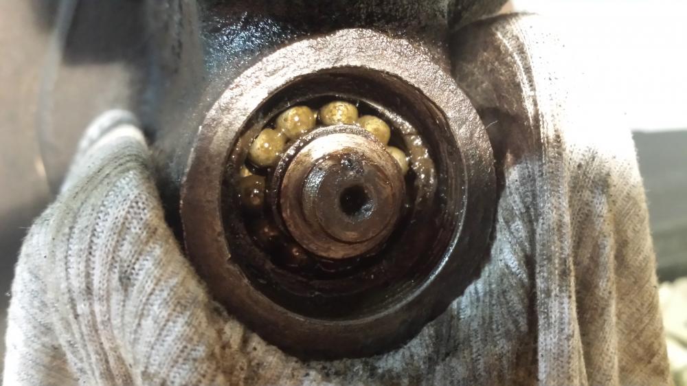

I've gotten the dust caps off and removed the rear fan shaft lock nut. Pictures are attached. You can probably see some of the pitting on the rear fan shaft bearings in the picture.
As with Bo, I've been reading a lot of warnings about what not to do and am going slowly at every step to make sure I understand what I'm doing before I do it. Next step is going to be sorting out locking the fan shaft like Bo was working on.
I'm beginning to wonder why this machine was setup at a 90 degree angle vs. all the other blowers I've seen that are parallel to the fan. It seems like it makes the gearbox necessarily complex.

Looks like that bronze worm gear is really worn. I still recommend not futzing around with it. Any misalignment between that and the shaft when you reassemble will accelerate the wear and shorten the life span. Use some degreaser or kerosene to clean/flush out the inside well then recoat it with motor oil. A few grains of sand isn't going to hurt anything.
As for the bearings, the rear shaft is just loose ball bearings. The other three sets can be replaced with bicycle race ball bearings. I don't recall the size but I'm pretty sure all three are the same size. When you pull the handle off, is there a lot of wear between the shaft and dust cover, or is it a nice fit? Oblong/oversized hole would indicate a worn cone nut.
If you insist on removing the fan, try a large channel lock grabbing the hex between the fan blade arms while you break the nut loose with a socket. Worked for me, just be careful not to break the fan arms (grip it tightly).
Realistically, trial and error until it feels right. Remember that you are dealing with side-to-side alignment as well as front-to-back if you tear it down all the way (remove the bronze worm from it's shaft). And you have to leave enough end play in the shafts so they turn easily. Meaning, if you tighten the cone nut too much, the bearings will put a bind on the shaft and it will be hard to turn the crank. Either way, it's your equipment, you do what you feel is best.
