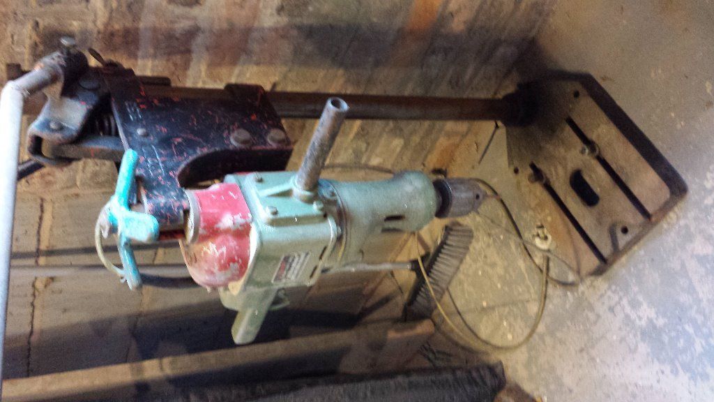

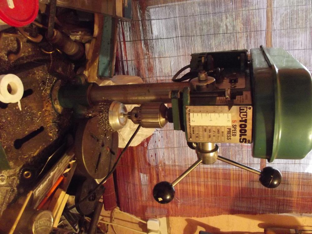

Rainbows Posted May 7, 2015 Share Posted May 7, 2015 So I have the oppurtunity to get a drill press for relatively cheap. However I also already own one and I'm not sure which is better for blacksmithing needs. I'm gonna have to use an Ask the audience lifeline for this. Maybe I just want to be able to blame a stranger on the internet incase it all goes wrong.Current drill is grade A taiwanesium. Its a cheap Nu Tool drill witha 1/4 HP motor and 13mm jacobs chuck. It isn't bad, espeacially considering it was £10 but when using it for long periods the motor gets warmer than I would like and I have to go off and do something else while it cools down and the other problem is the table tends to flex easily. The 520 and 900 RPMs suit most of my needs. I haven't used the image uploader in a while but I think I got an image of it at the bottom of the post.The drill on offer, for £20 + fuel and time to reach it, is a drill in a drill press holder. I usually consider such set ups only good for DIY carpentry however it is a Wolf drill with a morse taper socket, 1" capacity, 380 RPM and the motor amperage is 5.75A vs my 2.4A which through the power of P=IV I assume means over double the power of my drill press. Image also available for it. I have never heard anything but songs of praise for the Wolf brand apart from the fact that they would break your arm before they break themselves. So what do you guys think? I inherently distrust drill holder presses but this one seems like it might have a higher specification than my current set up. I never really use the top 3 speeds on my current drill but going straight down to 380 RPM might be a bit much. I don't think I have ever needed a 1" capacity but I suppose when you need it you need it so it might be good to have for the future. If anyone has expierence on using that particular Wolf drill I would be glad to hear how they found it worked out. Also I expect someone would say buy it and keep both but this is all for a hobby and space is the scarcest thing I have to use on this hobby (money being second and so far I think I have spent as much money on this hobby as some homeowners spend on a diy drill). Quote Link to comment Share on other sites More sharing options...

Rainbows Posted May 7, 2015 Author Share Posted May 7, 2015 As far as I can tell it is single speed. I might indeed buy it as a hand drill and put the stand on ebay or long term storage. I think the stand is a bit bigger thans Frostys so it might be awkward to clamp to stuff. Also does anyone know how it would be attached to DC electrics? It has a standard UK mains plug and I am just trying to work out where you would get 250V DC from. Quote Link to comment Share on other sites More sharing options...

Rainbows Posted May 7, 2015 Author Share Posted May 7, 2015 I think a pretty old pedestal drill went for something in the region of £80 locally. Never saw it close but based off the images I think it had a auto feed and a form of backear for tapping but alas you can source or make bargain price - high quality tools but getting the land to put them on is an entirely different matter.Think I will buy it, see how well it works and decide which to keep after testing. I was checking through ebay and the drill model without the stand went recently for £50. Its a win win win situation whether I use it as a drill press, hand drill or sell it! I don't think they make drills of that calibre any more. Quote Link to comment Share on other sites More sharing options...

Rainbows Posted May 10, 2015 Author Share Posted May 10, 2015 Conclusion: Oh my god it is big Quote Link to comment Share on other sites More sharing options...
Charles R. Stevens Posted May 10, 2015 Share Posted May 10, 2015 A true beast. Quote Link to comment Share on other sites More sharing options...
Rainbows Posted May 10, 2015 Author Share Posted May 10, 2015 Turns out I now have a new pedestal drill instead of bench drill. Not put it to action yet but I expect this is going to replace the old drill. A good £20 spent Quote Link to comment Share on other sites More sharing options...
