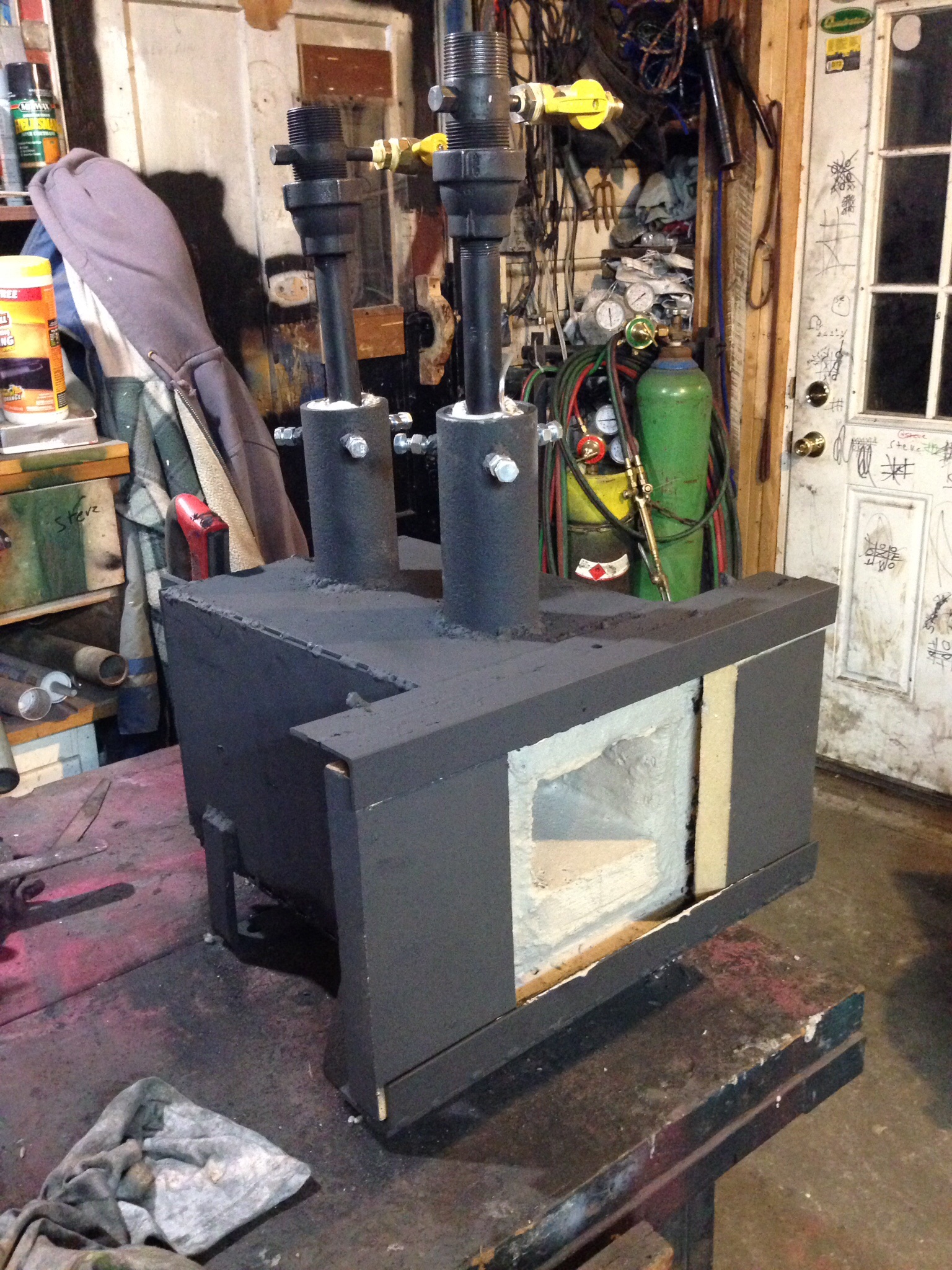

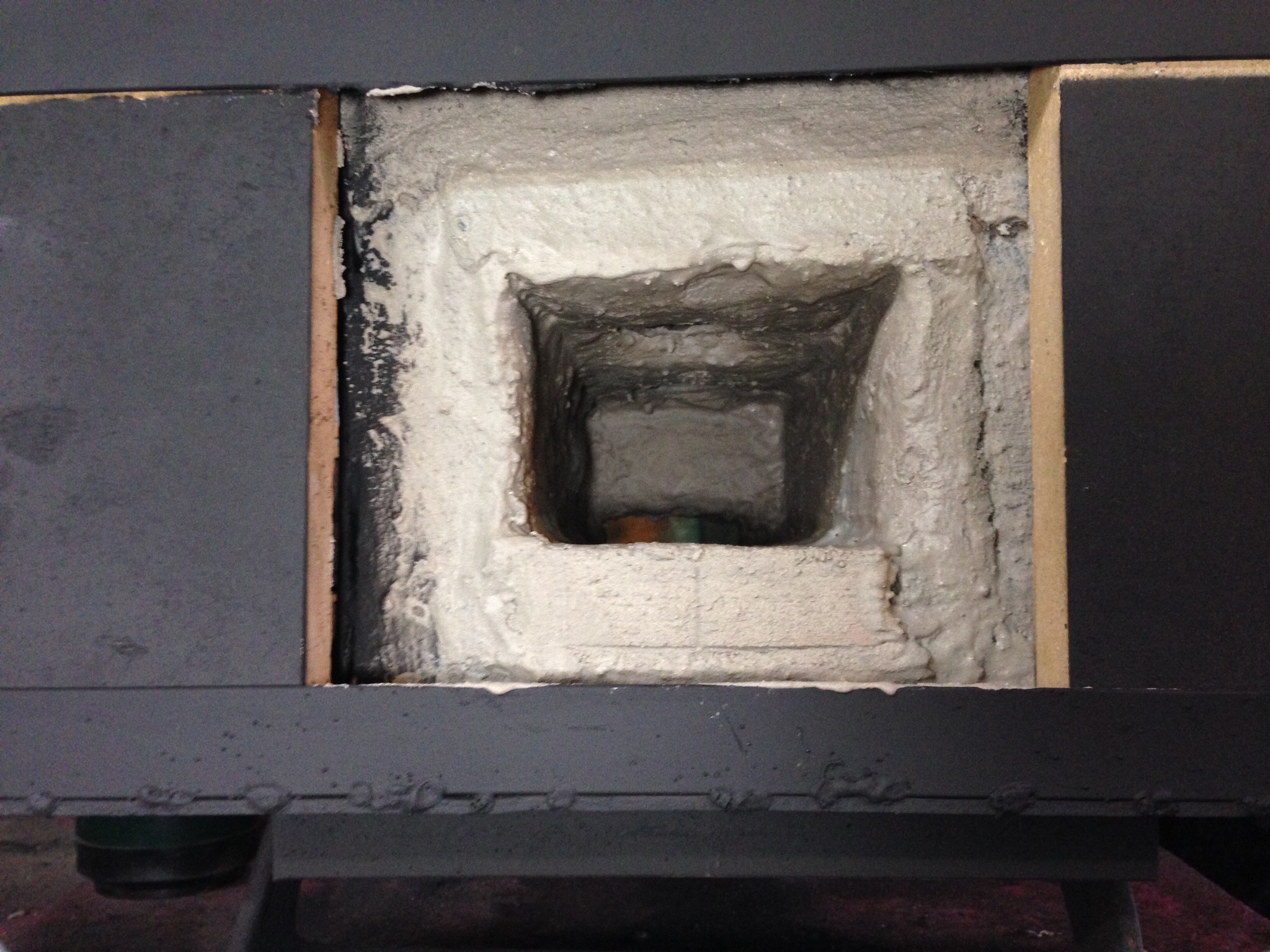

Here's my forge I built.  ~260 cm3 interior 2 burner forge.  Entire forge lined with 2" kaowool and coated with refractory cement x 1/4",with 2 coats ITC100 on outermost layer.  will get plumbed and test fire over weekend hopefully.  needs to be able to weld billets the size shown.

Looks to me like a rather large billet for that size door opening.  Does it have to go in on a diagonal?

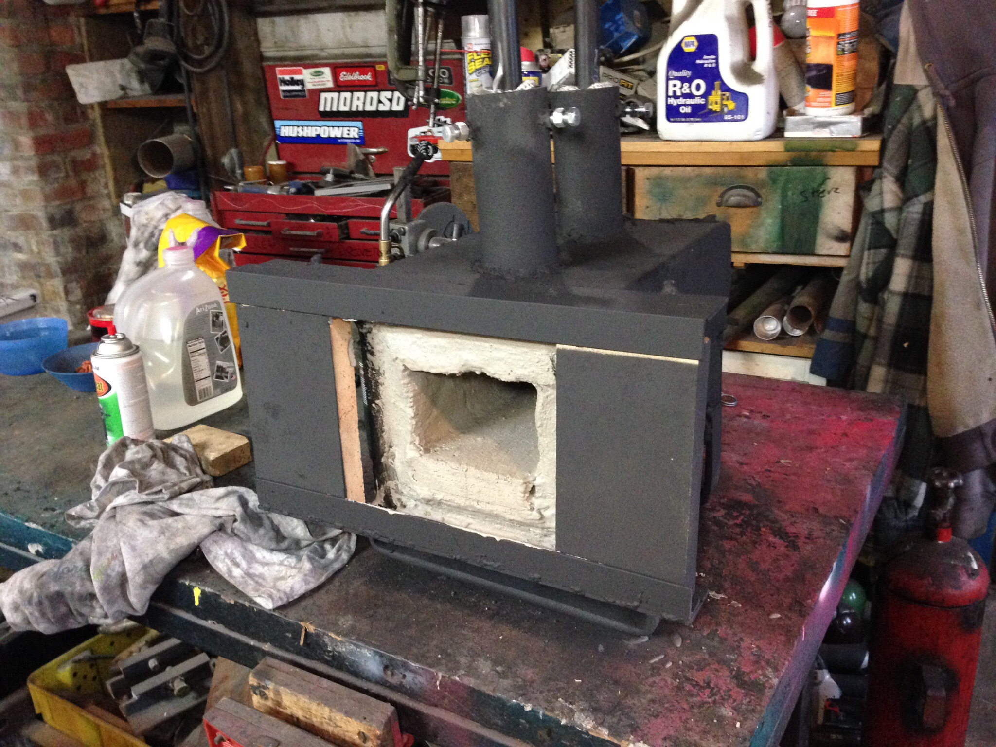

If tried by now,  how did it work?  I have built a similar sized gas furnace,  but with only one burner and fired on natural gas. Feel like I struggle to get to welding temperature. Haven't tried a bullet in mine yet, but hope to in the future.
Might want to put a fire brick to act as a door, on the top horizontal part of your opening. Heat leaks out, UP. Feed your material under it.
Look at Stumptown's Forge. The door raises, UP. Not slides sideways.

I believe you got the volume wrong, 260cm3 is less than 16 cu/in. Yeah, I'm being picky but it matters.
If those are 3/4" burners, even linears will bring that volume to melt your billet temperature easily. Sure they might need a little tuning but that's a LOT of burner for that volume forge.
It'll weld no problem and you'll have to keep it turned way down.

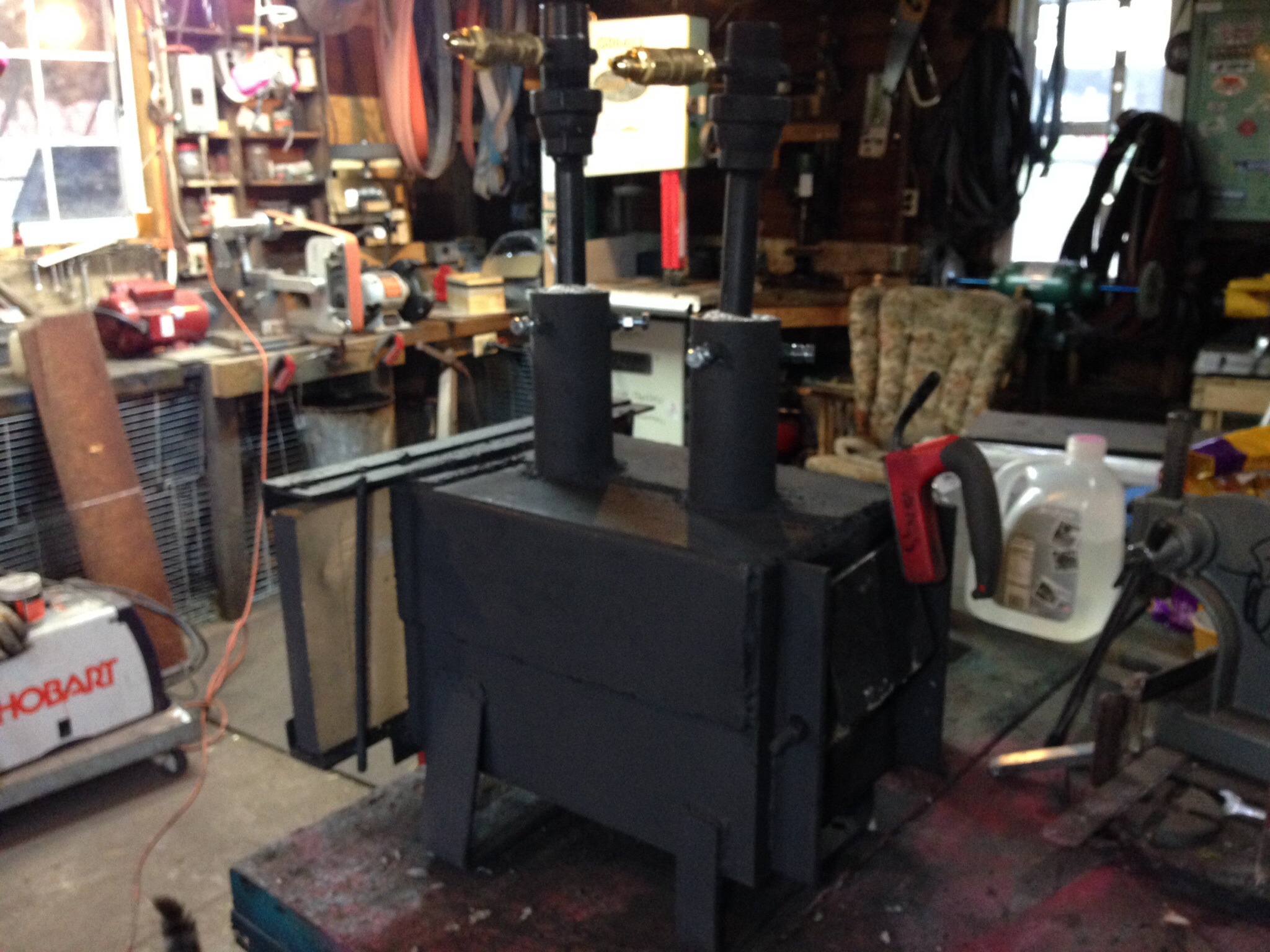

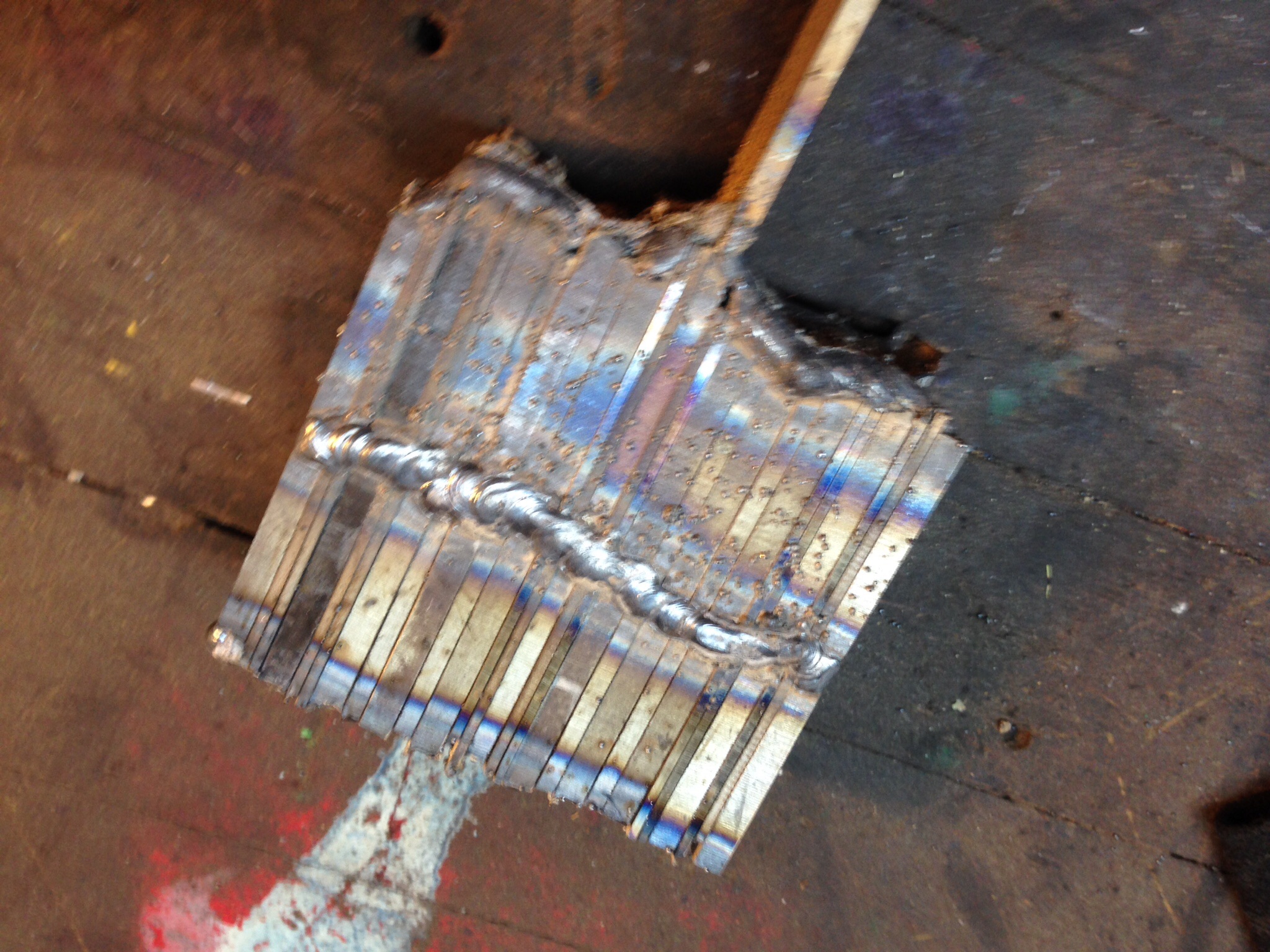

FYI - I still use my coal forge for making my billets as I am better there.  I use the propane for drawing out and heat treating right now
I also changed out the burners to the ones shown here which are easier to tune and control.
