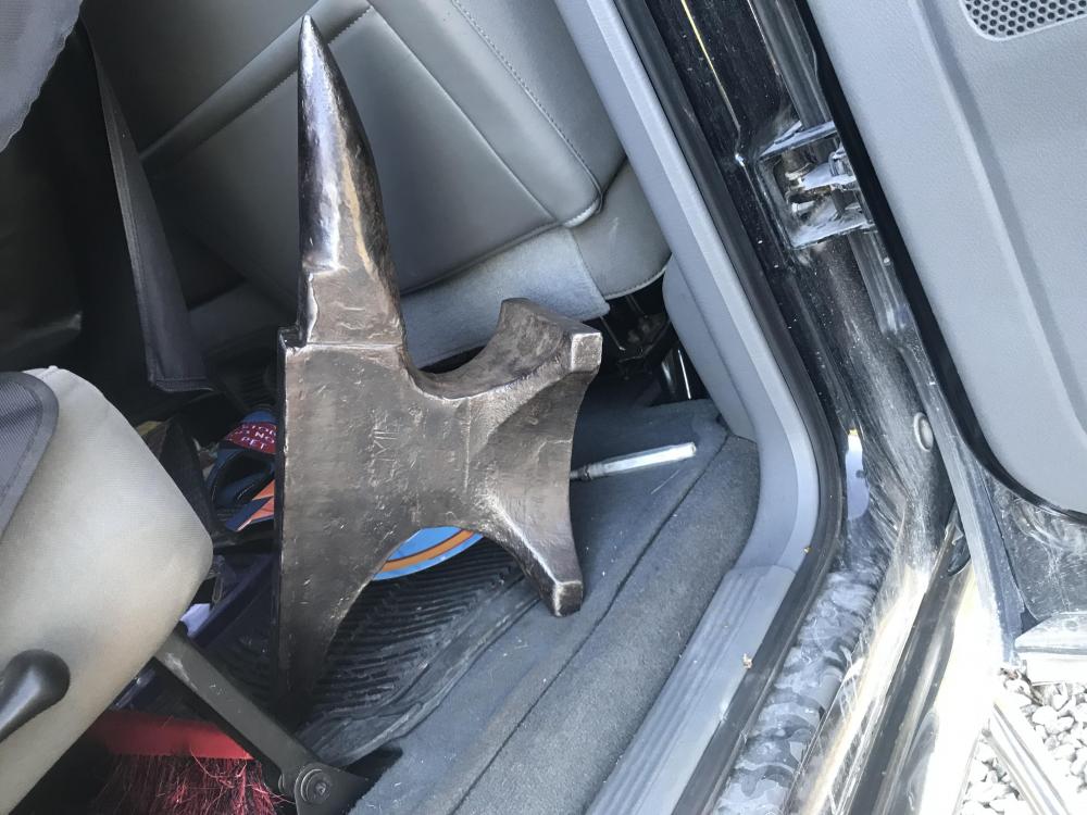

Larry Price Posted June 8, 2019 Posted June 8, 2019 Good score!I just My first Anvil today.A 1899 Trenton Acme 85# in excellent condition.He was asking $500 and I was able too get it for $350.1/2 ball bearing dropped at 10” rebounded too 9”. Quote

ausfire Posted June 10, 2019 Posted June 10, 2019 On 6/9/2019 at 8:41 AM, Larry Price said: A 1899 Trenton Acme 85# in excellent condition. A picture please!! Quote
Larry Price Posted June 19, 2019 Posted June 19, 2019 On 6/10/2019 at 4:07 AM, ausfire said: A picture please!! On 6/8/2019 at 9:50 PM, ThomasPowers said: Hey Larry; those Canadian dollars; or Australian ones; or Hong Kong; or Singapore,... Over 100 countries participate here; why I use US$ for at least the first time I post a price. There is $ in front of my prices. Quote

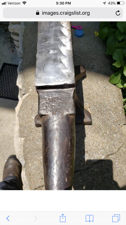

Irondragon Forge ClayWorks Posted June 19, 2019 Posted June 19, 2019 8 minutes ago, Larry Price said: Kansas U.S.A We won't remember that once leaving this post, hence the suggestion to edit your profile to show your location. Hopefully the seller didn't grind off too much of the hardened face of that anvil. Quote
ausfire Posted June 19, 2019 Posted June 19, 2019 Looks like it's had a savage resurfacing. Why do they do that!! I bet it looked better before. Quote
Larry Price Posted June 20, 2019 Posted June 20, 2019 Why is ever comment so negative??I really enjoy the fact that I can get into blacksmithing with my grandkids and get a big smile when I find a great old piece of history.No reason to be so critical of others equipment there starting out with.God Bless 5 hours ago, ausfire said: Looks like it's had a savage resurfacing. Why do they do that!! I bet it looked better before. The top working surface is flat and plenty of life left in it.Thats what matters too me.It will get better “looking” as I use it. Quote
ThomasPowers Posted June 20, 2019 Posted June 20, 2019 Everything is not all about you. In general we are trying to teach the greater world that grinding and welding on anvil faces is a very bad thing to do. Notice how they didn't say *you* had done it; just that it would have been better not done at all. Anything posted goes out to the world; not just the person previously posting. If it was specific to one person we could just use pm's and save the bandwidth. Quote

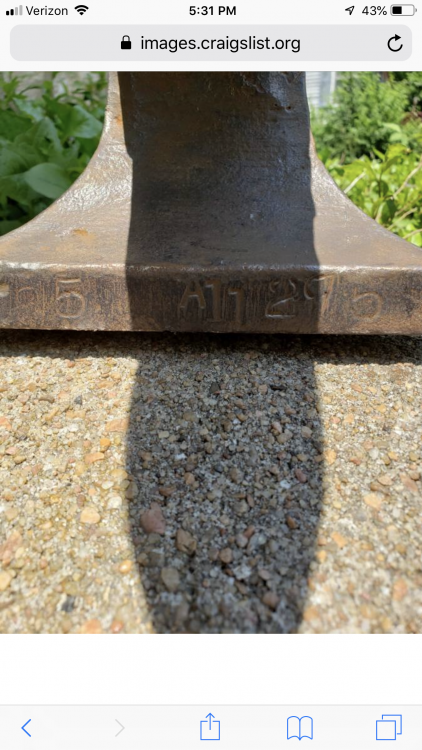

Black Frog Posted June 20, 2019 Posted June 20, 2019 Larry can you post a pic of the serial number on the front foot? Quote
Larry Price Posted June 20, 2019 Posted June 20, 2019 10 hours ago, Marc1 said: Hi Larry, nice anvil. I wouldn't worry about the resurfacing. It is not ideal but it will serve you well Black Frog, Thank you for your insight.Im still not understanding if my Anvil surface is flat,evenly thick,what is not ideal about it?Yes it has lost some of its character but it will work for my needs.God Bless Quote
ThomasPowers Posted June 20, 2019 Posted June 20, 2019 The hardened face of an anvil is of limited thickness; it's thickness also controls the uselife of the anvil---think of it like tread on your car's tire. If your car got a bit out of alignment would you then grind the tread down on all your tires to make them smooth and even and matching again? Or would you fix the alignment and rotate the tires and continue driving on them? What would happen to the use life of your tires if you did grind them to match? Anvils generally do not need to be FLAT, my favorite blade straightening anvil is the one that has the most swale to it for example. Removing DECADES of life from an anvil that didn't need it to be usable is generally considered by blacksmiths to be a bad idea. (Throwing away money!) Trying to replace material ground off can often ruin an anvil if not done absolutely correctly, (most welders do NOT know the proper process!!!!!) And it is generally quite expensive. I had a friend who had had his first anvil milled flat with sharp edges---(another bad thing in smithing as they result in cold shuts on your work.) He found that the face was then too thin to use as an anvil. So he paid good money for an anvil and paid good money to have it ruined---he kept it for around 20 years until there was an Anvil Repair Day hosted by an ABANA Affiliate only 225 miles away from him. After the long preheat to the proper temperature; a skilled blacksmith and welder---teaches welding at the local college spent 5 hours using industrial equipment building a face back on it using the correct alloy rods and correct post heat. Guess how much a 5 hour job by a top end professional welder would cost on the open market instead of being a donation to the craft? Lets just say he could have bought a replacement anvil the same size... So does this explain why we are a bit gunshy of ground/milled anvil faces? In 38 years of smithing I am finally up to 4 anvils I have seen that I would have suggested grinding on before using it, vs several thousand used anvils that I would not recommend doing so. Quote
