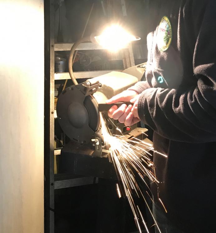

I found a piece of steel in my grandfathers basement, I’m currently making a file knife for my father and compared the sparks of the file and mystery steel and it appears it could be close to 1045 from some charts I’ve seen, could I get a second opinion on wether to use it for a knife or not? I’ve never tried spark testing so I could be completely wrong here
