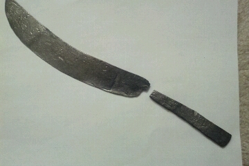

This past weekend I made my first attempt making a knife using O-1 tool steel. I started out with flat stock and using a Whisper Momma propane forge got it into the shape I wanted. I was not ready to oil quench it quite yet, so I let the blade air cool. After 30-45 minutes, it was cool enough for me to handle and, wanting to see how it looked cleaned up a bit, started to clean it with an angle grinder with a wire brush attachment. I had the tang of the knife in an vise and was applying some pressure when the knife snapped.

Before doing anything work to the steel upon finishing, should I have tempered it? Besides breaking it, is there something I should have done? A friend of mine made a blade at the same time and is worried to do anything else to it.
Any thoughts?
Remember that most of the quenching information is based on a 1" thick section. Knife thicknesses often will quench one or two steps differently. So it's possible that your piece actually hardened and then you were working untempered and so broke.
How was it being supported during "Air Cooling"? What was the ambient temperature of your shop? Still air or was there a breeze?
Why not test your friend's (and your) blade with a file to see if it has hardened?
Did you do much hammering on the steel below a bright red heat? If you hammer on steel much after it has cooled you can caused stress. I have had a tool of two break from hammer to cold. It can be tempting to just hammer those few more times after it has gone to a black heat.

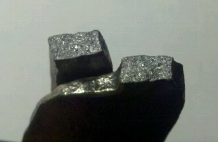

The grain at the break seems coarse to me. Perhaps it was overheated and did not normalize. As Thomas said, thin sections will get quite hard with a chill - in fact, if you laid it on a heat sink like a cold anvil or table, it would equate to a very fast quench.

The grain in the broken blade is massive. Normalise a time or two before the heat to quench. There are more forgiving steels out there!
