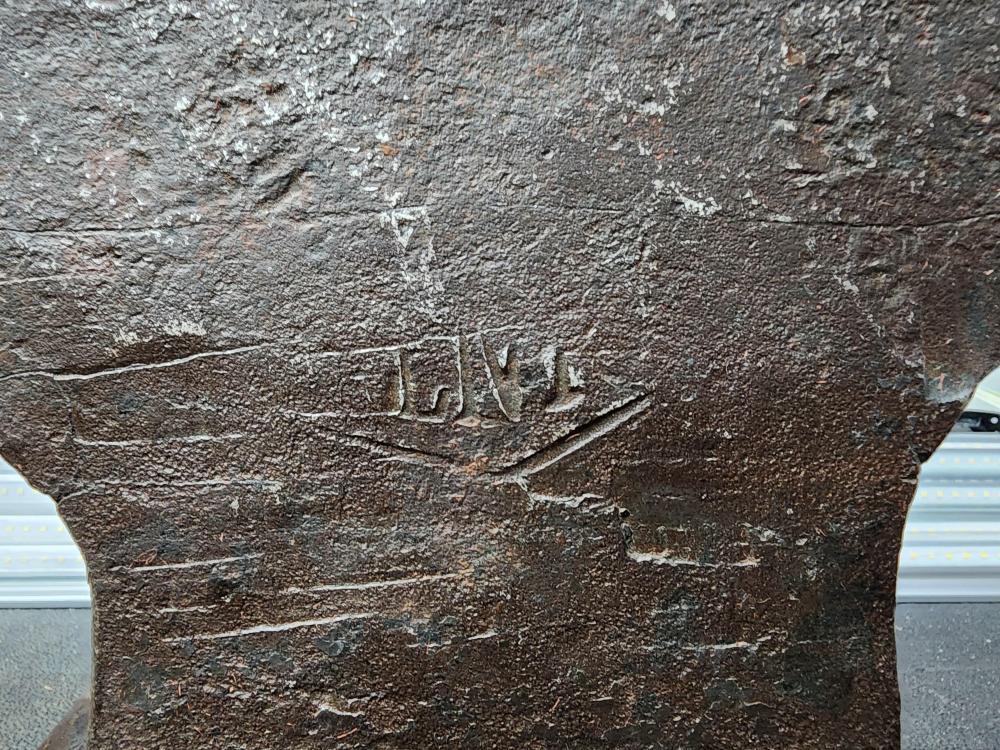

Cbennett0811 Posted January 30, 2010 Author Share Posted January 30, 2010 Ive found an anvil on ebay. its fairly close. does anyone know what kind it is or if its a good one?http://cgi.ebay.com/ANTIQUE-ANVIL_W0QQitemZ180462235707QQcmdZViewItemQQptZLH_DefaultDomain_0?hash=item2a0463303b#ht_500wt_1182 thanks. Quote Link to comment Share on other sites More sharing options...
Cbennett0811 Posted January 30, 2010 Author Share Posted January 30, 2010 wait.. heres a pic Quote Link to comment Share on other sites More sharing options...
Cbennett0811 Posted January 30, 2010 Author Share Posted January 30, 2010 here it iseBayISAPI.dll.htm Quote Link to comment Share on other sites More sharing options...
Cbennett0811 Posted January 30, 2010 Author Share Posted January 30, 2010 ahhh. cant get picture to show. maybe this will work.. sorry bout that Quote Link to comment Share on other sites More sharing options...
kgblacksmith Posted January 30, 2010 Share Posted January 30, 2010 ahhh. cant get picture to show. maybe this will work.. sorry bout that Nice anvil! Looks like a Hay-Budden, but I can't be sure. How much does it weigh, and how much does it cost? Usually Ebay is not the greatest place to get blacksmith's tools- too much money, too much junk. Quote Link to comment Share on other sites More sharing options...
kgblacksmith Posted January 30, 2010 Share Posted January 30, 2010 Nice anvil! Looks like a Hay-Budden, but I can't be sure. How much does it weigh, and how much does it cost? Usually Ebay is not the greatest place to get blacksmith's tools- too much money, too much junk. Took a closer look at the side of the anvil, and it looks like the remains of a "Trenton" brand stamp. Either way, the anvil looks to be in good shape. Quote Link to comment Share on other sites More sharing options...
Jack Evers Posted January 30, 2010 Share Posted January 30, 2010 Took a closer look at the side of the anvil, and it looks like the remains of a "Trenton" brand stamp. Either way, the anvil looks to be in good shape. I got the EBAY SITE to open by copying and pasteing to my browser. Seller doesn't seem to know a lot - says there's a round hole and a square hole in it. Gives dimensions and says it weighs about 117 pounds. Seems right for the dimensions. Stand and hardy tool included. There's a second picture from the top. Edges a bit chewed toward the horn end but not bad. Someone back east needs to comment on prices, but I'd say $2 to $3 a pound wouldn't be all that bad. Presently a $65 bid. Won't ship, must be picked up on site. That should eliminate a bunch of potential buyers. Quote Link to comment Share on other sites More sharing options...
Cbennett0811 Posted January 31, 2010 Author Share Posted January 31, 2010 Yeah. hopefully ithe price doesnt clime too much. thanks everyone. Is it all steel? or do you think it is iron with a steel face? Quote Link to comment Share on other sites More sharing options...
ThomasPowers Posted February 1, 2010 Share Posted February 1, 2010 Wrought iron or mild steel with a forge welded high carbon steel face. *not* cast iron with a steel face like a Fisher or vulcan. Gotta watch the jargon! Quote Link to comment Share on other sites More sharing options...
