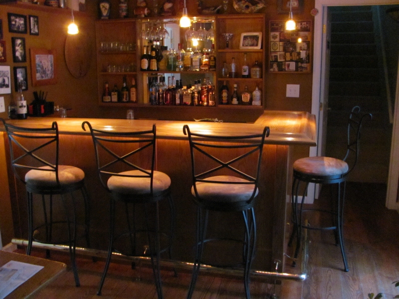

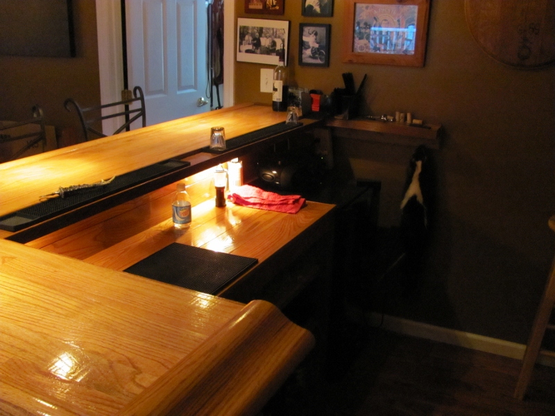

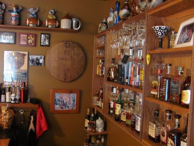

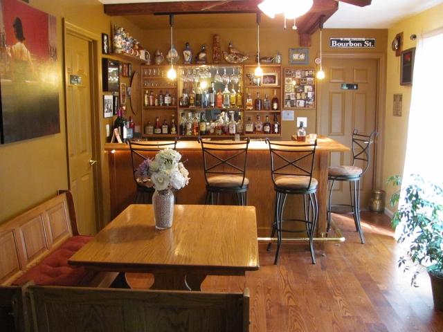

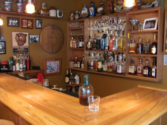

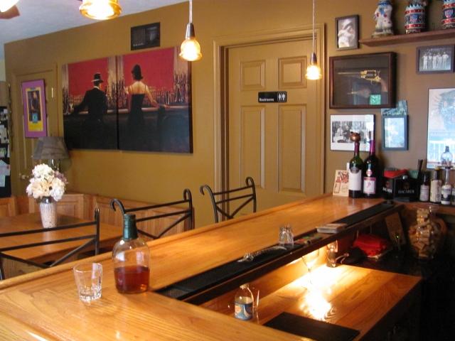

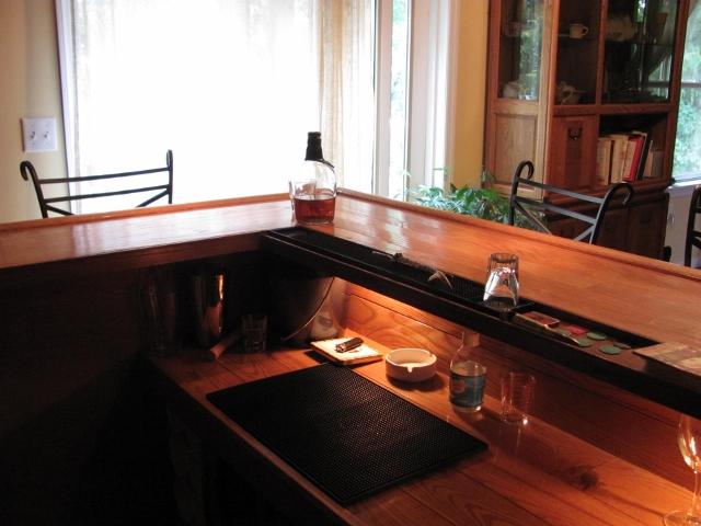

  5. Well, I'm back after quite an absence. I just finished installing a coal forge in my new work shop.The first since I moved from the farm in Illinois to here in West Virginia. I hope to get started working again soon. The move, having to build a shop building, rehab from a broken shoulder, and carpenter work around the house kept the blacksmith work on the back burner. Some of the carpenter work was really enjoyable.....you should see the home bar I built and installed.
