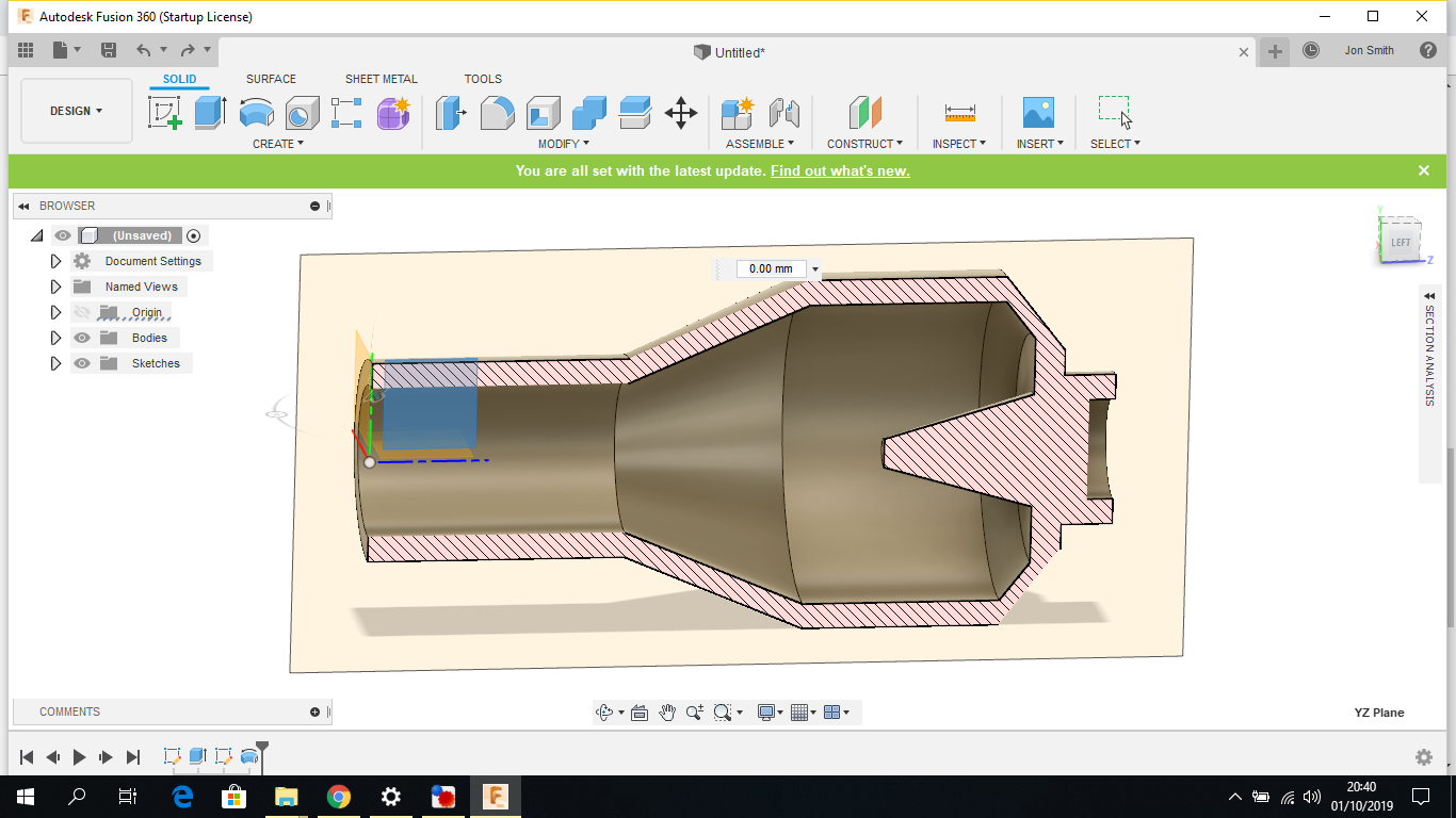

sorry words are not my strong point. by nozzle i mean the orifice/jet. the injector tube is simply the brass tube with the jet on the end. perhaps this sketch will explain better? basically just cast the below in one piece (with air slots), the back end gets drilled through and then just tap M6 for a 3d printer nozzle ( orifice)- 863 replies

again im sorry i misunderstood and thought you were testing on a linear burner. i do however wonder if the injector tube couldn't also be cast along with the inlet chamber? would just need drilling out and tapping for the nozzle to fit directly. of course the perfect nozzle position would need to be ascertained but it might be an idea worth considering? just imagining a single piece cast inlet chamber with a removable nozzle for maintenance/upgrading, all you would need is to add a mixing tube and it would be ready to run.- 863 replies
