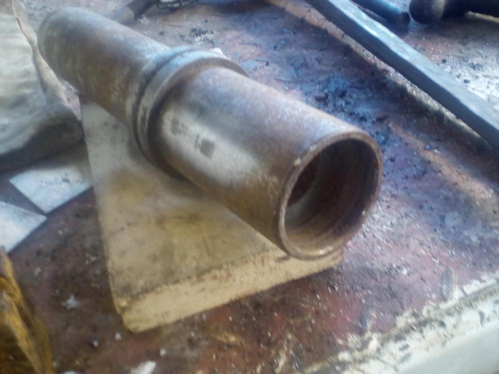

  9. For what it's worth the piece I'm using came off the far end, around a metre long, slightly thinner wall tapering to knife edge from erosion from working, you can just make out the reducing step down on the far end.
  10. Pic attached, the collar has 1 o ring external, with 2 o rings internal at the end we are looking at. The material softened enough for machinability I think, I drilled a couple of 3/16" holes easily enough, but you could feel the bit working when drilling dry, but a file makes little impression, my annealing attempts so far have been solely heating to non mag, and either in vermiculite cooling, or in forge cooling with opening blocked with fire bricks, no other tempering etc, appreciate your input Frosty. I got this stuff a while back to make some wood lathe tooling, before I'd made a forge or manufactured an anvil/ hitting block. I initially split the tube with a grinder, then using oxy/ acet, tried to flatten it, even with a large heating tip, I couldn't get a large enough area hot enough to hammer it flat,, [ask my shoulder], so it went on the back burner till I got my forge up and running, then it flattened easily enough.
  11. I followed the advice given and chased up some info, got some good help, but the guy from the actual supplier never rang back, but , what I have seems to be a hammer adapter inner tube, and generally they seem to be made of 1040, so my annealling methods should of worked if I got my temps right, I might use this stock for something else as what I planned to do needed a knife like edge, and it seems 1040 is not the best edge keeper.
  12. Will do, Arkie, still dark here ATM,if I get any good info, I'll post it.
  13. Well I went back and tried again, basically repeating what I,d already tried, but playing closer attention to [estimated] temperatures, almost identical results, the heat then forge cooling is marginally softer than the cooled in vermiculite method, and can be drilled ok with care,[ only small diameter so far, 3/16:], but it is still very hard to file and do other similar things. All the info I've read seems to indicate I need better temp monitoring and control, and there is not a lot of detailed info on annealing 4130 in a simple home forge set up.If I've missed something and someone can point it out, I'd appreciate it. The job is doable as is, but a LOT harder and more power tools.
  14. Thanks Arkie and Frosty, I think you nailed it between you, the tube is used for drilling the type of jobs Frosty mentioned, and the collar is a double ring push fit by the look of it, and very hard, the finish is almost chrome like, except for the heavily eroded ends, I'll check out 4130 treatment and see if I can do a workaround that way, thanks.
  15. arkie, I suspect you are right, most probably drill tube, about 3" o.d., about 4mm wall thickness, probably thicker before wear, as the tube got very thin towards the end where most erosion had happened, so probably started as 1/4" or 6.5 mm thick, for that thickness it was a bit tough to cut, and I initially tried to flatten it with oxy/ acet, and that was tough going trying to break it's back, but not so bad in the forge where I could get a better spread of heat.
  16. Thanks Irondragon, that is helpfull, but it doesn't quite identify my stuff, those charts seem to be for actual rod, whereas my stuff is actually drill pipe, which is called drill rod here, and the indentifiers don't apply, but it has narrowed down my search a bit.
