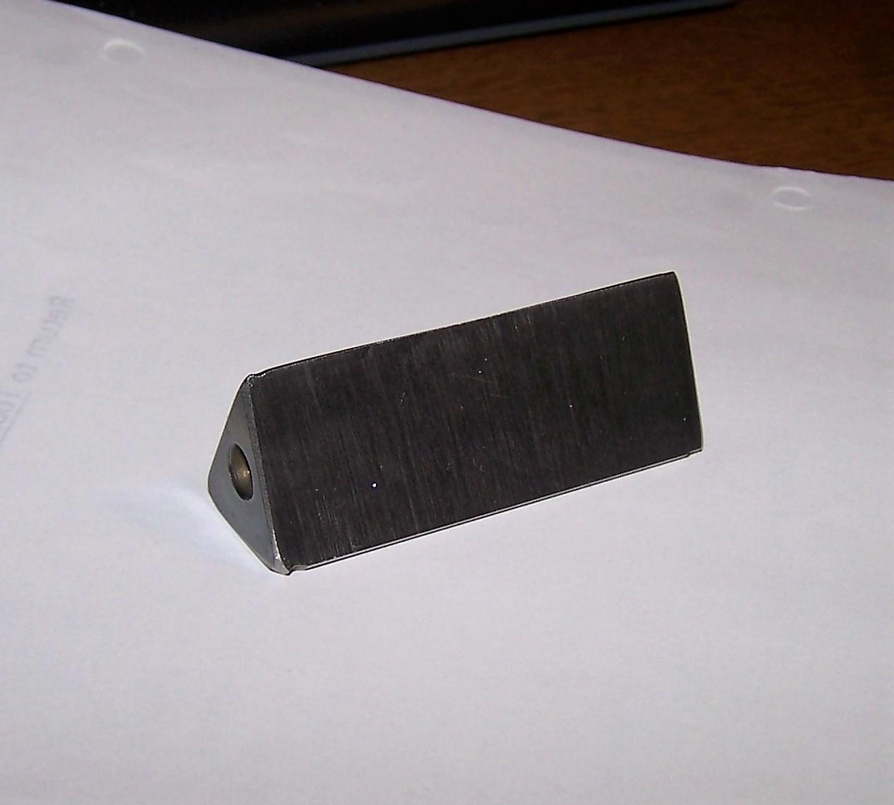

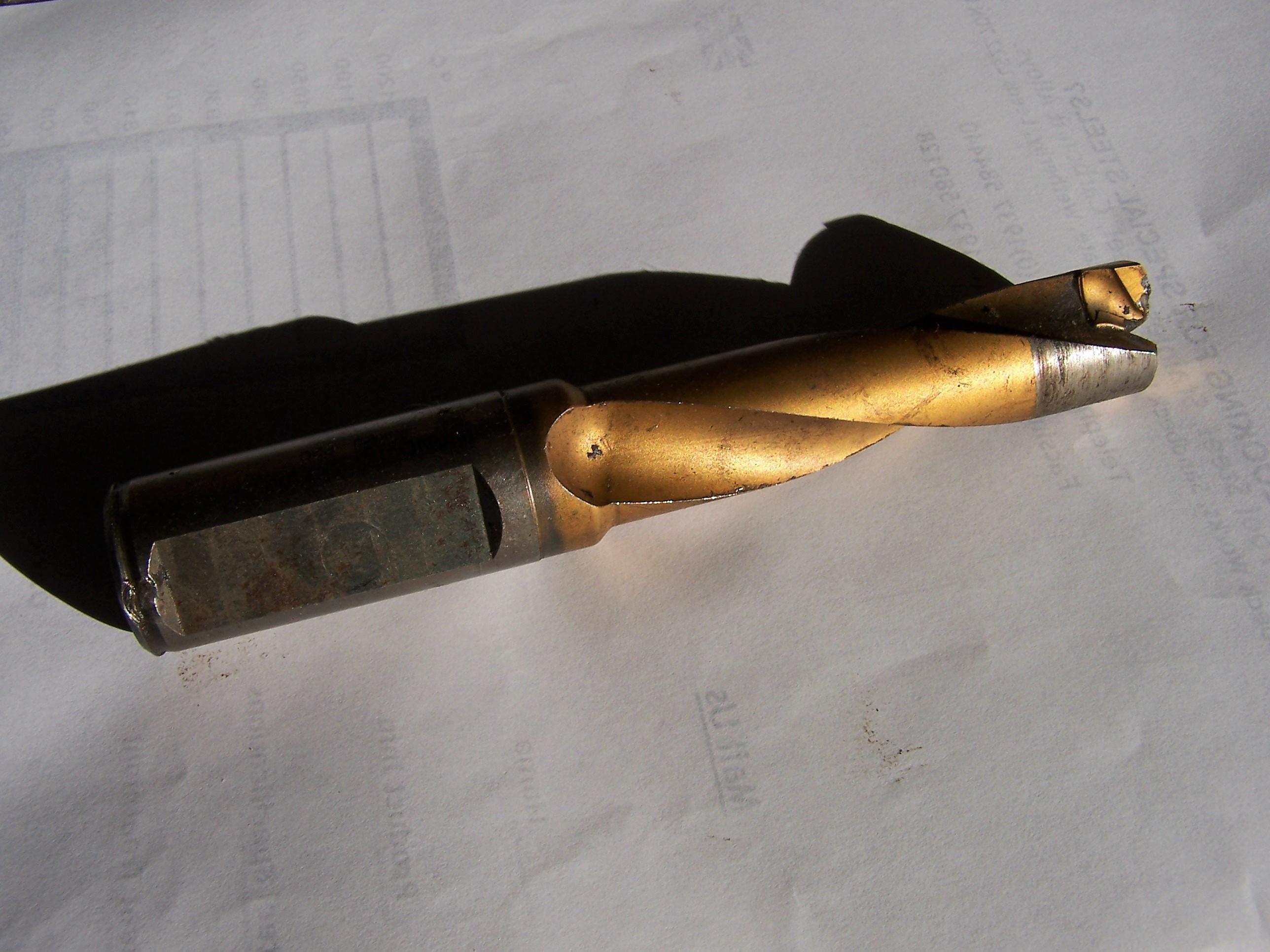

  7. I put the carbide cutter shaft into the fire to see what happens and it is the weirdest steel I have ever used. I thought that it would crumble apart but discovered that it is forgeable but moves slowly. I tried to harden it with oil and then water and it will not harden. Therefore it has a low carbon content but I suspect a high alloy content which makes it very tough. I tried the anvil devil (thank you for the proper name) and it worked adequately but being low carbon it will not stand up to the abuse for very long. My conclusion is that this is not a great steel to work with. It makes a great carbide holder but is not worth the effort of forging. The only redeeming quality is that it is high heat resistant but stay with H13 if you want a high heat steel. Yes, I have a Rockwell tester that I bought cheaply off of a local buy and sell website. It is an old machine that was owned by the Canadian Government and it consistently reads about 3 points low according to my test disk. It is not suitable for a machine shop but it is close enough for smithing.
  8. I made a pocket hot cutter out of the carbide cutter shank with stock removal which should keep the original hardness. I tested the hardness before starting and it was around 47 Rockwell C. The spark test while showed very little spark much like cast iron. Therefore I will suggest that it is ductile iron. For fairly hard material it is surprisingly soft to grind. I have not yet tried it as a hot cutter to see how it stands up to hitting.
  9. I was wondering what kind of steel is used in the shaft of carbide cutting tools. It certainly needs to be hard and tough but not necessarily high speed steel. Ultimately the question is whether it is worth throwing in the forge and shaping into something.
