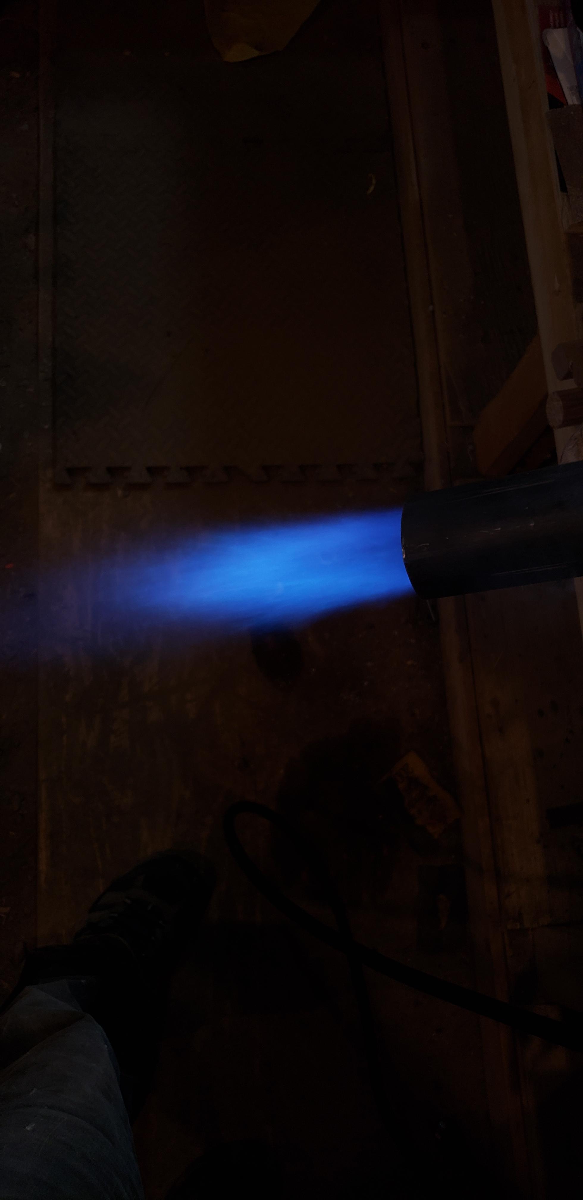

  1. This is the section I grabbed that numbered flame from. I'm not saying anyone's wrong but I was thrown off by this as it seemed backwards. My main goal despite names and numbers while testing was to try and have the primary and secondary area kinda blur together so I didn't have the bright lightblue and less of that tertiary flame without getting purple. Ill take some more pics today with the different mixing tube lengths and lable them better as I'm obviously struggling with reading them. https://www.iforgeiron.com/profile/74859-another-frankenburner/ I'm not a huge tube guy. If I upload a video for private only and share it here will it be visable or do I have to upload it for public? Iron dragon I'm not a huge youtube guy. If I upload a video for private only and share it here will it be visable or do I have to upload it for public?

  4. I hyper focused on trying to get those two "zones" to kinda blur as I was tinkering. I wrote notes but didn't lable the pictures while I was testing shorter tubes, doh. I did notice like you say the shorter bushier flames but I had to move the choke quite a bit throughout the psi range to keep the flame looking decent. I have the notes regarding the different length mixing tubes and nozzle over hang. So when I get it in the forge I'll have a starting point. These two sets of pictures are with the 8" the first set is 035 no choke adjustment the second is 030 with choke almost closed at the beginning and finishing wide open.

  10. Thank you. No hint of green flame with this set up. I know it's not in the forge but the 1.5 over hang with the nozzle seems to be the sweet spot it is the only position that I found held stable. It literally goes from 1-30psi and stays that clear blue. When I tried a flared 1" alone I got the greeny soft blue colour. I'm going to grab another 3/4" nipple and try a shorter mixing tube. Shorter means faster and longer means smoother flame right? I've been jumping back and forth through the first dozen pages for the last couple days trying and I keep forgetting which page I read what. I get lost on the first second and third flame. Is this the different flames? Or do I have just one and two in this pic?

  13. Hello all. My name is Trevor, I'm from east kootenay's BC Canada. I'm kinda jumping in here I hope it's ok. I want to thank all who have contributed to this thread. I haven't read in full past 2016 yet but I have used that info to come up with this and think I've got it diald in pretty good and I'm kinda hoping for confirmation/advice.(Hopefully it may kinda count as contribution too) 2"-3/4" bell, 3/4"/8" mixing tube, 1"spacer, 1 1/4" nozzle (apx 1 3/8" I'd at opening) 1 1/2" overhang, 1/8"brass T, 0.035 tweeco apx3/8" above throat. First pic is around 12psi the next 3 are 1, 15, 30psi it holds steady the whole way through. I think this is a neutral flame , it has a faint hint of propane coming off the flame itself though but I think Mikey mentioned somewhere that's a good burn...? The flame doesn't get much longer through out the range but does get louder and alot hotter. It'll be going in this forge once my insulation arrives. (I'll try and make a thread for the whole build once I'm done.) Anyway thank you all for the info so far, I look forward to catching up on thiswhole thread. span widgepan widget
