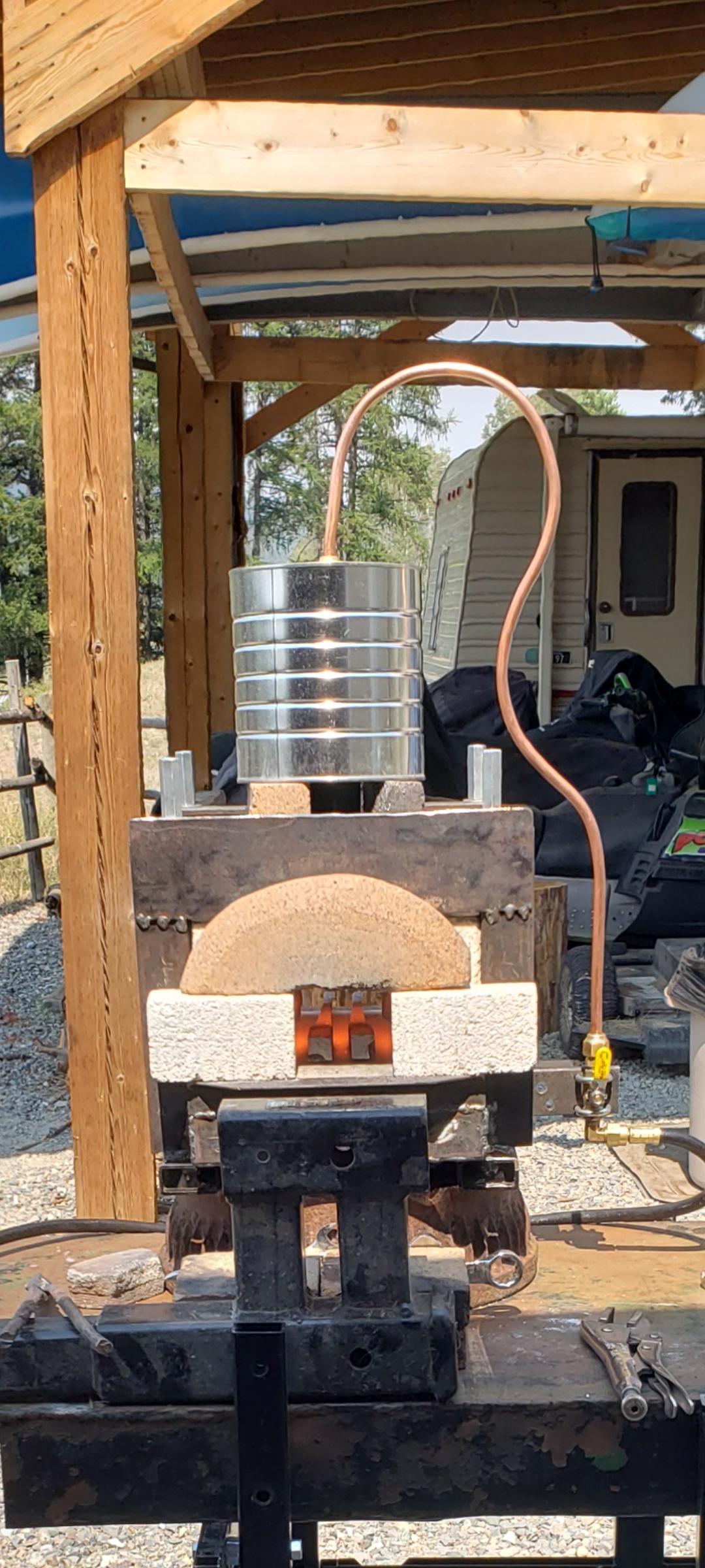

  2. 1/2" T burner, hole in the bottom of an all tin coffee tin

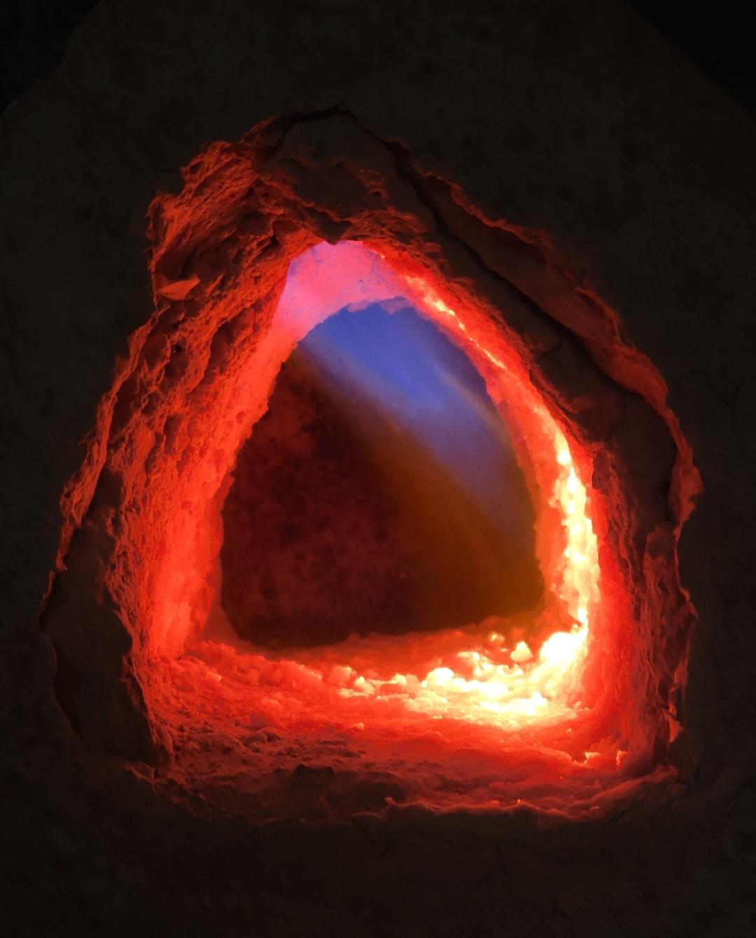

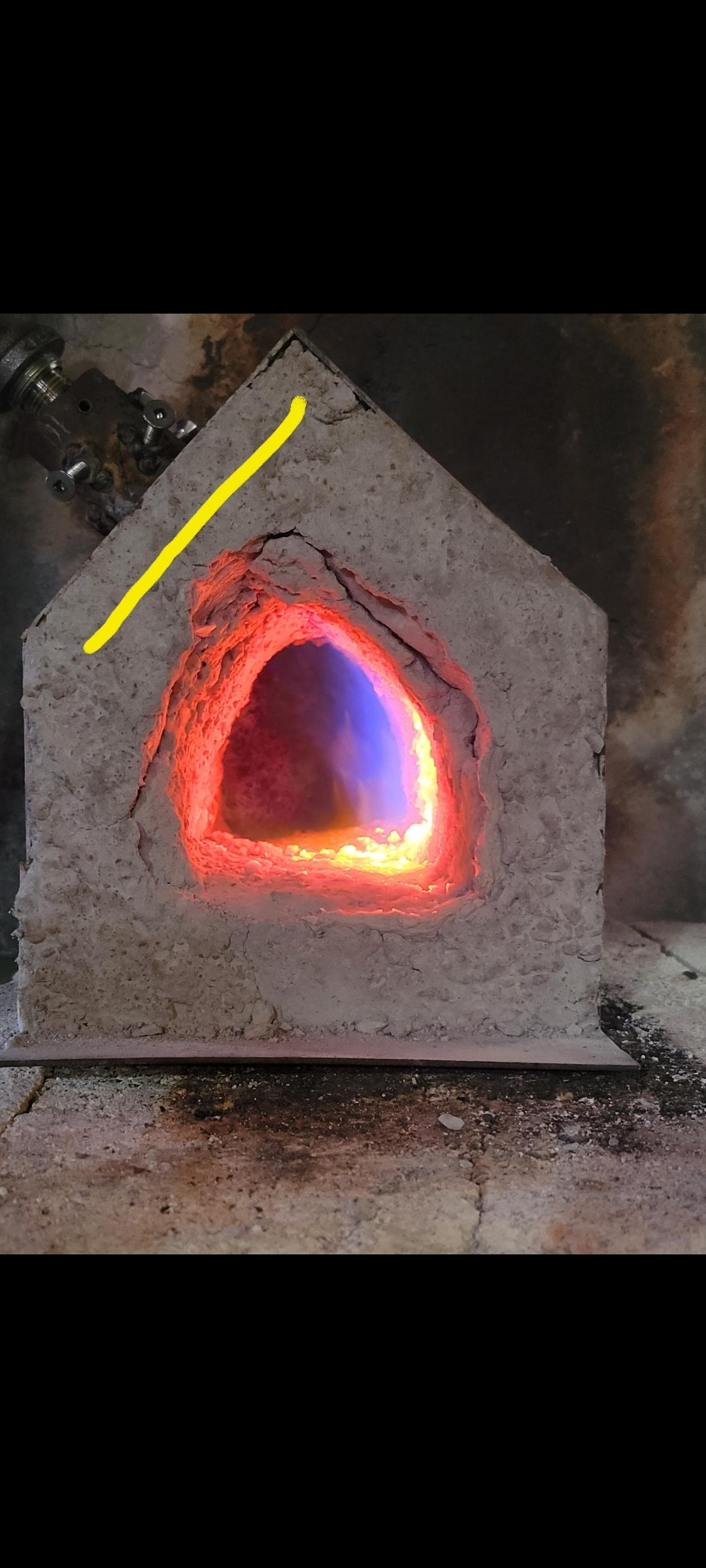

  3. The only thing I didn't agree with is whether or not the burner was inside the forge or liner. It's not arguing or dismissing its explaining. The dang picture was taken from an upward angle, and its obvious the burner is inside a hole/port. I'll read the information shared here but I'm not going to spend three days explain a picture. Maybe it was when I said 1/3rd into the forge..... I meant front to back not 1/3rd into the forge. All these pics are the burner at the same depth. OK the insulation along the back wall is about 1 1/2", peak is 2" maybe 2 1/2", the wall opposing the burner is close to 2" the floor is 2" There's give or take 3/8" castable and then there will be an IR top coat. The burner sits inside the port in the insulating a scooch, it's too small to get a good look or to even feel the depth so I have to judge by how the flame is igniting. I set the depth while watching the balance and yes I try really hard to have the flame light just inside the port in the insulation/refractory. Everything that I've learned here I've used, Mike has talked at length about using the nozzle to superheat the gasses before they enter the forge... I believe that concept is repeated on Chili's website.....I use the port in the insulation for this not my nozzle, my nozzles stay black, maybe a lick of red maybe but that's it and at the end of the day. Yes Mike a Frosty are on repeat, it's too bad, my forge isn't actually 1" thick, the nozzle isn't inside the forge and I don't know what else to say, I don't know but here's a couple more pics, if the forge still needs a LOT of work then that's great it's a heck of a lot close than it was when it was dropped off. I will stop replying to these threads and just read, this is ridiculous. Here's what a burner inside a forge looks like, this is what was brought to me.
  4. Seriously I'm not trying to argue, I only corrected the fact the burner wasn't I side the forge. I'm going to stop joining in, I am exhausted with the misunderstandings every time I try to reply.

  7. I have the nozzle set to a depth where the lip of the nozzle may get red but no further back..... I pride myself on the flame originating from a black hole..... I try to balance the over hang and increase in diameter with the port in the insulation/refractory ie liner so the flame starts between the lip if the nozzle and lip of the port though the refractory. This forge body was quite small so on the walks the insulation is only 1"-1 1/2" thick so 3/4" UP into the liner is closer to the 1/4" down or 1/4" INTO the liner. I'm not arguing just trying to describe what my eye is seeing vs what the image shows.... I'll see if I can find pics of other hot port shots (that's 'pg' right)
  8. Hmm it's definitely an angle perspective thing. The nozzle overhang is 1/2" past the end of the mixing tube and the nozzle tip is about 1/2-3/4 inch up into the port once at heat the flame sits in the 1/2" between nozzle and forge interior. The blue lines are the wall of the burner port. The refractory broke up as I was refining the ports and reefing the burner about... It is allready patched and waiting for the next step
