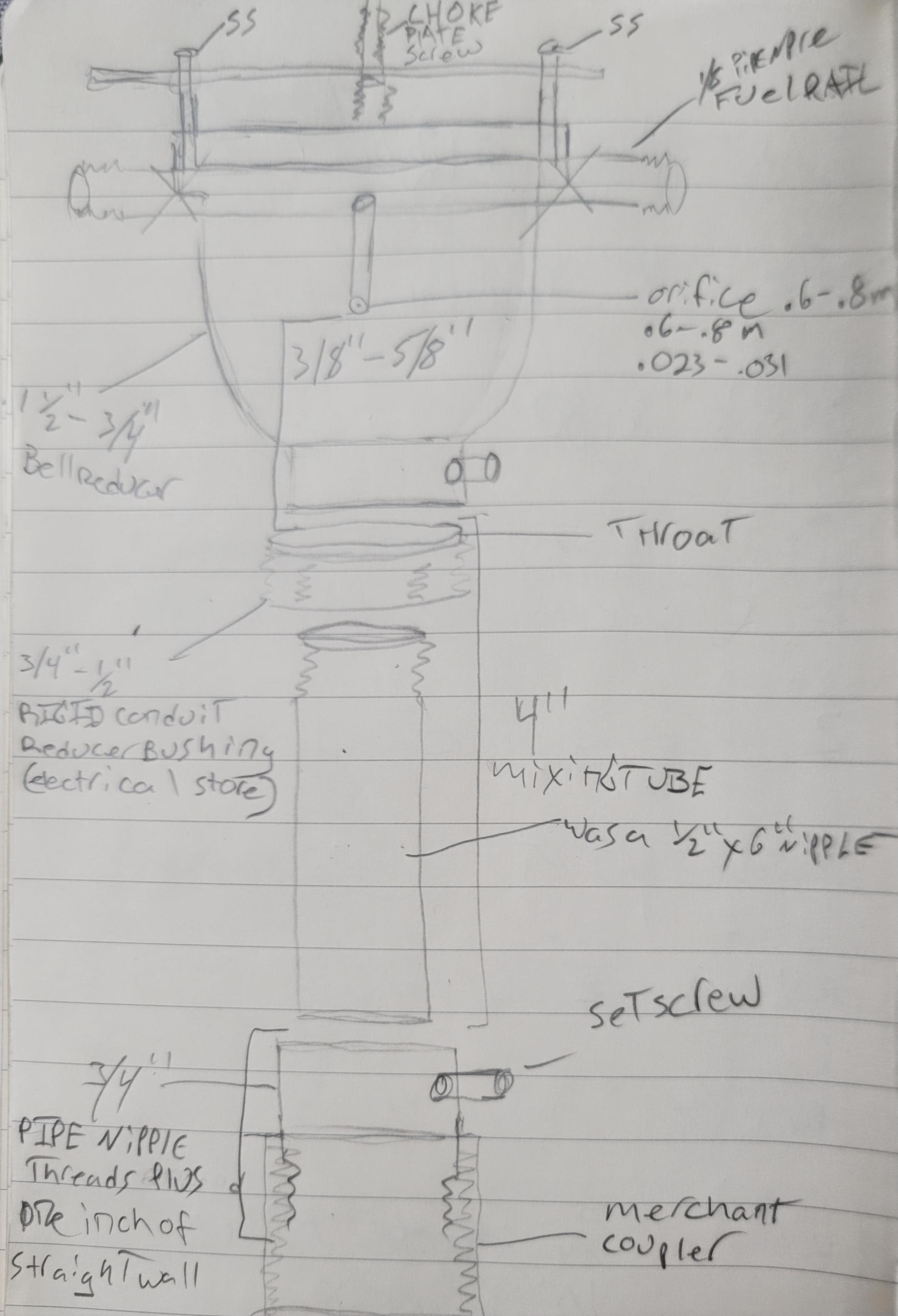

  1. The burners in this last forge arr different burners all together, they are designed as 3/4" burners and arr still in testing as well.
  2. Robert geez 8yrs so young, I'm sorry for you loss Mike, you are so right they do love summer! I may be missing something in my description or I labeled the diagram incorrectly I'm thinking...... There is no lamp rod, the threaded rod at the top of the sketch is jut there to hold the choke plate, what I am calling the fuel rail is still the classic 1/8" nipple that mounts in the opening of the intake horizontally. Made sure they were dead straight then tac welded in place after using jbweld to seal the mig contact tip in place. So downside the fuel delivery is locked in place, upside the fuel deliver is locked..... The only thing I can adjust is the depth of the bushing "throat". I am happy with the alignment of the jets in these two but if the 0.8mm flows too much fuel for the half inch pipes I'm kind of limited on options for adjustments. If I swap out the half inch nipple / bushing for a 6"x3/4" it should mix a bit better and reduce that dragon breathe. (the last pic that is really nice is a burner like these but using the. 0.023.... The pic of the forge with heavy dragon breathe is using burners that have the 0.8mm tip) If it seems like I am jumping burner to burner it is because I have a couple on the go, I have a couple made with the 0.023 and a couple with the 0.8mm tips (kind of screw up's). I also have two more micro burners on the go etc..... Jery, what you say about the choke is one of those tid bits I really utilize! With choke: build for lean and speed and choke to get neutral No choke...... Build it right and tune it to the forge. (kind of thing) I'm hoping to get to the shop in a few days and will try out a few things like plunk the 0.8mm burners into my larger "300CI minion forge" and try the micro burners in 150ci forge above. Oh geez Thomas at least your preciois was with ones that loved her and not a stranger. Oh man I feel bad for the other guy they just don't understand...... Maybe this shows how the choke plate and fuel rail are mounted in these burners Here's the minion forge, well the beginning of one. I need to embellish around the eyes, maybe make them look like binoculars.

  5. I doubt you'll be able to read this but maybe maybe you can...
  6. Maybe an easier way to say it would be: Screw the 1/2"x6" pipe nipple into the rigid conduit reducer bushing, then measure from the end/top of the bushing down 4" and cut off nice and smooth. The bushing and the pipe nipple together should be consider "mixing tube". So if you separate the two your pipe nipple will be less than 4" by a scooch. The top side of the bushing is the throat.... The measurement from the tip of the contact tip to the throat on mine is 1/2". Oh another addition.... At the base of the bell reducer I drilled and tapped for a set screw, now you can adjust the mixing tube/throat up and down about 3/8"-1/2"and tighten the screw against the outside of the bushing. I'm going to try and sketch something up because I'm kurfufelingmy my thoughts.
  7. The last pic is with the two 1/2" burner's and there is just too much flame with two of these especially with the 0.8mm instead of the 0.023 I had in originaly. I may go back to the 0.023 depending on the forge they are going into. This double burner forge will be getting two of my micro burners hopefully in the next week here. The school house forge has the 0.023 (0.6mm) orifice .
  8. This is the conduit reducer bushing, note the rolled edge where the throat would be. The tip of the contact tip is 1/2" from the initial rolled edge of the bushing, so 1/2" from orifice to throat/narrowest part. This is with on 1/2 " burner
  9. Here's my latest twist on Ron's classic EZ burner..... 1/8"x 4" sch 80 pipe nipple 0.8mm mig contact tip 1/8" pipe cap 1 1/2" - 3/4" bell reducer 3/4" - 1/2" "rigid conduit reducer bushing" 1/2" X 6" (measure 4" including 1 threaded end and discard the rest The nozzle is a piece of 3/4" tac welded to a 3/4" merchant coupler ie straight thread with a little set screw I run my 1/8" nipple/fuel rail through bell centered at the bottom of the exterior lip with a set screw on either side to secure the fuel rail. I drill and tap the fuel rail to take the mig tip. I trim some threads off the mig tip and then trim enough off the tip so you can just spin it around inside the opening. The graphite refill is a 0.7mm so if you bump it one way than the other you can zero in on straight, I don't have water in my shop to do the water jet test but this seems to get me close. One you've confirmed your jet is straight, centered, sealed etc then hit it with a tac weld or just rely on the set screw. A choke plate can be added by drilling and tapping a strip of 3/8" flat bar, utilize the set screws and holes to secure the flat bar then turn down the center bolt and it'll lock against the fuel rail and help secure it if you didn't tac weld it. Pictures lots of pictures coming really soon.

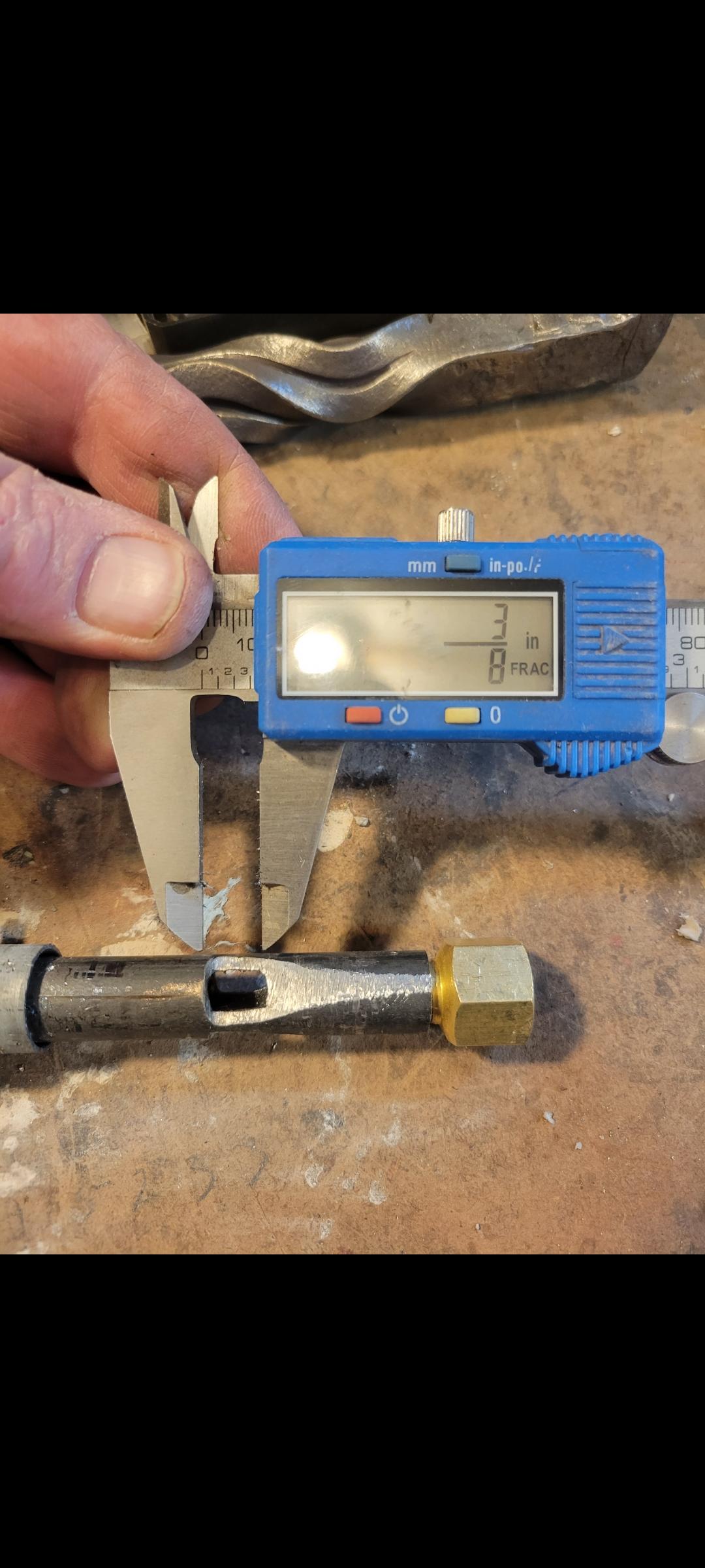

  15. When it comes to 1/4" micro burners and options for tapping thing I'll add that one can tap a 1/4" schedule 40 nipple to accept the 1/8"npt threads. If one takes the ACTUAL ID of the pipe nipple the sizes are way out to lunch! Inside of the quarter inch is like 3/8" inside the 3/8" is 1/2" id etc I want to order some larger pipe taps.... To make a 3/8" pocket rocket I will tap the 3/8" nipple with the 1/4" pipe tap then tap up into the bottom of that 1/4" fitting (say a 1/4"npt - to 3/8"flare) to accept a piece of 1/8" sch 80 piple nipple (trim the last but of straight and the threads off a piece of sch80) to accept the mig contact tip or the 3d printer nizzle. I guess you could use a bushing but you'd want to file down the points on the nut portion of the bushing. Ughh sounds exhausting but really it's just 3 taps, trim the 1/8 and cut out intake ports. Tap the 3/8" sch 40 nipple, Tap the 1/4" mnpt to 3/8" flare or something then Tap a piece of 1/8"sch80

  17. Oh oh oh let me join... Not tools yet but I'm sure I can do something with the axle and tierods. I don't know about this big ring.... I bought it for flat stock but it kind of tares apart if you hammer it cold..... Oh well might as well scrap it (joking) That's the ring
  18. No not at all, this is a fun twist for sure a tease but fun. Aside from this super fact maging is there a free or low cost program or app that let's you simulate fluid flow? I've wanted to play with angles to see how it effects swirls and stuff.
  19. Dimensions I'm working with right now are from tip of jet/orifice to forward edge of air intakes is 1" the 3 air slot are measured back from there 3/8" and material removed to expose 3 equal openings that are 1/4"X3/8" with corners and edges filed crisp and square. The mixing tube ie forward edge of intake to the end of burner will be somewhere between 2" & 2 1/2" depending on application Nozzle is as above, a piece of 3/8" nipple reamed out and threaded into the coupler with a set screw or three. So far a choke is needed with the current dimension and distance of jet from intakes The choke is just a little piece of 3/8" reemed out with a set screw. I do think I will be shortening the distance between the jet/orifice tip to forward edge of air intakes. I will upload photos as I get them resized and orginized.... I also filmed myself making a burner tube beginning to end that I have to edit. Maybe tonight maybe a few days but not now, I got to go eat something now.
