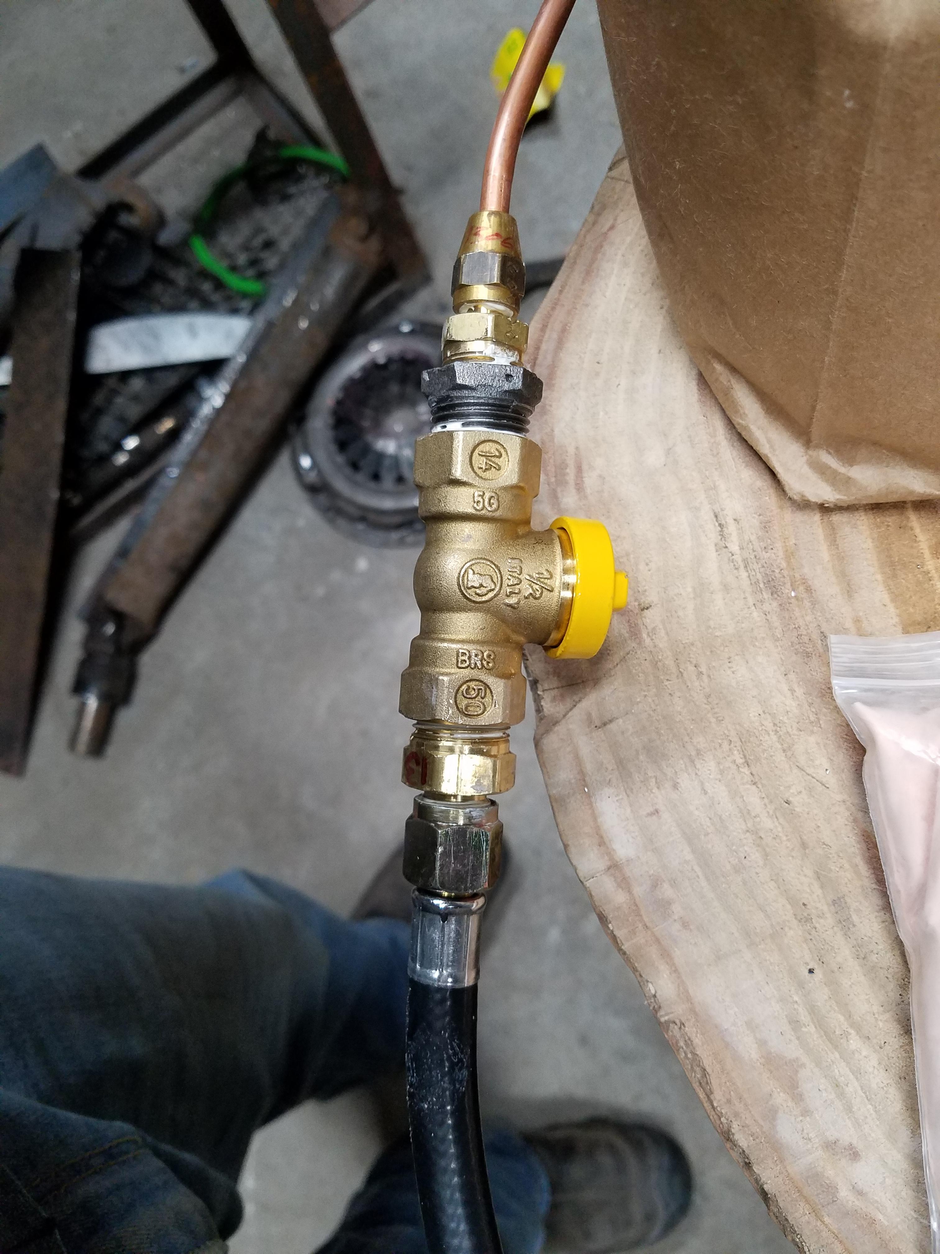

    I don't know if I can delete my previous comment or if someone could delete it for me but it should be tweeco 14 series tips have the correct pitch. Pipe goo I can get, however I also looked at the tweeco website and evidently the tips I bought come with a m6x1 pattern which would explain the bad fit. in my case I think its cheaper to go re buy the right part instead of buying a different tap to fix the problem. tweeco 11 series has the m6x1.0 pitch I bought these because they are shorter and should have had less cutting tweeco 14 series has 1/4x28 these are longer but have the pitch called for in the directions I will probably just eyeball my angles for drilling the hole in the tee maybe get a better holesaw

    I just realized that I didn't include the pictures also the mig tip wiggles in the nozzle till it hits the shoulder is that normal?
  23. Mellin replied to Mellin's topic in Gas Forges
    I messed up when trying to drill the hole in the tee so the mig tip is off center. I will go pick up a new tee tomorrow. I went to every single commercial and farm supply and none had high pressure regulators with gauges so I ordered one and a quart of fumed silica. While typing this I also remember that I wanted a 1 inch ball bearing so I will order that too. I also took my die grinder to one of the cast iron 1 inch to 3/4 reducers and totally smoothed the outside but left the threads inside the flare. It is now small enough to fit through the floor and pipe burner mount I have. My next build will either be an 18 gauge d shaped 2 burner or I can use my old air tank.
