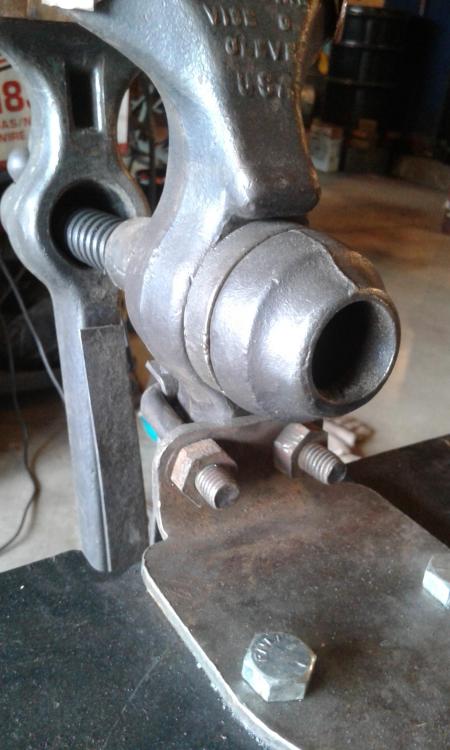

I've had this vise for a little over a year now and I have tried to find some info on it, with no luck. It has 4" jaws, weighs 35 pounds, and was obviously made by the columbian vise co. For the past while now I've been trying to figure out how it was made. It has raised letters and numbers which seems to imply casting, but i cant find porosity anywhere which seems to be common with casting. Were these vises drop forged? Any other info such as when it was possibly made would be appreciated. Thanks.

That vise in the top 3 photos is awesome, looks like all original parts, great job. Pretty much finished with the mounting bracket, all I have to do is drill some holes for the bolts. I went for the simplest design I could think of. Its a simple u-bolt I bent and threaded out of 5/8 round bar, and a big piece of angle iron (that i might shape with a grinder so it's a bit more pleasing to the eye). Seems like It will be pretty solid. I got the design from my 4" Colombian leg vise in the bottom photo.
