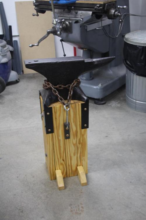

  1. I may not be 'well on my way' ... but I am 'on my way' I picked up the Anvil and then made a stand for it. The stand is made from clear 2x10 glued and bolted together. I took some angle iron pieces to bolt on to keep it on the top. That - by itself - quieted it down quite a bit. Then with two lengths of chain one around one side and the other from the other side and eye bolts to pull the anvil down tight to the base. It's quiet and tight. Then .... I picked up a set of 'starter tongs'. They are rough-cut and probably 50 to 75% done ... the reins need drawn out and rounded and the jaws need finished then riveted ... but they are a good start. Now - I need a way to heat up the working stock. I have an oxy-acetylene set-up with a cutting torch head ... but that can get expensive ... so I am considering a brake drum forge for now ... I have a brake drum and a piece of pipe ... and I have an old hair dryer ... so I can probably complete pretty cheaply. I may want a gas forge at some time.

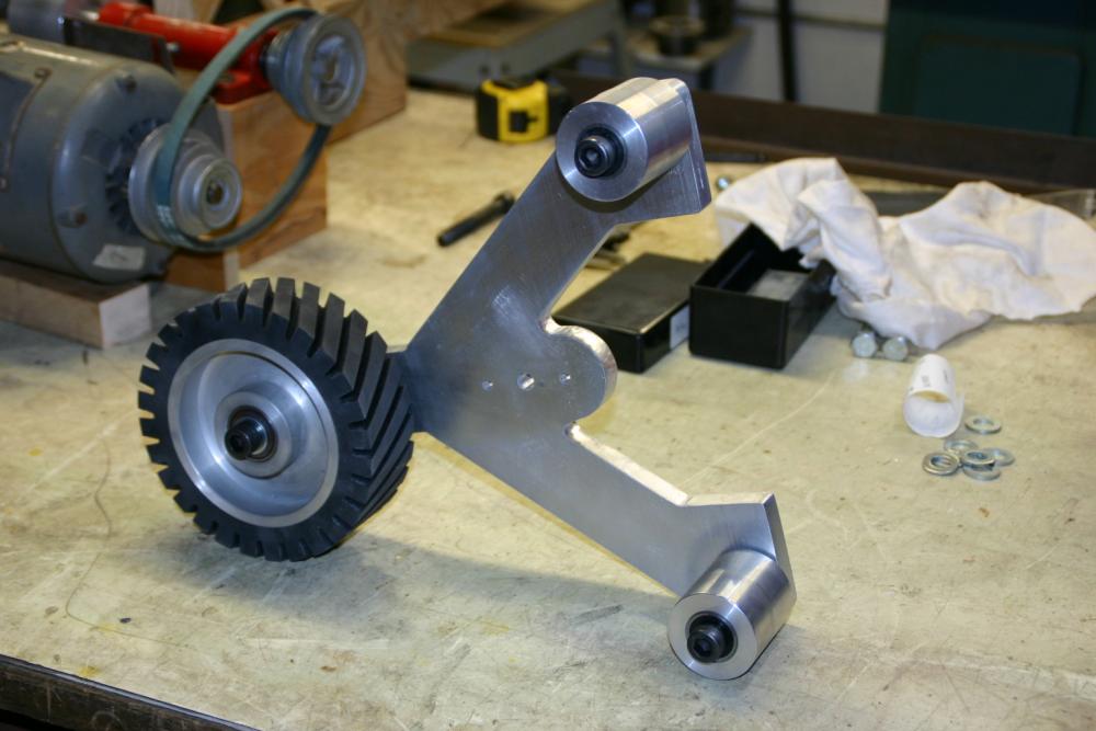

  7. Thank you both! One choice I made early on, I could have had the machine 'low' and 'long' like it is ... or I could have brought the motor toward me, and raised the idler ... I don't know which is a better design - but my 'low' one, coupled with the rotating front, causes me to remove the angle aluminum 'backing plate' of the platen. So if you do one, you should design it so when the contact wheel is 'out' the entire platen is inside the belt! Live and learn

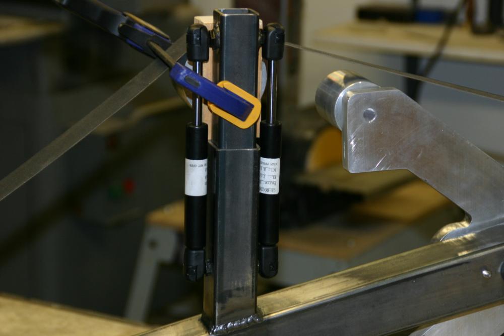

  10. Great point - and mine are indeed cheaper cast stepped pulleys - if they create a problem, I will certainly upgrade them. I made significant progress today, no photos, but the idler/tracking wheel is on One thing how much tension one a belt is too much? Or is there such a thing as too tight? Mine 'twangs' like a bow-string and it has 60lbs of force on it I still have to make a backer for the belt for the platen - and a rest. Then a rest for the 6" contact wheel. Last is the motor mount. Then final finish work and paint.
  11. Thanks John ... In keeping with the 'interesting design' concept, I went with dual gas shocks on a telescoping mount, rather than a hinged arm with springs or shocks. Now I will 'work out how I will make the idler wheel / tracking adjustment. I'm liking it so far ... some of my welds aren't pretty, but they are solid enough.
  12. I got my first order of metal. The main beam is 2"x2" and I put it at a 12 degree angle. I have two 30lb gas struts on the way for a tension arm. Left to do is the tension arm with tracking control. Then the motor mount and drive-belt tension control. Then a bunch of finish work and paint and it's ready to use.
  13. A lot of work - and a lot of left over 'scrap' that is going to be quite usable - and the platen/wheel armature is 'done' with the notable exception of a backing plate behind the belt and the rests for both. It is 5/8" 6061 AL - I figure it will be plenty strong enough for this application.
