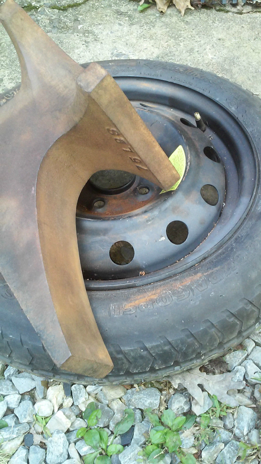

I picked up an M&H Mouse Hole Forge - it's 1.0.10 (122 lbs) My research is that it may be 1830 to 1835 era. It has a line across the top that is not a crack, but looks like a score mark when maybe someone used a grinding wheel across the face and went through the stock into the face ... but that's just a guess. It does not appear to be deep at all, right at the surface. For those in the know ... did these anvils have a steel face? I do not see a line that looks like there is, but I am not sure. Or were they one-piece wrought? I paid a little more than I wanted to, but I drove all that way and the seller wouldn't budge on the price I'm thinking of having the top ground to resurface and I don't think it's 'bad' enough to need to be welded and filled before grinding. I want to use it for small projects and maybe eventually knife-making if I get the chance. Comments welcome!

I read about the 'rebound' steel ball - method of testing hardness. I took a 1" steel ball bearing and dropped without 'throwing' the ball from 10" ... the rebound was about 4.5" on average ... I am convinced that this little anvil is not a door-stop (ASO) cast iron ... It does have several straight line 'cuts' in the face which look like cold chisel marks. I took a wire brush to it and gave it two coats of black paint ... I'll take some photos of it tomorrow.
I actually am picking it up tomorrow and will know more .... It is heavier than a lot of cast anvils I see out there and it doesn't have a really short horn, like cheap cast anvils. I'm hoping that it isn't a really cheap cast ... or (dare I hope) cast steel and not cast iron.
