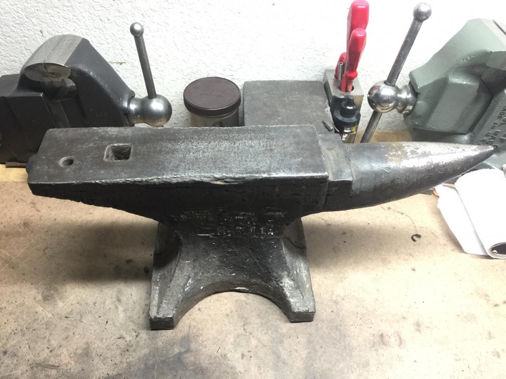

  2. Found this 161 pound PW yesterday decent price all things being relative.

  12. Well a few people tried to warn me about the bench vise addiction that didn't work, now Anvils. anyways its cheaper then drinking scotch. Found this beat to xxxx Peter Wright exact same size as the SISCO I found. I have it soaking in the electrolysis tank to remove the rust I will probably put it in the cabin for looks not work, but cool none the less. May try to clean up the face if I find time. I looked at some of the restorations on this site and You Tube, due to its condition it may be more then I can handle. I have done over 25 bench vise restorations but they didn't require any welding and the ones that did were not worth the effort. I will pull it out of the tank in a few hours and post some pics. All comments welcome even ones that call me an idiot, I am used to it been married for 26 years.

  14. Hello First post on this forum have been looking for a reasonable priced Anvil for about a year or so found this SISCO 66 and was wondering if there is any additional information about this anvil that the experts could share. I did the ring test and I am no black smith so I am guessing but it does ring, I also did the bearing drop and it bounces back about the same hight I dropped it from. Age: Quality: Any other info would be appreciated. Thanks
