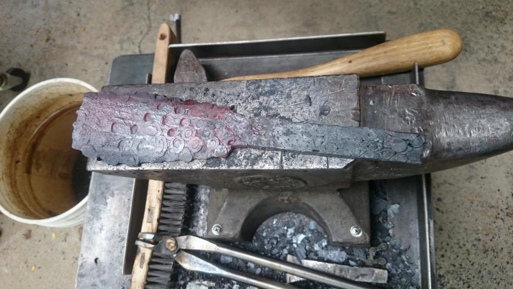

  1. I purposefully avoided a curve, as I'm making this drawknife to trade with a fellow woodworker who wanted a straight blade. I'm going to make another for myself eventually that will likely have a curve.
  2. The wire does fizzle away pretty quickly, but it holds just long enough that I can do the first round of setting the weld. I need to get a mig or stick welder to help with this process. I wanted to draw it out to 8", but I think I only managed 7".
  3. The bevel isn't ground all the way yet, I just started it. But it is a bit thin at the edge, we'll see how it works.
  4. I've been working on this chain damascus drawknife. It started as a bicycle chain and a large old ARCADE bastard mill file. It took me three separate forging sessions, as there was more steel than I expected to draw out by hand and my arms are pretty lame. I now have the forging complete and the drawknife rough ground ready for HT.

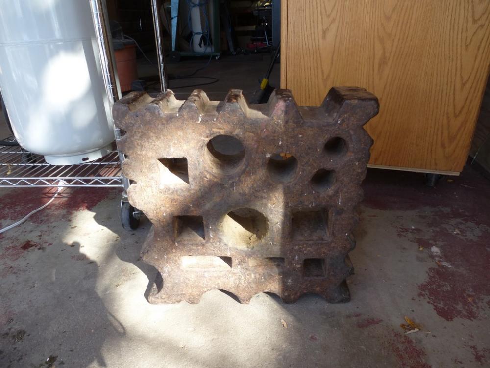

  8. I found this neat old swage block at a local auction for about $200 after all the taxes and fees. It's pretty big, probably weighs well over 100 lbs. A few corners are chipped and crumbling, but overall it looks very usable. I'll get out the wire wheel on the angle grinder this weekend and try to clean it. Looking forward to forging some large carving gouges with this thing.

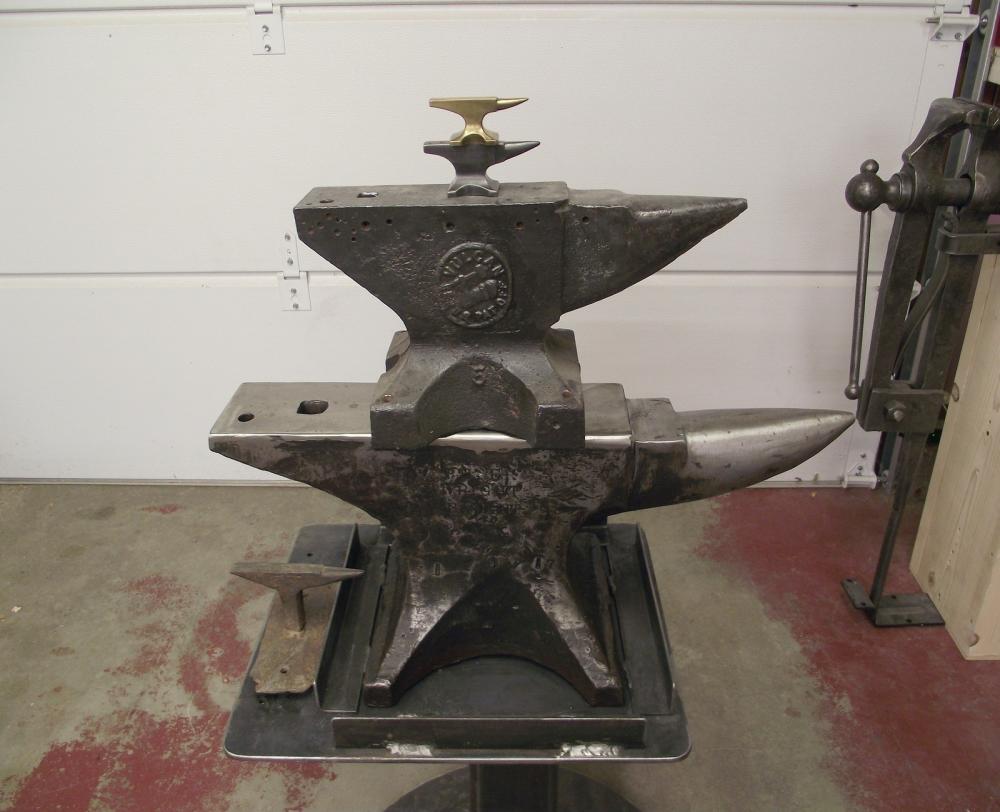

  17. I just bought this restored 129 lb Peter Wright anvil from a fellow member of the Rocky Mountain Tool Collectors. With the bearing test it bounces about 85% on every part of the face, and a small hammer bounces 1/3 of the drop distance (compared to about 40% and 1/10 on the little Vulcan). Tapping the sides, it rings well all the way around without sounding like there are any hidden cracks. The previous owner (and restorer) was a professional blacksmith that taught classes locally. I'm quite happy with it. Since I'm flush with anvils for the moment, I decided to take a family photo. The miniatures look pretty cute up there.

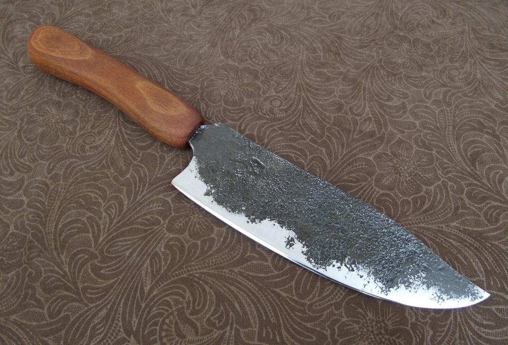

  23. I forged this chef knife from O1 steel and made the handle from African mahogany. Did the heat treatment myself in the forge and kitchen oven. I was aiming to make a santoku, but the edge came out a bit too curvy. Still, I like the shape. The pointy tip is useful for opening food packaging. My sister forged one at the same time, though finishing hers is still in progress.
