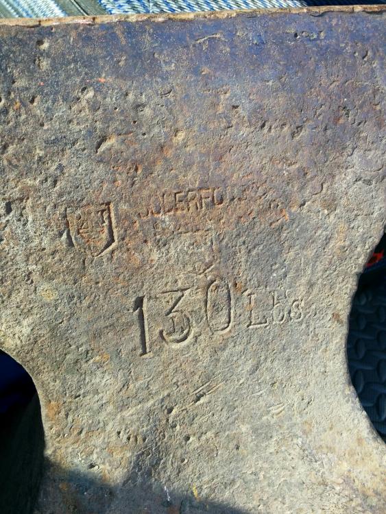

  6. Here pictures of the side with some chipping and the horn which has a few light chisel marks. https://imgur.com/a/7UoqZ
  7. Cool glad to hear it. Thanks for the information guys. Paid $2.70/lb (canadian) for it and seemed like a good deal. It has a bit of chipping on one side where most of the work seemed to have been done on it but that seems pretty common for these anvils reading about them now that I know what it is.
  8. I just bought this anvil I came cross just as I was leaving for vacation off an older farmer type guy. Has good rebound and ring and looks to be in pretty decent shape. The old guy said his dad bought it in the states in the 20s and has been told it is solid steel. Anyone able to provide any more info on what it might be?
