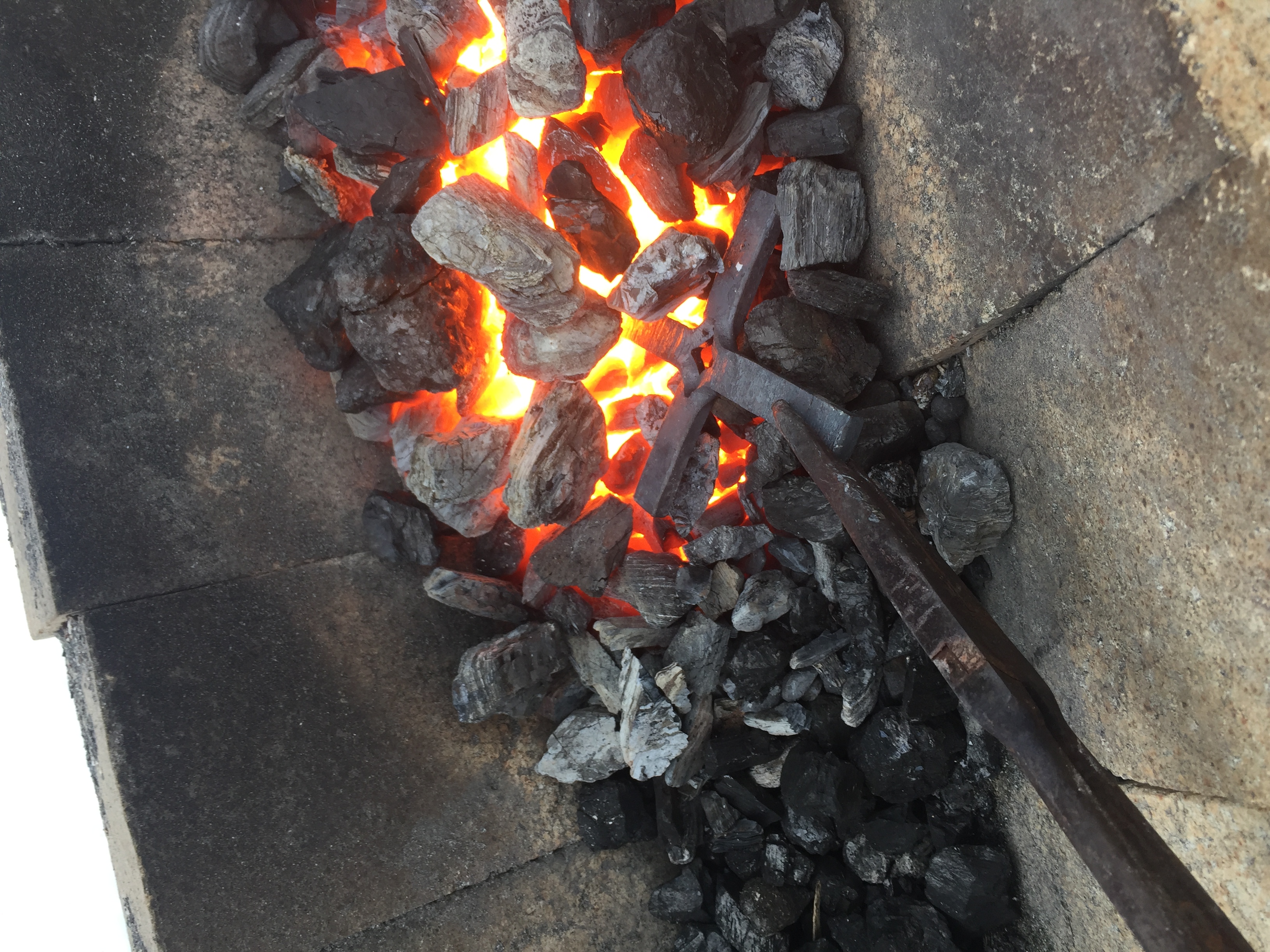

Originally I had designed my forge with a shop vac blowing the air. With this, the nut sized anthracite from TSC was pretty good. Nice and hot, but hard to start. Then I got a hand crank blower...it is very difficult to maintain forging heat with this hand crank blower. From what I can tell this anthracite likes constant air. I will try to enlarge the holes that air comes through and see if I can get the hand crank blower to work with the anthracite this way when I get a chance. PS pics of large flame is with shop vac powering, not hand crank blower. I know my anvil in the pic is a POS ASO, I have a Trenton now.
Heap where in northern Michigan? My "set up" is near Suttons Bay, but I go to college down in Ypsilanti. Therefore I put greetings from SE Michigan. Thank you very much for your time and thoughts Thomas, means a lot to me. Brent
Thank you Thomas! Do you think just enlarge those holes or group them together more also? All the forges I see have a "cluster" of holes instead of a linear pattern as I made. Is this a flaw in itself? I also am a little confused about clinker..I get tons with the shop vac if I leave it blowing constantly but not much if I turn it on and off a lot. Why is this? Should air flow be constant or intermittent for a forge? Sorry for not knowing this if it's simple.

Unfortunately these are the only pics I have of the forge. In the one pic you can see the 5 holes I drilled in the 2inch pipe, there are the only exits for air. I also included a sketch of the forge to the best of my ability. Im thinking I either need more holes or holes closer together for the hand crank blower. What do you think? Brent

Thomas, the bottom is not very uniform looking at all, so to me it is very hard to tell if it has an hourglass depression, but I would go with no. It has a square hole on the bottom, and one on each side as well. No square hole on front foot like seen on some Peter Wrights. I'll post more pics later today. Frosty, thank you! I'll post a few more pics of the forge later today as well. It's basically 2inch iron pipe screwed together with firebrick used as a wedge to keep heat off the grill material itself. When I made it I unfortunately did not (and still do not) know much about what a successful forge needs to have. with the shop vac and anthracite nut coal from Tractor Supply it gets really really hot (hot enough to burn any stock I've put in it), but with the hand crank blower it didn't seem to get very hot at all. I suspect maybe both the forge and coal are to blame. Brent
