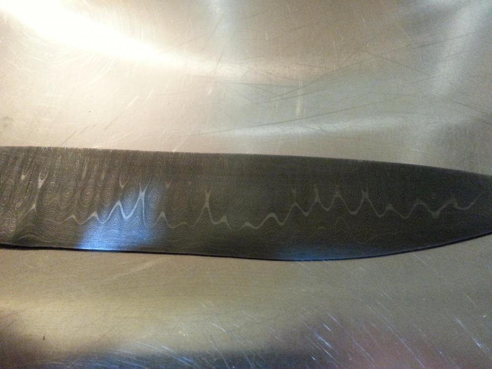

So i finally found a local supplier for some ferric chloride and im much much happier with the results. Same knife as above, cleaned off and re etched. -

Its 1080 and 15n20 for the alloys. -
So when i first started doing my knives using damascus steel i etched them using boiling vinnegar. Then after that i was told it didnt need to be boiling and that it could just be room temp vinnegar. And then somone suggested i might see better results by using coffee. So i decided to give it a go and here are the results. Now im happy with the etch for the most part but this etch method has left the steel with these weird colours on it, kinda gold to almost a grey blue. Is this the normal effect of a coffee etch? Also this was after 1.5 hours of etching. Over all while the coffee definately works im not quite happy with it. Il be stripping this one off and trying to etch again later with something else. Trying to track down some FC. Any other tips or house hold etch solutions are welcome.
