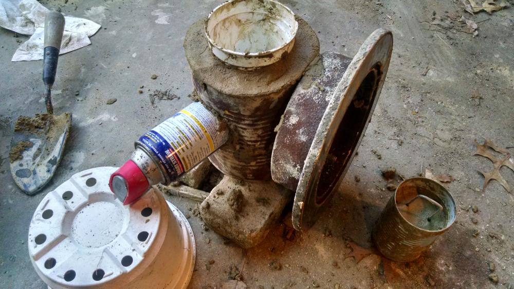

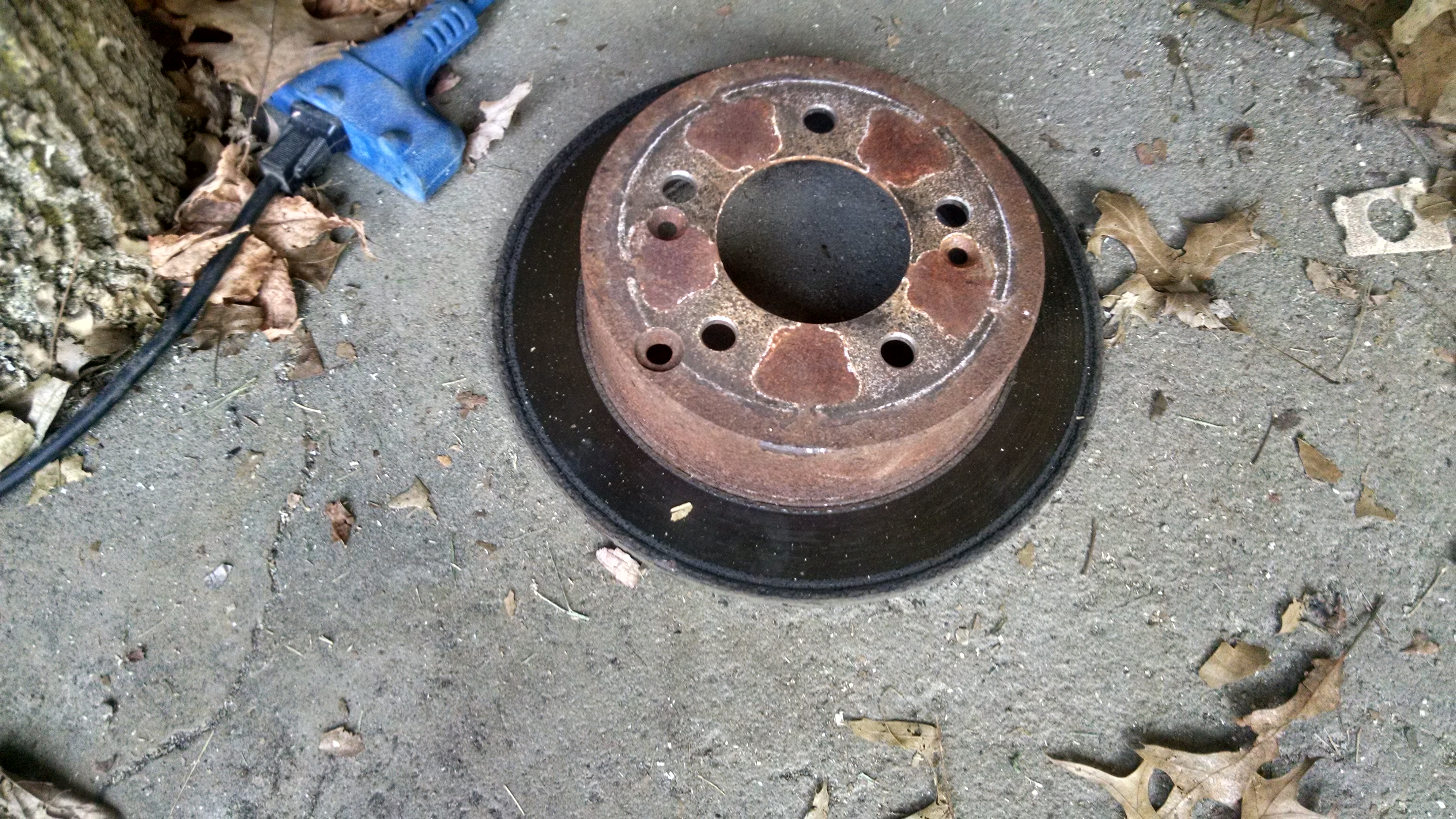

  23. So here are all the holes. A salvaged brake disc for a base. And some toilet bolts to attach it. Of course, it's not a project until someone bleeds... Everything bolted together and ready for adobe. Half sand, half clay, enough water to make a pretty stiff mud. And adobe in. The white plastic thingy is a drinking cup that will act as a core to keep the adobe from slumping while it dries. The WD-40 can is similarly intended to form the hole for the burner. I'll let it dry for a couple of days, and see how things are going.

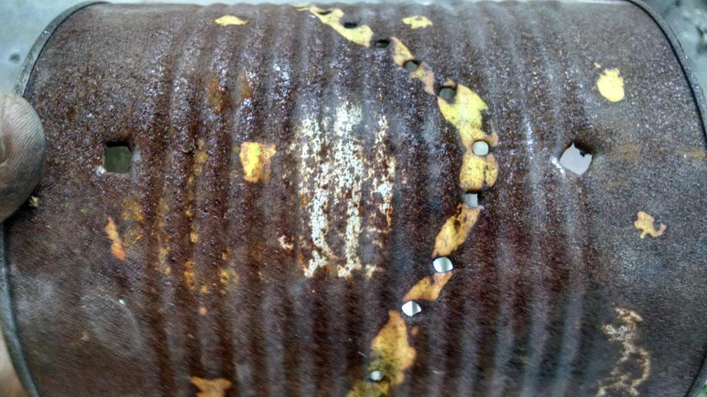

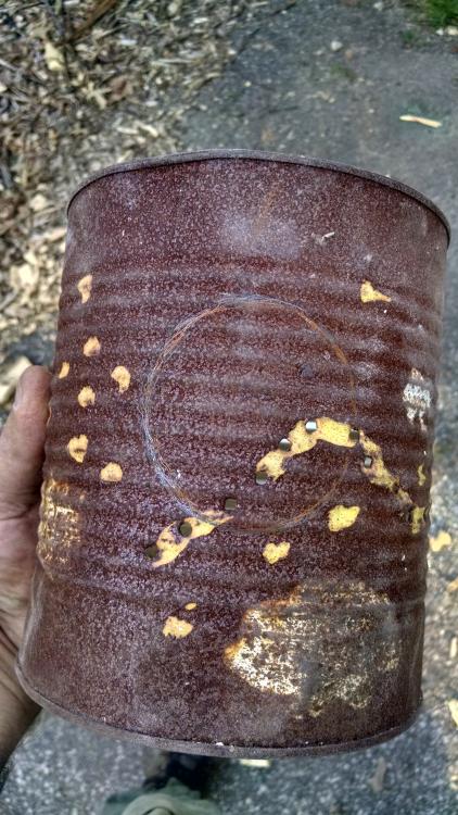

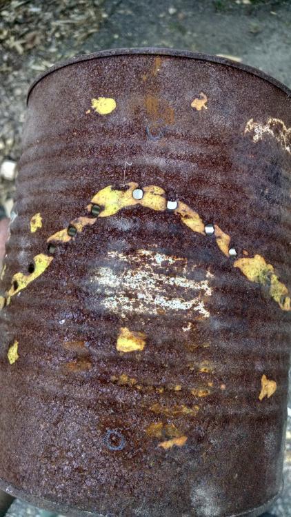

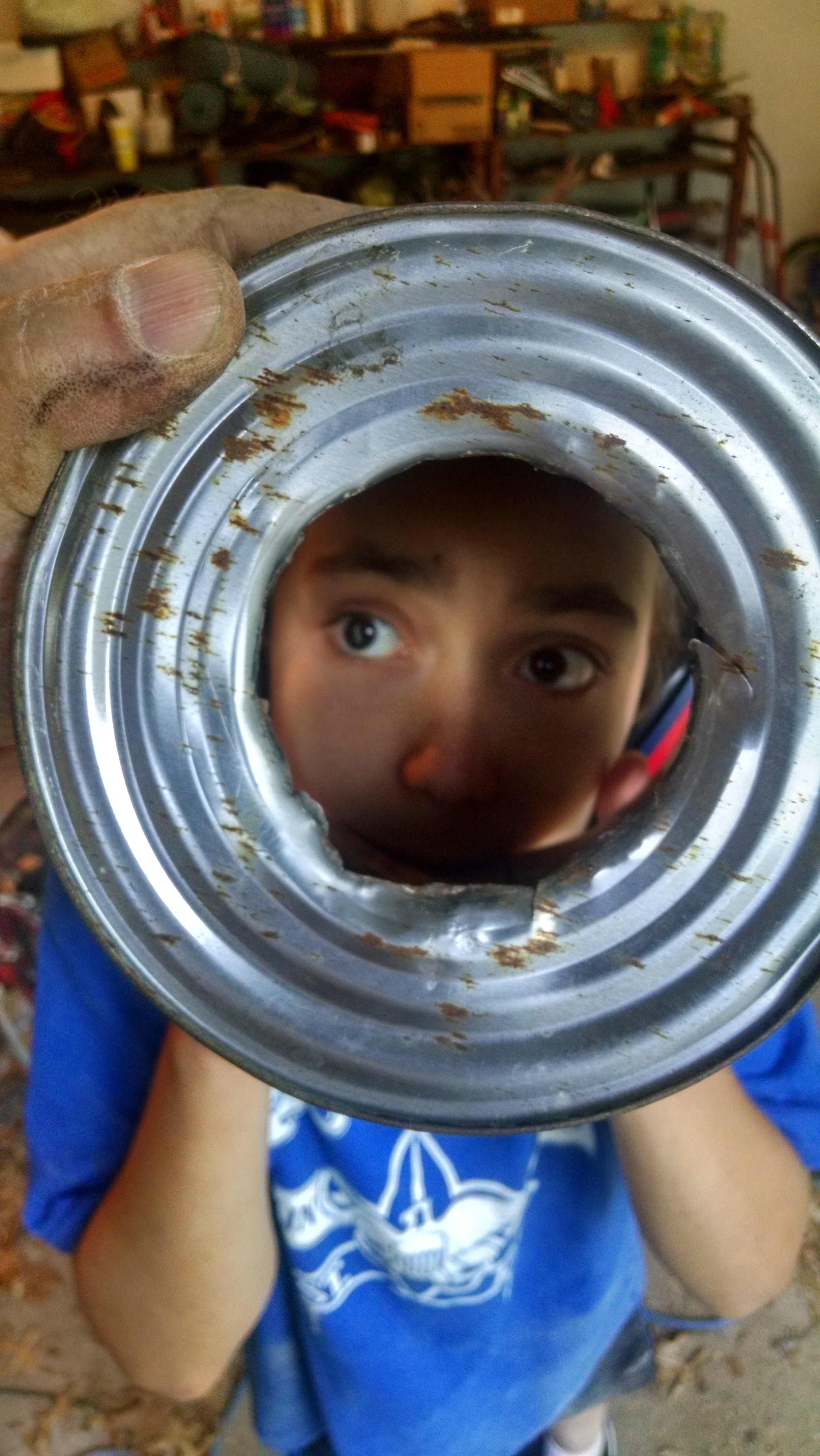

  25. Hi, all. As noted elsewhere, I'm restarting my old blacksmithing hobby as something to do with my son. The modus operandi at this point is to start with what's left of my old setup (my old anvil and some hammers) and making, modifying, and MacGuyvering everything else. Cheap is good; free is better. So, I looked around at what I've got to actually heat the metal and decided to make an adobe-lined coffee can forge to use with an existing propane torch. This post is to document the process and record the mistakes for me to fix next time! So, I have plenty of clay here in NE Ohio. Here's my son grinding up some dried lumps of clay I'd set aside for a pottery project that never materialized. I didn't have any sand, but I do have some sandstone that crushes easily. I figured that I could cut a hole in the bottom of the can for longer stock and make an adobe plug to close it off if necessary. Here is the bottom marked for that hole. Here's the side marked for the burner hole. And the other side marked for the holes to mount it to the base. Holes punched for bolt holes. Used a big nail I had sitting around. The hole cut in the bottom. I don't have tinsnips, so I bashed out the hole with a cold chisel. Bubba looks through the hole.
