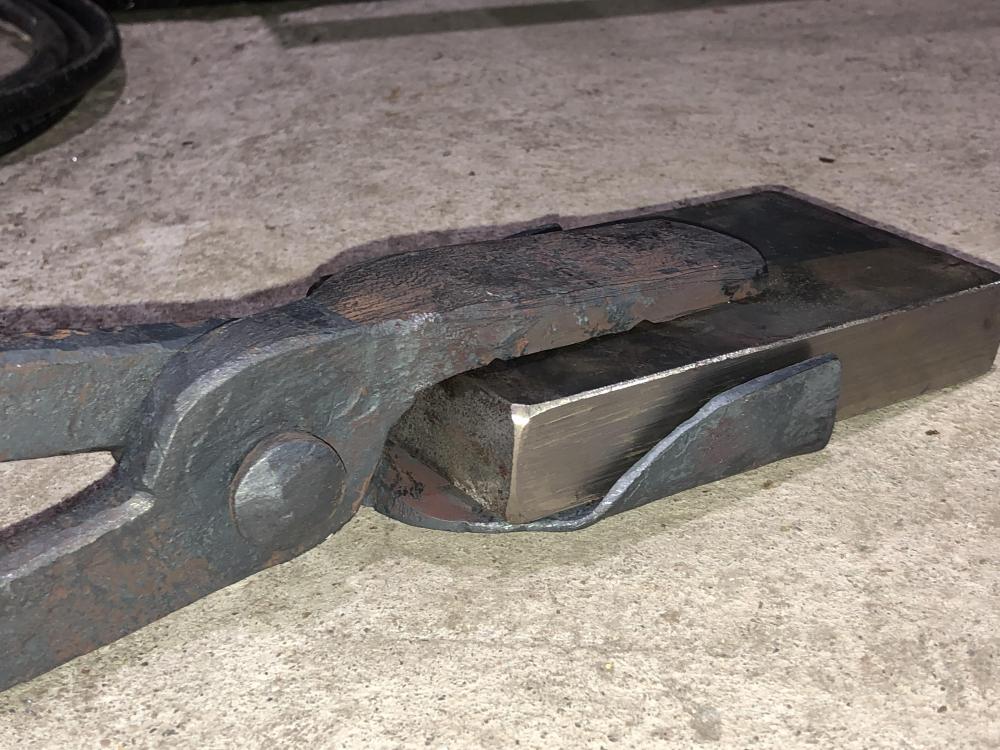

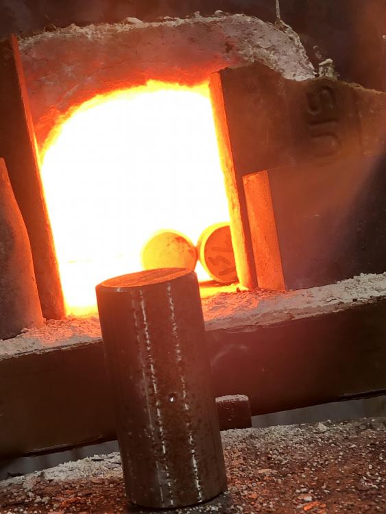

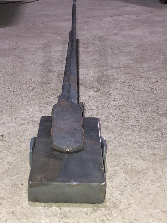

  1. I recently made these. This is a pair of 6-inch billet tongs designed to wrap around and manipulate 6-inch solid material. I took a few process photos showing each major development but not quite every single heat. starting material was 20 inches of 3/4 round 5160 I used 4-inches of material for the loop to the square corner 2-inches from the square corner to the boss. overall finished length is 36-inches. IMG_6732.MOV

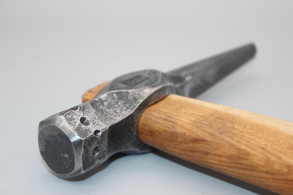

  3. I think I am going to try making a hammer today! I think I will try for a cross pin style! wish me luck!

  6. I think that pair ended up about 5 pounds or so. Definitely not your typical, work-at-the-anvil, pair.
  7. I made these today! This is the largest pair of tongs I've ever made to date. They are sized for holding 1 x 3-inch flat bar They are 33-inches long Rivet is 1/2-inch mild steel Tongs are forged from 4140 steel These were a challenge but also surprisingly simple. Basically just all the same steps as small tongs, made big. One thing that helped was I did a rough sketch on my layout table of the box-side of the jaw so I had some target dimensions to shoot for. I also laid out the center line, as on these larger ones you want the jaws to overhang the outside edge of the reigns as apposed to being in line. These were a lot of fun!
