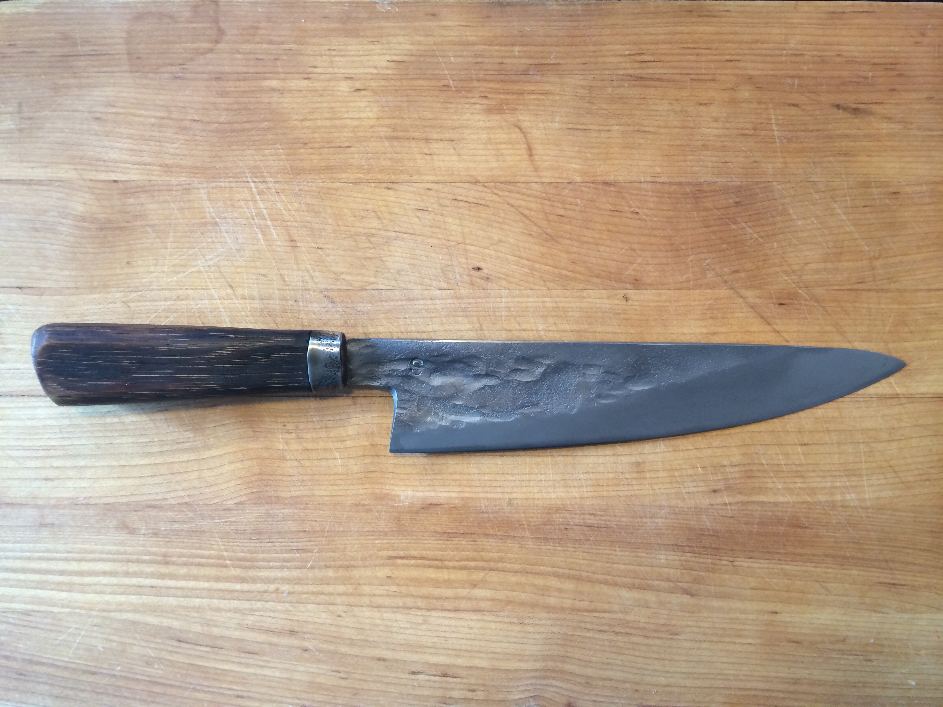

  6. First off, the knife. I figure it's fitting to begin here since it is what finally decided me on having my own smithy. It was made during Arnon's 3 day Japanese Chef Knife course. It was a fantastic course. Arnon and Nitzan were great teachers, and hilariously entertaining. If you are near the Portland area and have a chance to take this course, I highly recommend it.
