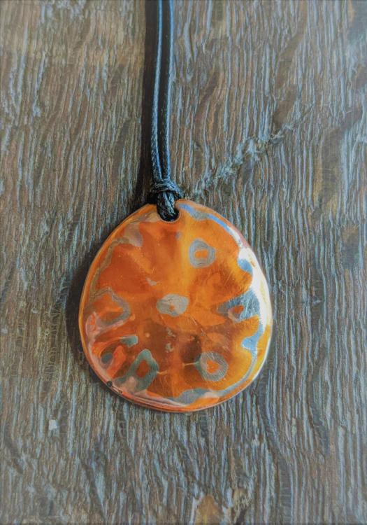

  2. Just for grins, and because I hadn't tried the quarter thing in a while I spent a dollar on making this little guy yesterday for my wife. Took the time to sand the quarters flat & smooth to 220 grit before doing the usual cleaning, I used a little borax paste for flux and a slightly rich adjustment to the gas forge, worked a treat.
