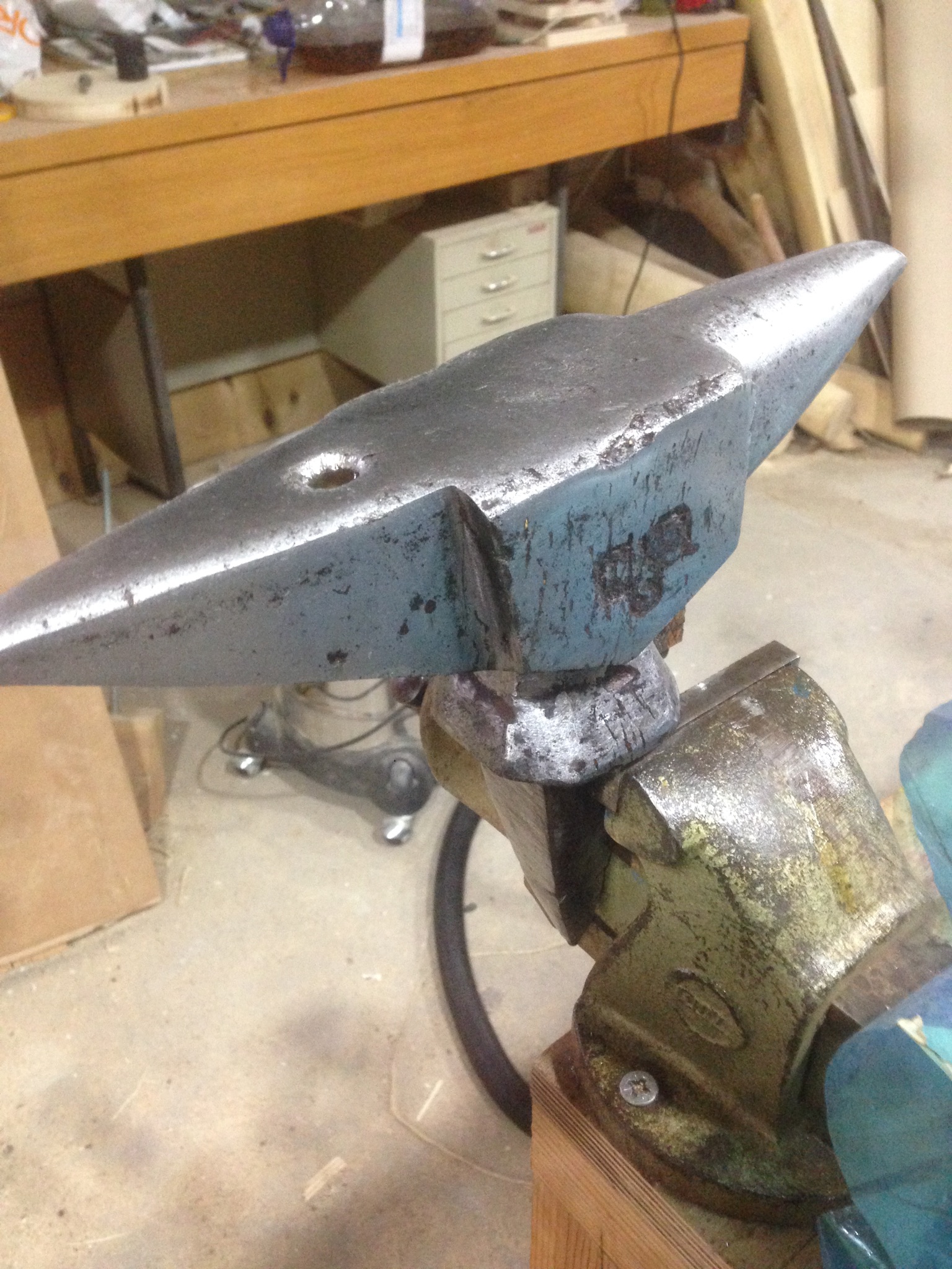

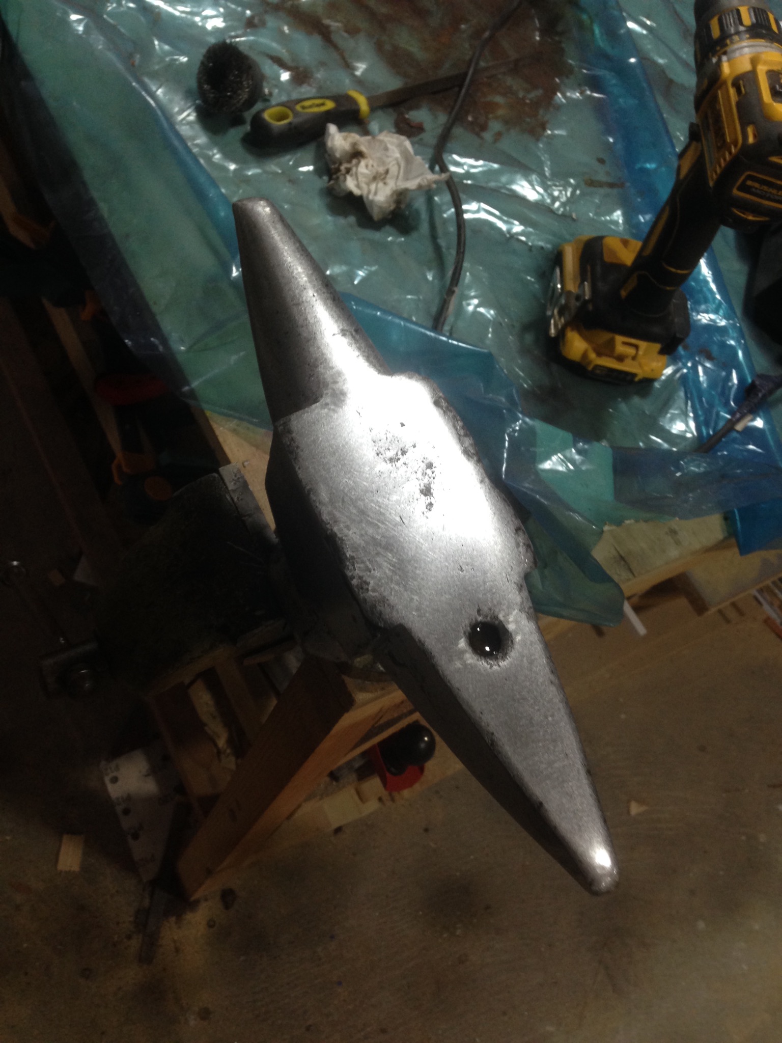

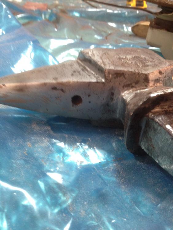

Vitorino Posted January 17, 2017 Share Posted January 17, 2017 Hi everyone! I found an old and small anvil in my grampa's garage and decided to bring it back to life, so to speak. After I cleaned all the rust, I realized my pritchel hole does not actually go through the anvil, although there is a matching hole on the other side. I'm pretty sure the hole isn't clogged, I have cleaned it to bear metal and actually pour some wd40 in the hole to see if it would seep through the hole, out the other side but nothing. Can someone enlighten me? What is the purpose of this "dimple"? I'll put some pictures up. Thanks in advance. Quote Link to comment Share on other sites More sharing options...

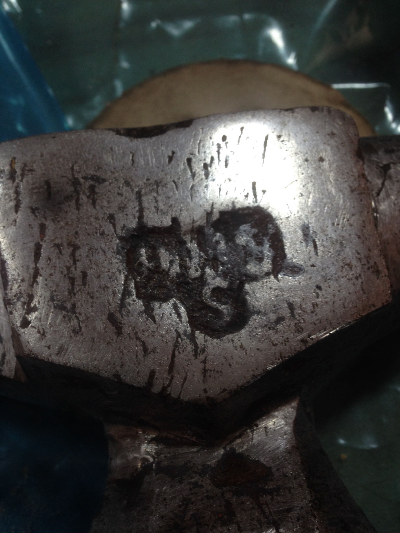

fat pete Posted January 17, 2017 Share Posted January 17, 2017 looks like what they call a stake anvil... almost like a big hardy tool.... what does it weigh??? any other markings on it??? That hole could just be a hole the previous person wanted and drilled into it... looks like it has been used as it is really chamfered... Quote Link to comment Share on other sites More sharing options...
JHCC Posted January 17, 2017 Share Posted January 17, 2017 Definitely a stake anvil. Do a google image search, and you'll see lots of similar ones. The dimple could be for setting rivets, possibly with a hand-held top tool with a matching divot. Put the head of the rivet in the dimple, and it won't get hammered flat while you're hammering a dome on the other end. Quote Link to comment Share on other sites More sharing options...

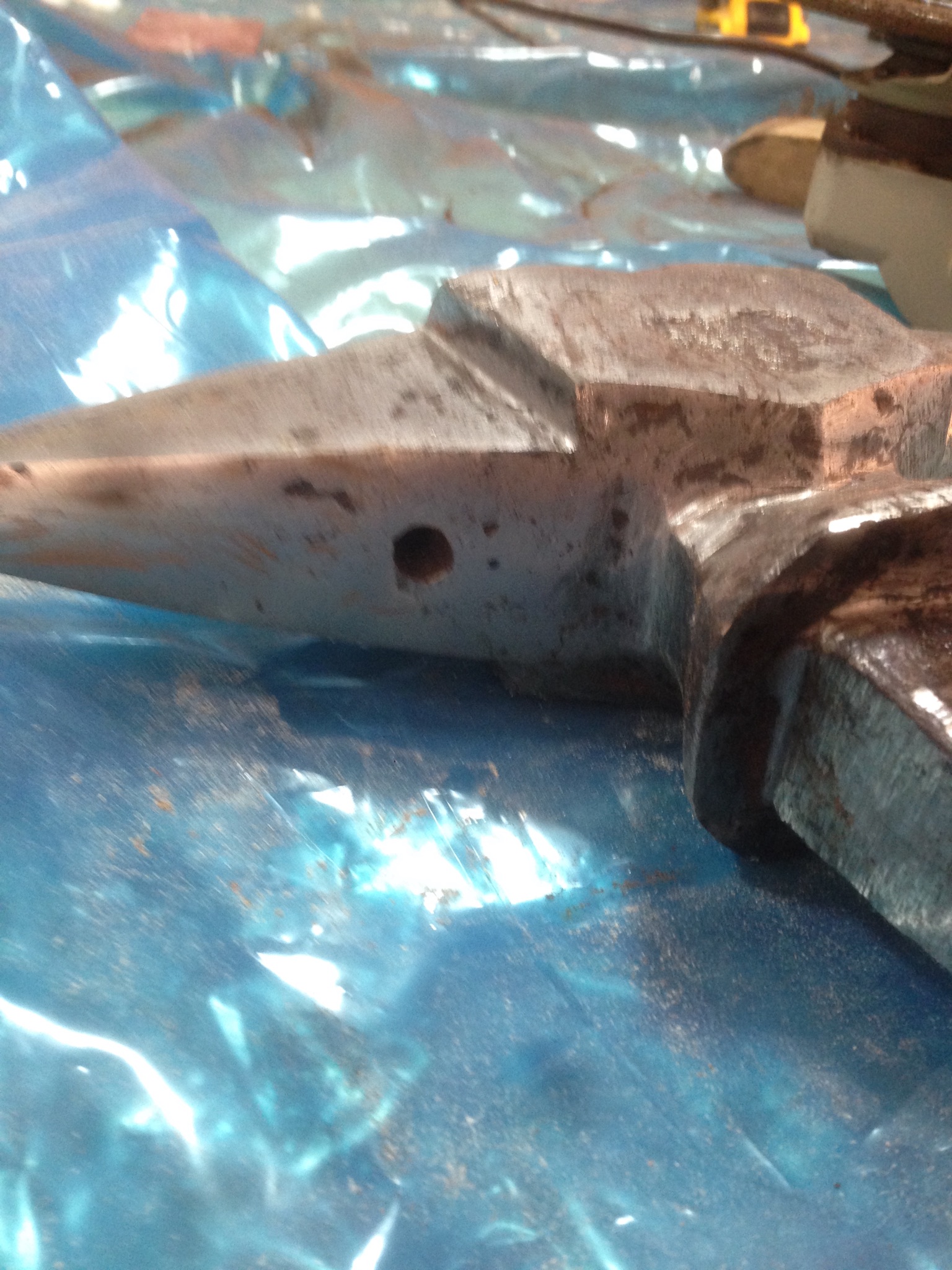

Vitorino Posted January 17, 2017 Author Share Posted January 17, 2017 5 hours ago, fat pete said: looks like what they call a stake anvil... almost like a big hardy tool.... what does it weigh??? any other markings on it??? That hole could just be a hole the previous person wanted and drilled into it... looks like it has been used as it is really chamfered... Without putting on a scale, I'm guessing 4, maybe 5 kg. There is a letter 'S' on the side of it and I believe it had more marking that fadded away. The strange part of it is the hole on the bottom, opposite the 'rivet hole' as sugested by JHCC, in the comment below. What could that be? 4 hours ago, JHCC said: Definitely a stake anvil. Do a google image search, and you'll see lots of similar ones. The dimple could be for setting rivets, possibly with a hand-held top tool with a matching divot. Put the head of the rivet in the dimple, and it won't get hammered flat while you're hammering a dome on the other end. Any idea on the bottom hole, opposite the 'rivet hole'? Perhaps the hole was to hold half of some kind of plyers? Does this even happen? Quote Link to comment Share on other sites More sharing options...

fat pete Posted January 18, 2017 Share Posted January 18, 2017 ha, yes sir you can put that in a hardy hole if the stake end fits. I cant see the hole underneath but I guess it could be a forge hole where the tongs would fit in... JHCC has the best question here for you to answer..... Quote Link to comment Share on other sites More sharing options...
Marc1 Posted January 18, 2017 Share Posted January 18, 2017 Love it. It has been used extensively, my guess is riveting leather or heavy canvas belts (?) ... but only a guess. love the idea of having a hardy hole tool shaped as a miniature anvil ... definitely an excuse to find something to hold your little anvil ... absolutely! I suggest 350 lb as an ideal base Quote Link to comment Share on other sites More sharing options...

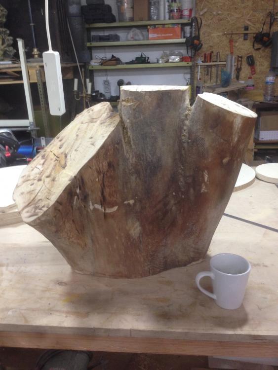

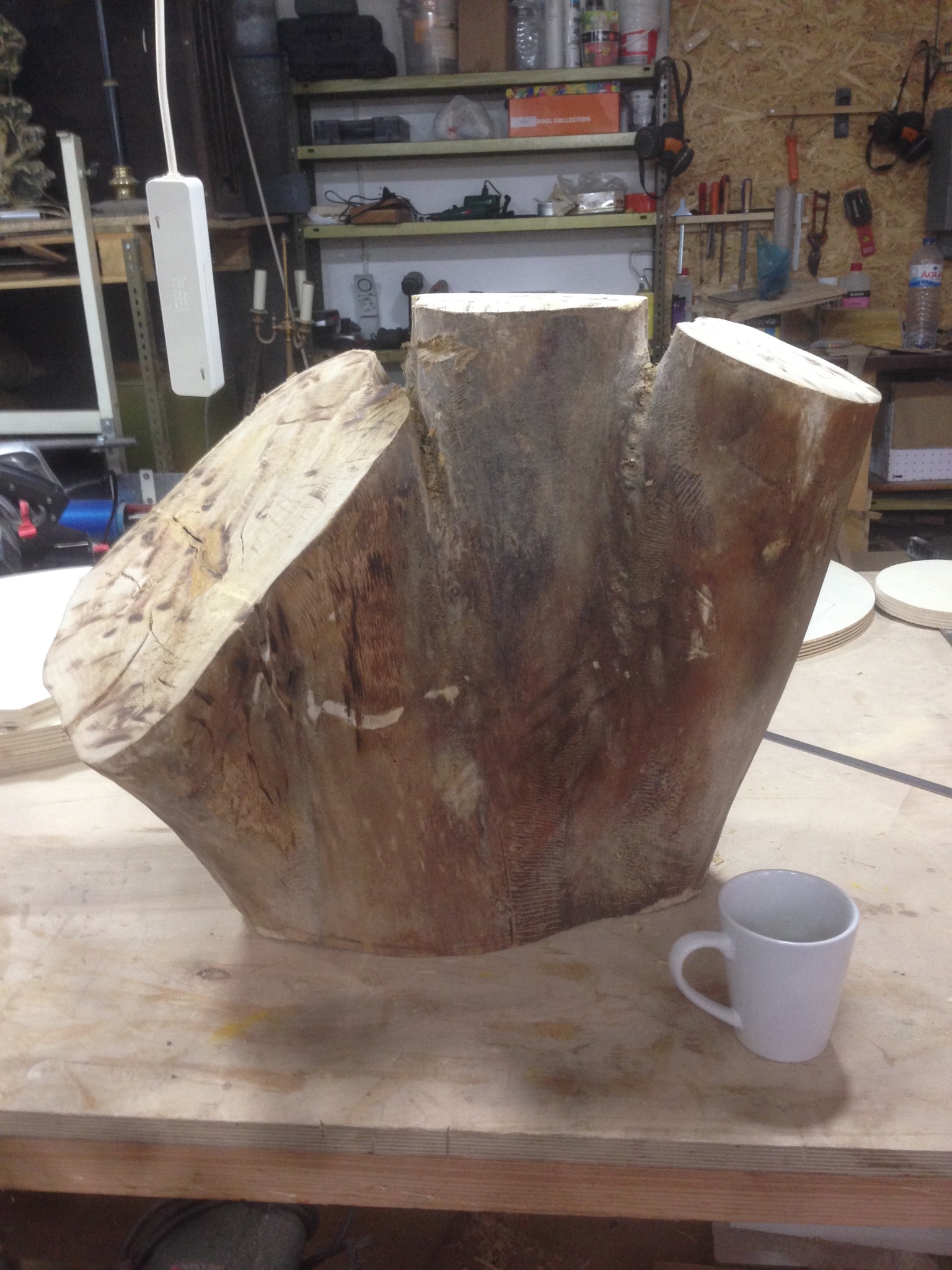

Vitorino Posted January 19, 2017 Author Share Posted January 19, 2017 Thanks everyone, you've been super helpfull. I'll finish up the restauration and put some pictures here for you guys to see. Also, since we're on the subject, I got this big tree stump I'm thinking of using as a base. The thing is, it's got 3 "branches" on the top end, I'm thinking of staking the anvil on the middle one but not sure what to do with the other two, you have any recommendations? What would be handy to have next to the anvil? Maybe drilling some very big holes on the larger branch, to the left, to hold all the hammers I don't yet have? Here's a picture of the stump Here's a better picture of the inscription, it's pretty fadded. And the hole under the anvil, which does not go through the anvil but is simetrical to the 'rivet hole' on top Quote Link to comment Share on other sites More sharing options...
John McPherson Posted January 19, 2017 Share Posted January 19, 2017 Vitorino, there is a jeweler on the Rio Grande youtube channel that has a centrally located stump in his studio like that with multiple stations for vises at different heights, swage blocks, bench anvils, etc. Since he normally works in a sitting position, he can just roll around the perimeter in an office chair to work. Imagination is more of a limit than tooling to most folks these days. That is why getting out and going to conferences, hammer-ins, and reading multiple fora is important. It is the modern replacement for the old journeyman's trek. Quote Link to comment Share on other sites More sharing options...
ThomasPowers Posted January 19, 2017 Share Posted January 19, 2017 Swage block on the big one as it can be used on a slant for some processes, hardy hole on the other small one. Quote Link to comment Share on other sites More sharing options...
