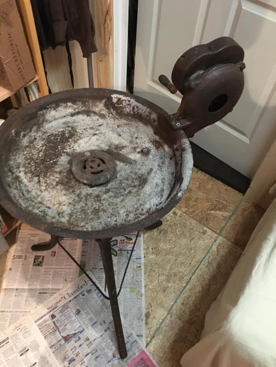

SandHuf Posted January 16, 2017 Author Share Posted January 16, 2017 This is the forge I'm using. Or will use. Quote Link to comment Share on other sites More sharing options...

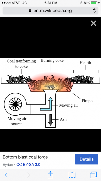

SandHuf Posted January 17, 2017 Author Share Posted January 17, 2017 So is this just the normal coal and coke set up? Quote Link to comment Share on other sites More sharing options...
SReynolds Posted January 17, 2017 Share Posted January 17, 2017 Somewhat I'd say. That is the "normal" method. Your coke fire would be heaped up higher. As your picture fire is only as deep as the firepot. It would be banked higher than that. Then the work is placed horizontally into the fire. The work will not be placed "down into the fire pot" so much. It is above it. So, the fire must be higher than fire pot. So your question is; what is the fire pot for? It holds the fire but you dont really want to use that part of it as it is laced full of oxygen. The firepot will also allow you to walk away from the fire for a time with out it going out. It holds the fire. Some will say to never walk away from the forge fire. Ok. But what does it do when I'm not there that it won't do when I am? I like not having the fire go out in ten-fifteen minutes when I have to walk across the street. I cover it with green coal and it keeps. Quote Link to comment Share on other sites More sharing options...
