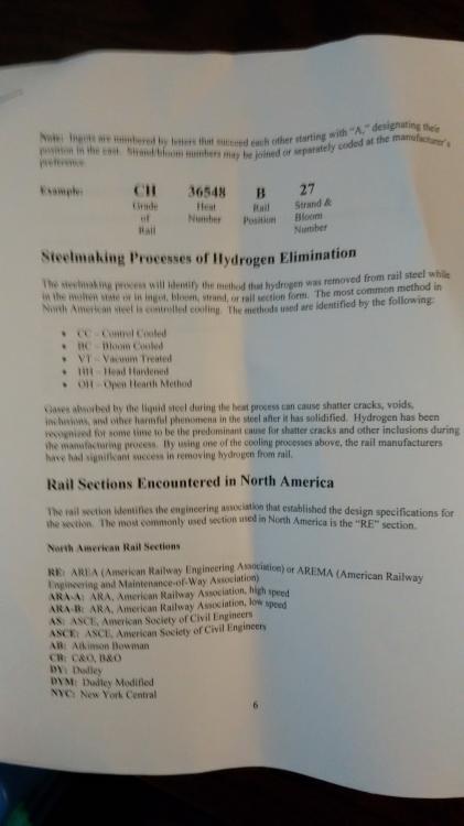

Hello everybody. I know just enough to know that I have a lot more to learn, but as this site has contributed a lot to my short smithing journey I would like to contribute a little something I found interesting while I was in search of something to use as an anvil. I believe others here will also find this interesting.
Like most beginning smiths I was in search of a good piece of rail to pound steel on but I happened to get my hands on a whole bunch of it. All different lengths and sizes with various markings, but most was heavy main line rail. I made a few horizontal and a few upright anvils and ground the webbing on some into bottom fullers and shaped the flanges of some into hot cuts. I then began grinding different shapes into the heads of some to use as swages.
But I had way more then I needed so while trying to decide what to do with the rest I started researching rr steel composition. I went to different manufacturers websites and called a few manufacturers and found that the general consensus of this website that rr rail is about a 1080 is correct. One rep even read to me the specs of the last shipment of rail that went out and I don't remember the manganese content other than it was high, but I do remember the carbon content was 0.77.

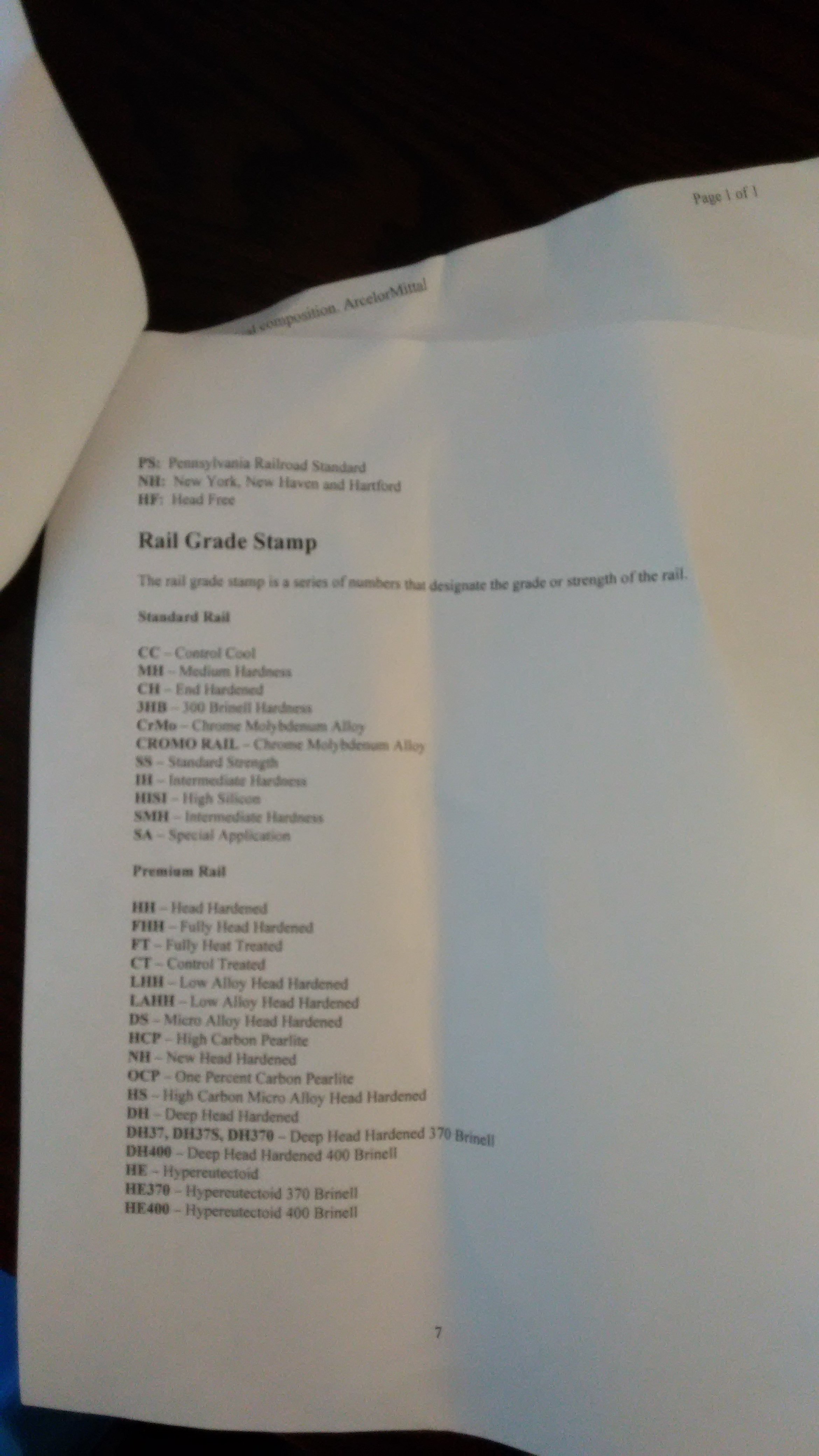

Well, here is what I found the most interesting. I found an AREMA (American Railway Engineering and Maintenance-of Way Association) guide for identifying rail defects that lists some of the abbreviations that are stamped into the sides of rail and the HE abbreviation stands for Hyper Eutectoid. Well I have a piece with this stamp in it and I'm using it as a vertical anvil for forging knives primarily. It does a great job as an anvil, but I'm thinking that that piece alone is about 90lbs of great knife steel! I know that I don't know which hyper eutectoid steel it is, but based on its intended use you can probably make a good guess about which ones it isn't. It's constantly stressed and has to be springy and have some flex to not break under load. Maybe 1095? I know there would be a wow factor with some people knowing that they just got a knife that is made from rr track. I know I think it's cool.
Anyways, for what it's worth, here are pics of some docs I got some of my info from including the composition guidelines for Mittal, a major manufacturer of rail (the rr rail says AREMA in front of it), and my HE rail anvil.

would it be possible to get a clearer read out on the data?  I would like to add it to my RR Steel file as another datapoint.

​If you send me your email address I can email a better copy. Other than that, I was unable to link from the site to this post. Don't know why. I wish it had come out clearer. It's clearer on my computer.
The eutectoid composition on the iron/carbon phase diagram is 0.77%. Hypo eutectoid compositions have less that that and Hyper eutetoid have more. I have audited the ArcelorMittal facility in Steelton, PA becuase that is one of the few shops inthe company that still make the ingots we need for forging. They do make rail their and what I found most interesting is that they have to achieve a hardness in excess of 40 HRC while still keeping the microstructure pearlitic. No martensite or bainite allowed. So, while the compostion of rail is perfectly fine for blades the microstruce is not.
Good morning everybody. After reading Patrick's post (thanks for posting, by the way) my curiosity was further peaked so I had to find out what would happen to my "HE" rail if I tried to harden a piece. Well I cut off a small sliver with a hacksaw because my friend has my bandsaw right now and curiousity didn't allow me to wait for it.
I can tell you that it hardened just fine. This was with a crude hardening process for any hyper eutectoid steel. I don't know if my piece of rail was ever under stress from having a train run over it or if the manufacturing process stresses it, but I didn't even normalize it. Just cut a sliver, let soak above non magnetic for about 5 minutes in my brick forge and straight into a large jar of canola oil. The grain is pretty fine. Not as velvety as a good file gets, but still pretty fine, without normalization.
