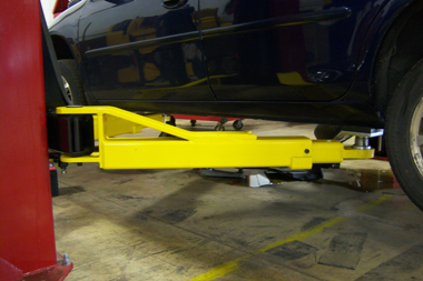

I'm posting this because I believe I may have found an object I can use for a beginning anvil, It is the short arm from a very old Two-Post car lift.
It's very similar to the one in the attached picture, and the area that I plan on using is the plate where the arm attaches to the black area of the lift itself.
the plate's dimensions are:4" wide x 8" long x 3/4" thick
The entire arm weighs about 60lbs. It has a nice ring when struck, but I haven't done a rebound test yet. I am not planning on forging large items.
My questions are, can anyone help me identify what kind of steel the arm is made of and are there any ideas to cut/weld to improve it?

Even a small OA cutting torch will do 3/4" thick material, and all you needed to cut through was the upright which is a lot thinner. If it was me ,I would have cut the upright around 2' up, and used that as the pedestal for the now upside down base. Weld the other baseplate to the first, and Bam! You have an anvil. The arm has the weight needed, but it is all spread out, and tubular in places. Take the arm, and cut off the tabs where the pivot pin passes through. Now stand the arm on that end.  On the other end you want to weld a chunk of steel big enough to cover it, and then some. You may have to play with the height to get it around the closed fist knuckle height.
It was a 1980's Challenger Lift, But as of yesterday morning its all in the scrap yard. The arm I received was a gift from my shop foreman at our dealership. He heard I was looking for something to beat on, I can't complain with what I got for free.
I may do the cut and weld like you are mentioning though, ideally I want a plate big enough to stand itself up, the tube in the center (and for weight I may weld the 2nd part of the arm into the first) then weld a plate on top.
