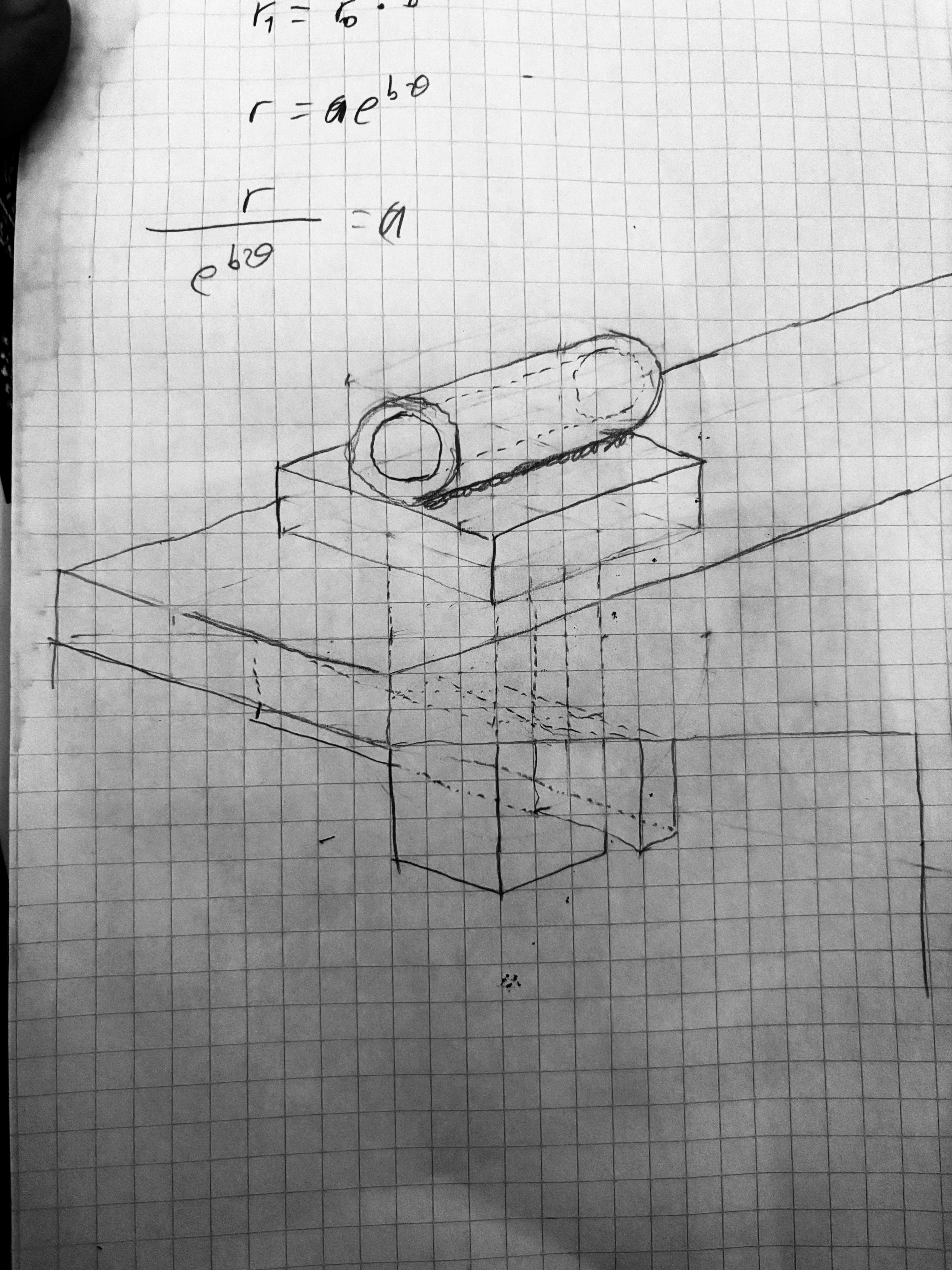

JHCC Posted January 26 Author Posted January 26 I suppose one could make a version that would fit in a hardy hole. It would work even better with a wedged shank. Quote
Ridgeway Forge Studio Posted January 26 Posted January 26 You’re right, and that’s a good design. But I don’t wonder if we are over thinking this- one for the vise seems plenty strong. If you made the shank have a right angle bend it could seat itself along the jaws. Quote
JHCC Posted January 26 Author Posted January 26 All depends on whether your anvil or your vise is more likely to resist twisting. Quote
