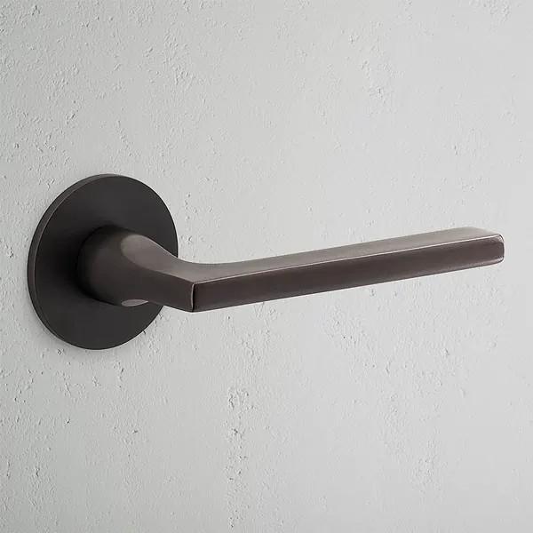

Has anybody made doorhandles? This type (image from internet foe illuatration purpose)
How to make the square so it fits over the shaft?
My idea was to drill to size and than with square drift make to size and shape.
But the hole does not continue, so will that work?
Thanks.

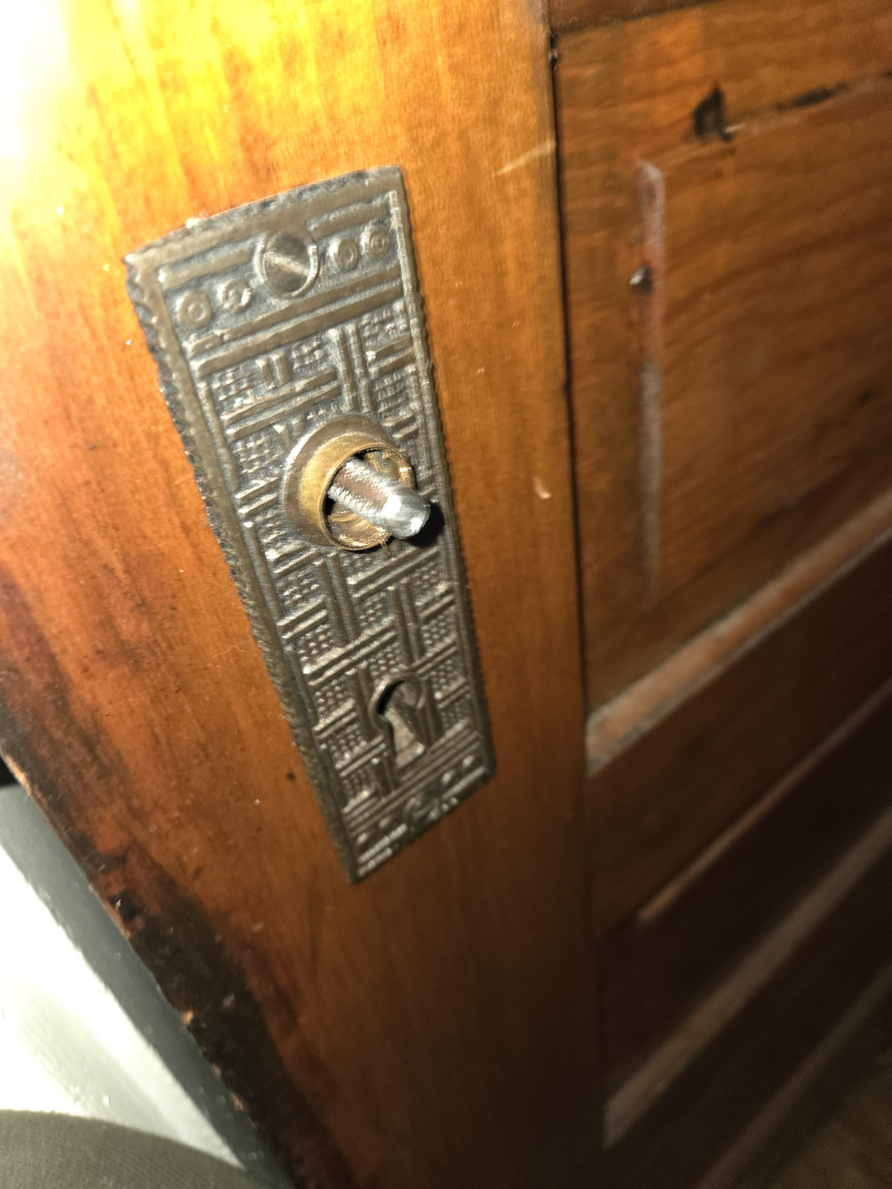

Yes i have. Put threads on the square rod. Drill and tap the handles. The threads on the square rod only need to be on the corners of the rod. Then cross drill and tap the handles for a set screw. I used 1/4" square rod, knocked the corners down till they fit in the die, then threaded them.
They are kind of hard to find here but you can buy replacement rods for old door knobs and handles that are made like that. The ones i found were a bit pricey so i made my own.
Best pic i could get.

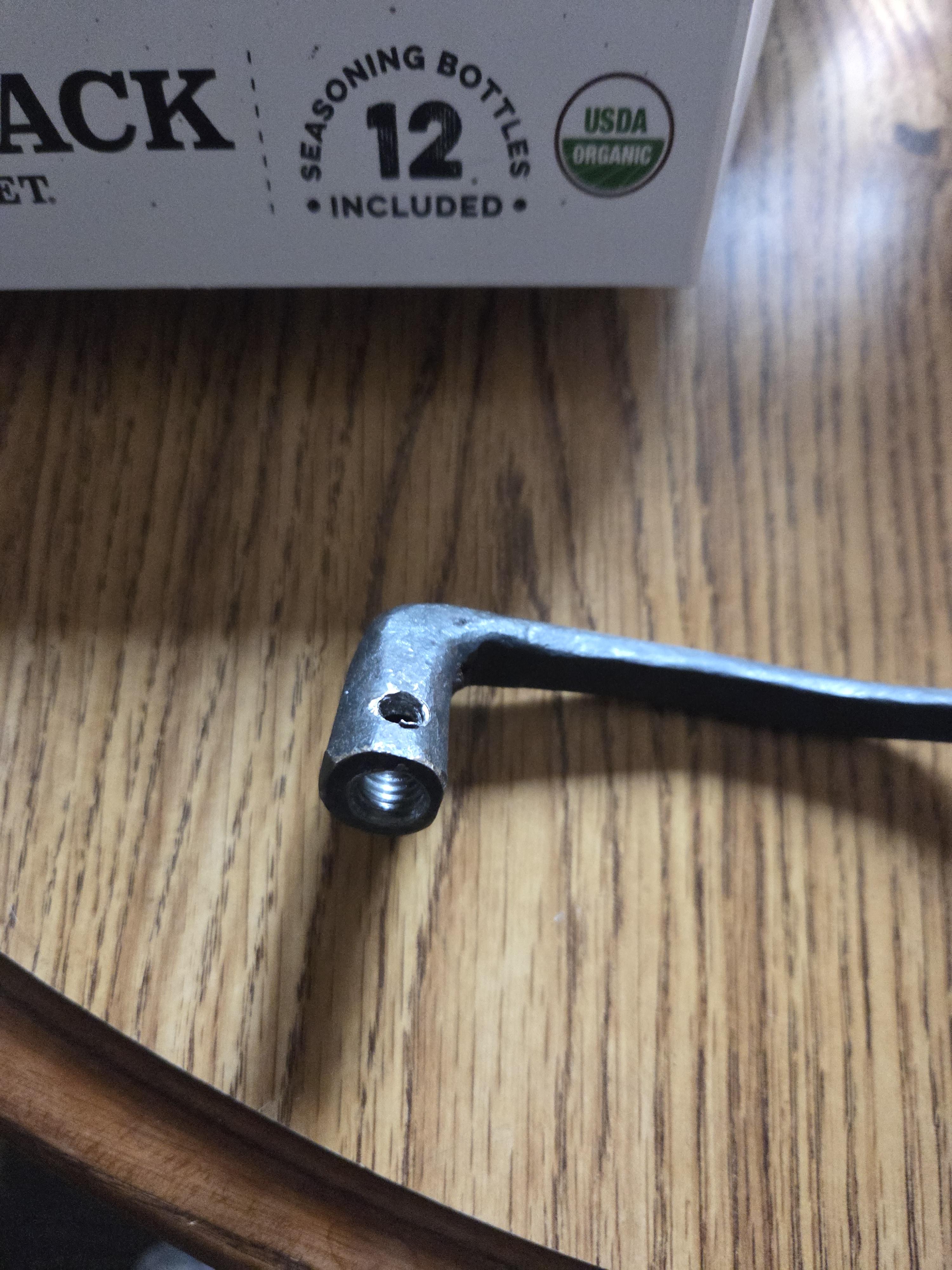

The handle.
And the hole in the handle is round?
Yep, a round hole in the handle.  It threads onto the rod, and the set screw locks it in place.  This is probably obvious, but when you thread the rod, the die needs to be bigger than the stock thickness - -maybe a 5/16 die on 1/4 square (or an 8mm die on 6mm square, I guess).

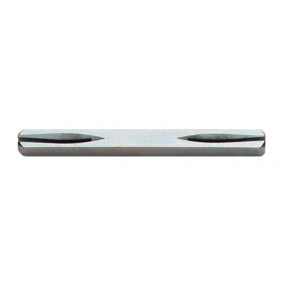

Here the rods are square and have 2 groves in the center of 2 sides or a dimple with holes or a cut
You lock the handle with a setscrew or older ones with a pin (or nail or ...)
