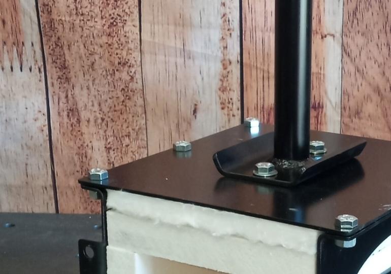

Shopping around for a single burner forge. Asked the vendor the following question and this is the response that I received. Not sure if he is wrong or right, but it surely contradicts all my other research.
Question Asked- "Would you suggest refractory cement and or rigidizer on the exposed insulation fabric ?"
Reply Given- "Well, from someone with over 30 years in the industry working with refractories, you can use rigidizer if you like but it is not necessary. You should never use refractory cement on ceramic blanket, regardless of how many folks on the internet suggest it, they are just plain wrong."
Thanks in advance!
Welcome aboard Bootss, glad to have you.
He didn't lie to you, rigidizer is your choice though we recommend it for breath hazard reasons. And NO, do NOT use refractory CEMENT. Cement is a compound for cementing things together, bricks, backer boards, etc. where refractory cement is concerned. It is NOT formulated for flame contact in a furnace.
Too bad you didn't post a picture of your forge we could see very well. I see 1" of refractory blanket between the shell and a light firebrick lined chamber.
