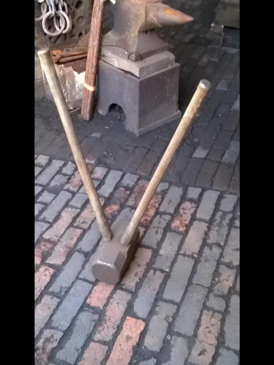

Good Morning,
Ethan Harty and Mark Ling made one at CanIRON XII, Ness Creek, Saskatchewan, in 2019. Because of their height differences, it was difficult for them to use it. Others made it work fine. there are video's online.
Neil
Looks like fun, thin there's room for a 3rd. team? What do you think the hammers weigh?
I have an old stonemason’s maul about that size, and it weighs about 16 pounds.
I have a 22lb. stone mason's maul that doesn't look as large as those. It'd sure be better suited to 2 handles though. It's a real bear to do more than drop on hot steel.

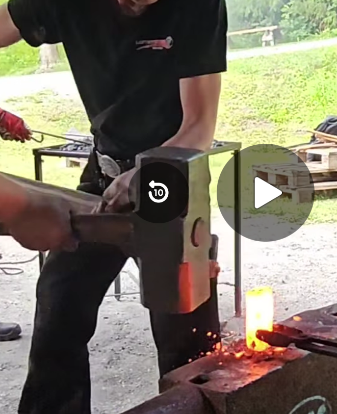

Fun video, thanks for posting.
I'd like to see how the handles are made/attached
This is just speculation but in the day, like now nobody wanted to spend more than necessary so I imagine the holes are drilled and reamed with a flat bottom, the handles would be rip sawed just enough so the wedge can be inserted and stay without widening then the handle inserted in the head and driven to the shoulder driving the wedge in simultaneously.
It's not like anybody is taking a full overhead swing, they're probably not raising the head above shoulder height so the handles don't need to be locked in as solidly as a regular sledge does.
Heck, they might have used hide glue.
And those are my morning WAGs for now.:ph34r:
You can see from this freeze-frame zoom that the handles come all the way through the head and converge in a single eye.
Boy, unless it has steel handles it must be a bolt on attachment / bracket for mounting the handles. It'd allow it to be mounted as a blacker, or other hammers I'm not aware of.
Now I REALLY want a look at the far side.

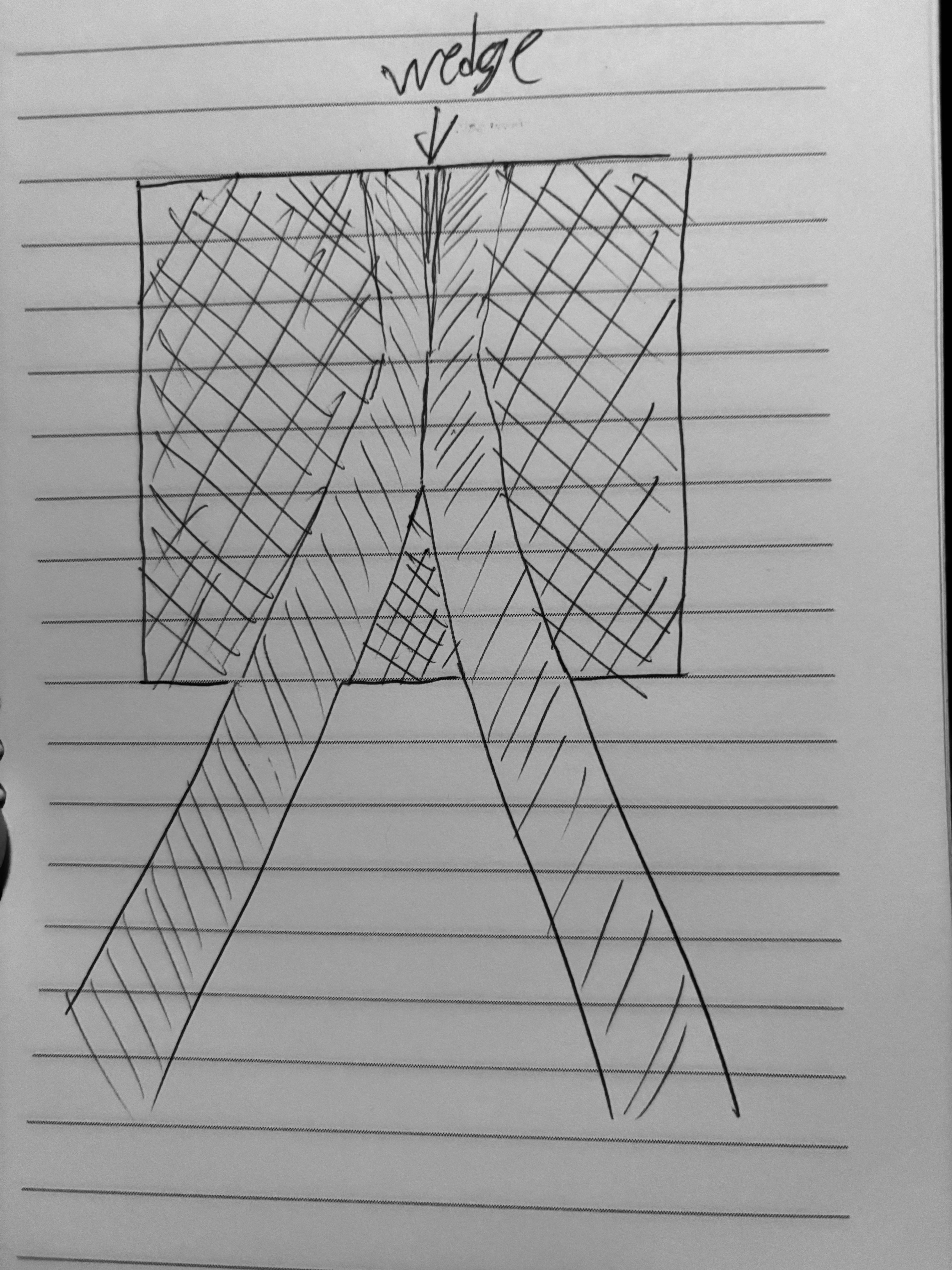

This is pure conjecture on my part, but the single eye visible in the screenshot above, leads me to think that there may be some arrangement like this:
That is to say, the two eyes (one for each handle) converge into a single eye, each handle tapers down to take up half of that hole, and a wedge forces the ends of the two handles apart, holding the head securely in place.
As I say, though, that’s just my guess.
I'd say that's a good guess, JHCC.  Makes the most sense to me.
I'll give you a maybe could be.
I just tried to sketch my thoughts and liked it not much. It didn't explain the plugged center hole as anything but a plug.
My thought was the hammer head itself could serve double duty on a blacker hammer and the double handles fitted to a Y bracket that bolts to the unseen side of the hammer head. However if a double handle bracket were being used why plug the hole?
Like I said, I don't like my idea, so far anyway. It is an interesting problem for the voices to whisper to me about though. It might come to me in my sleep next month. I'll let y'all know.
Looking back, I see that we had another discussion about these about ten years ago. Here are a couple of photos from that thread:
The first of these appears to support (or at least to be consistent with) my conjecture.

"This is pure conjecture on my part, but the single eye visible in the screenshot above, leads me to think that there may be some arrangement like this: (pic snipped)"
JHCC, if that is the case, would you guess that the handles were milled to that shape or formed wet/steamed?
I'd be interested to know the mass of the 2-handle hammer in the anchor chain picture.  Maybe over 100 pounds?
Neither; you can see in the photos that the handles are straight. In my sketch, the curve in the section within the eye is the same as results when a regular (single) handle is wedged into place inside a standard double-tapered eye.
Straight handles, securing them would be as simple as starting a wood wedge in the slit and driving the handle into the eye where the wedge would be driven home against the bottom.
Of course that's how I'd do it because I can't think of another and I doubt they would've glued them in.
Speculation is what it is, not admissible in court.
I agree, Frosty, although that doesn't account for the single eye visible in the above photo:
Come to think of it, blind-wedging the handles would make them pretty hard to replace when they inevitably break.
