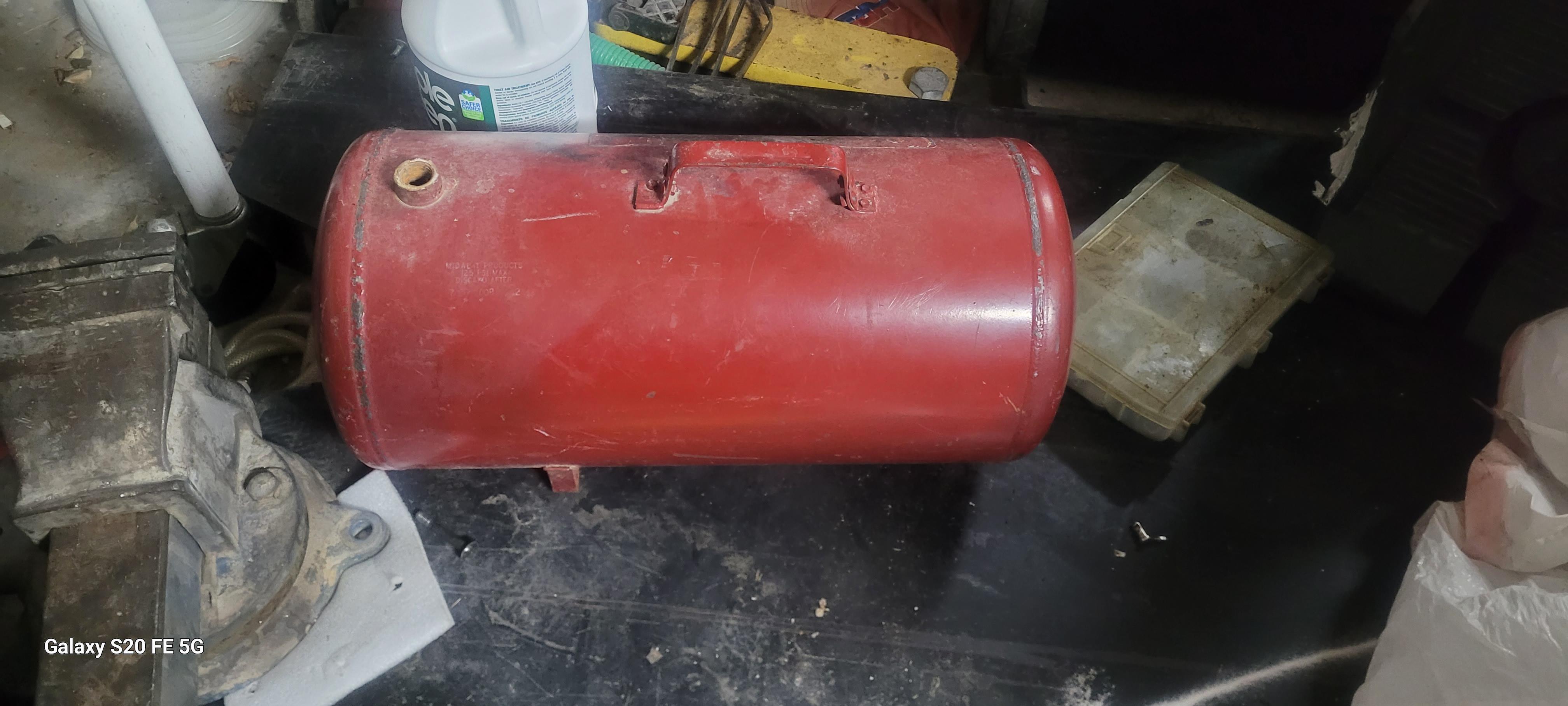

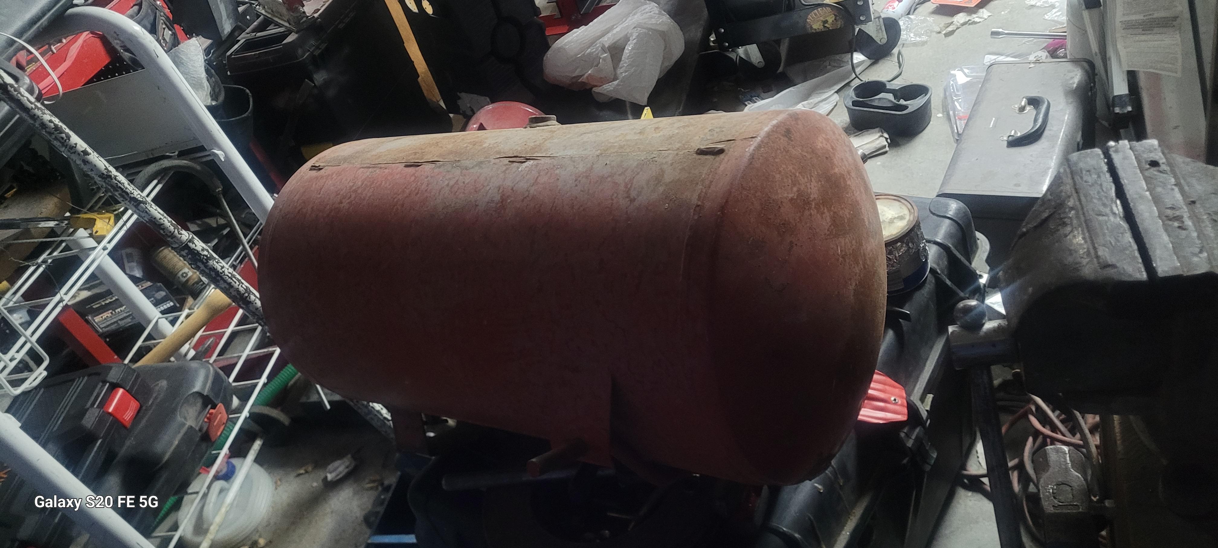

Vegasheathen Posted December 3, 2024 Posted December 3, 2024 I recently acquired 2 air tanks to make forges out of my current single burner just isn't enough I have 1 tank that's 10" wide and 20" long and the other is 14" wide and 28" long the smaller of the 2 i was thinking setup as a 2 burner lined with 2" of kaowool then refractory cement and I was planning on cutting it at both ends on the weld seam and hinging both side to open or close as needed. Both ends I'll cut a 3" tall 6" wide slot to pass through anything that's longer. The bigger tank I'm not sure if I should do it as a 3 or 4 burner. But I'll line it the same way only thing I might change is in the bottom make a slot that has only 1" of kaowool and is the size of a fire brick so I have a low spot to put fire bricks in. If anyone knows of a good source for burners that would be great i was planning on ordering them from ebay or Amazon. Any input would be appreciated since this will be my first time building a forge my current one I got as a kit and just had to put rigidizer and refractory cement in. I added pics of the 2 tanks if it helps at all. Quote
Buzzkill Posted December 4, 2024 Posted December 4, 2024 What are you doing (or planning to do) that requires that much length? For me it's more important to have height and width to accommodate odd shaped pieces. Long pieces can pass through the back of the forge. I rarely need more than 6 to 10 inches of steel heated at a time, but you may be doing something entirely different than I do. As you've indicated, more length means more burners. More burners means more fuel cost - and possibly iced up propane tanks. To determine the number of burners you need to calculate what the forge chamber volume will be after adding all your insulation and refractory. You'll want one 3/4" (well built and tuned) naturally aspirated burner for every 350 cubic inches of volume you have in your forge. If you do install more than one naturally aspirated burner keep in mind that they can interfere with each other, especially if placed too close together. At the intake end they can compete for air if not oriented correctly, and on the flame end the back pressure from one can affect the performance of another. If you have some basic tools and shop skills you can build Frosty's T burners. That's probably the best bang for the buck. Of course it helps that you can discuss any problems you have with the guy who designed the burner here on this site. Here's the link to the topic that has the plans: https://www.iforgeiron.com/topic/43976-t-burner-illustrated-directions/ I don't have any experience purchasing burners off the internet, but maybe someone else here can chime in. Quote

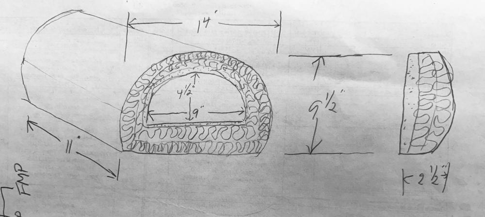

JHCC Posted December 4, 2024 Posted December 4, 2024 To follow up on what Buzzkill says (all of which I agree with), you might consider cutting down the larger tank to make the shell of a D-tunnel forge. Cut 2-1/2" from each end (these will become the doors), and then cut an 11" length of the center (this will be the main body of the forge). Line each door with 2" of ceramic wool (two 1" layers are easier to rigidize) and 1/2" of kastolite or the equivalent. You can either cut the main body to 9-1/2" high or add a shelf on the inside to create the appropriate height, and then line the body in the same way as the doors. This will give you a semicircular tunnel that's 9" wide, 4-1/2" high, and 11" long, which is almost exactly 350 cubic inches. (Drawing not to scale. Also, ignore the letters in the lower left corner; that was from something entirely unrelated.) Quote
