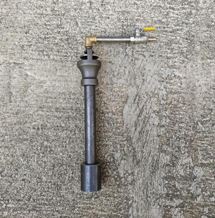

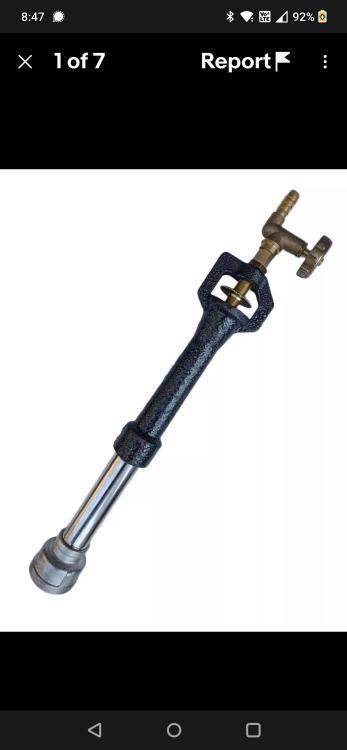

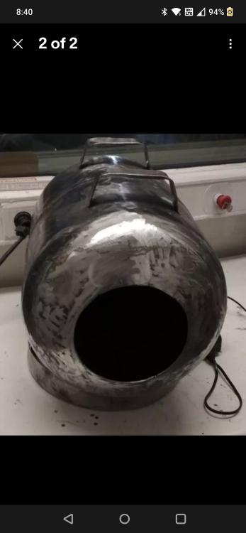

rose Posted November 9 Share Posted November 9 (edited) Hi y'all, I'll start with some context. I'm a newish blacksmith. Taken 60ish hours of classes in forging and metalworking. I'm primarily a furniture maker and am setting up a forge to be able to make custom hardware and tools. I have a $500 grant I received for getting a gas forge setup. I don't have a lot of time to devote to building a forge and probably lack a number of the tools necessary. I'm thinking I would like to buy something pre-built but it seems like most of the forges in my price range are inefficient and/or poorly built or don't get up to welding temps well. I'm considering ordering one of these propane tank forge bodies from eBay. like they have 2" of blanket insulation rather than the 1" standard for most cheaper forges. My first question do you all see anything wrong or concerning about those? Second question is if I go with that do you have any suggestions for pre-built burners I could buy to finish the build? I'll include some links to ones I've found on ebay and Etsy. I'm not sure how to evaluate if they're good or junk. For that forge body would you all suggest one burner or two? Thanks for any help! Burner links: Removed Edited November 10 by Mod30 Remove commercial links per TOS Quote Link to comment Share on other sites More sharing options...
Frosty Posted November 10 Share Posted November 10 Welcome aboard Rose, glad to have you. We can't render an opinion of the burners or forges you ask about. The rules against posting links to commercial sites is strictly enforced. The way to ask these questions is to name and describe the forge and the site you found it on. For example, two burner Diamond forge as seen on the smoky forge site. Or Ebay, etc. just no direct links. The minimum tool list isn't very long to build an effective forge/burner. A drill press, reciprocating saw, hand drill and pop rivet gun with some basic tools is all you really need. Honest they're EZ PZ. Frosty The Lucky. Quote Link to comment Share on other sites More sharing options...

rose Posted November 10 Author Share Posted November 10 Hi all thanks for your responses. I'm in Western WA on the peninsula. A coal forge is a no go as they get shut down during the summer with burn bans here. Additionally my shop is basically a garage in large commercial warehouse building. I have a big roll-up door so ventilation for a propane forge right in front of the door should be fine. Heard on the links. I'm going to include photos of what I'm considering and search terms to find their listings if anyone wants to take a look. I'm leaning towards this getting this propane tank forge body and one of the burncraft burners In order: Propane tank forge on ebay Propane gas forge burner on eBay Gas propane forge burner by burncraft on etsy Quote Link to comment Share on other sites More sharing options...
Mikey98118 Posted November 10 Share Posted November 10 To skip to the bottom line, a Diamondback single burner propane forge is the only commercial forge worth owning in your price range. I believe you will find it perfect for your needs. You will find this forge gets hot enough, and more to the point, it is made to last. Could you do better? Yes, but only by spending a lot of time learning how to build your own burner and forge. I don't think you want to spend that kind of time on a peripheral tool, right? And if you change your mind later on about how deeply you want to delve into metal work, the Diamondback forge can be easily upgraded, with the latest burner design. I would have suggested a Mister Volcano forge, as giving by far the most bang for the buck, but you are not likely to find one for sale, anymore. By the way, all the photos you posted, both of burners and of a forge shell, are second rate choices, which will utterly disappoint; just don't go there. Quote Link to comment Share on other sites More sharing options...
Frosty Posted November 10 Share Posted November 10 Ewww, those are awful burners. You see lots of those long list of mistakes being sold online. Stay away from those! Ditto Mike's suggestion, Diamond back single is a fine forge and the burners work well. Frosty The Lucky. Quote Link to comment Share on other sites More sharing options...
