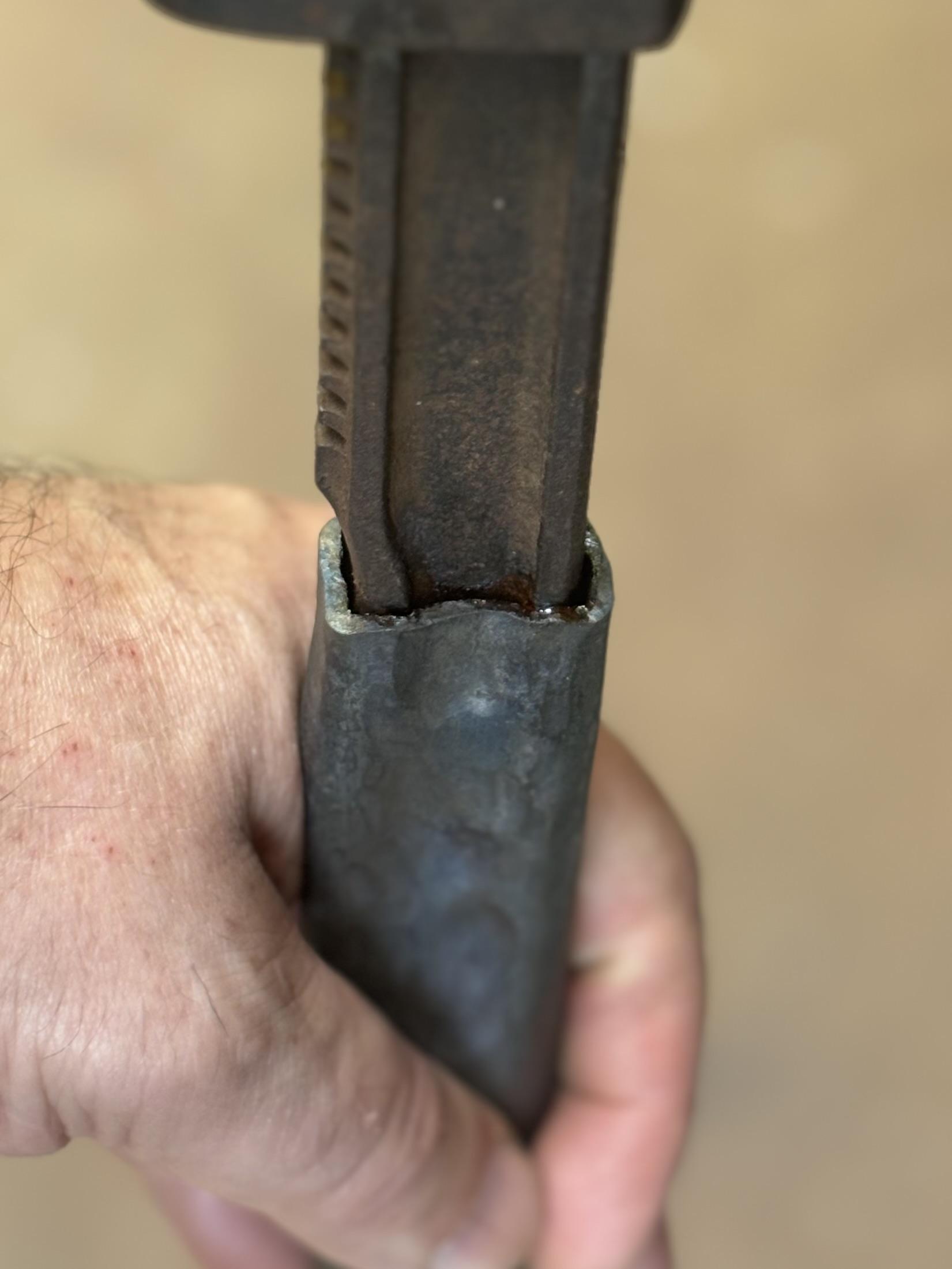

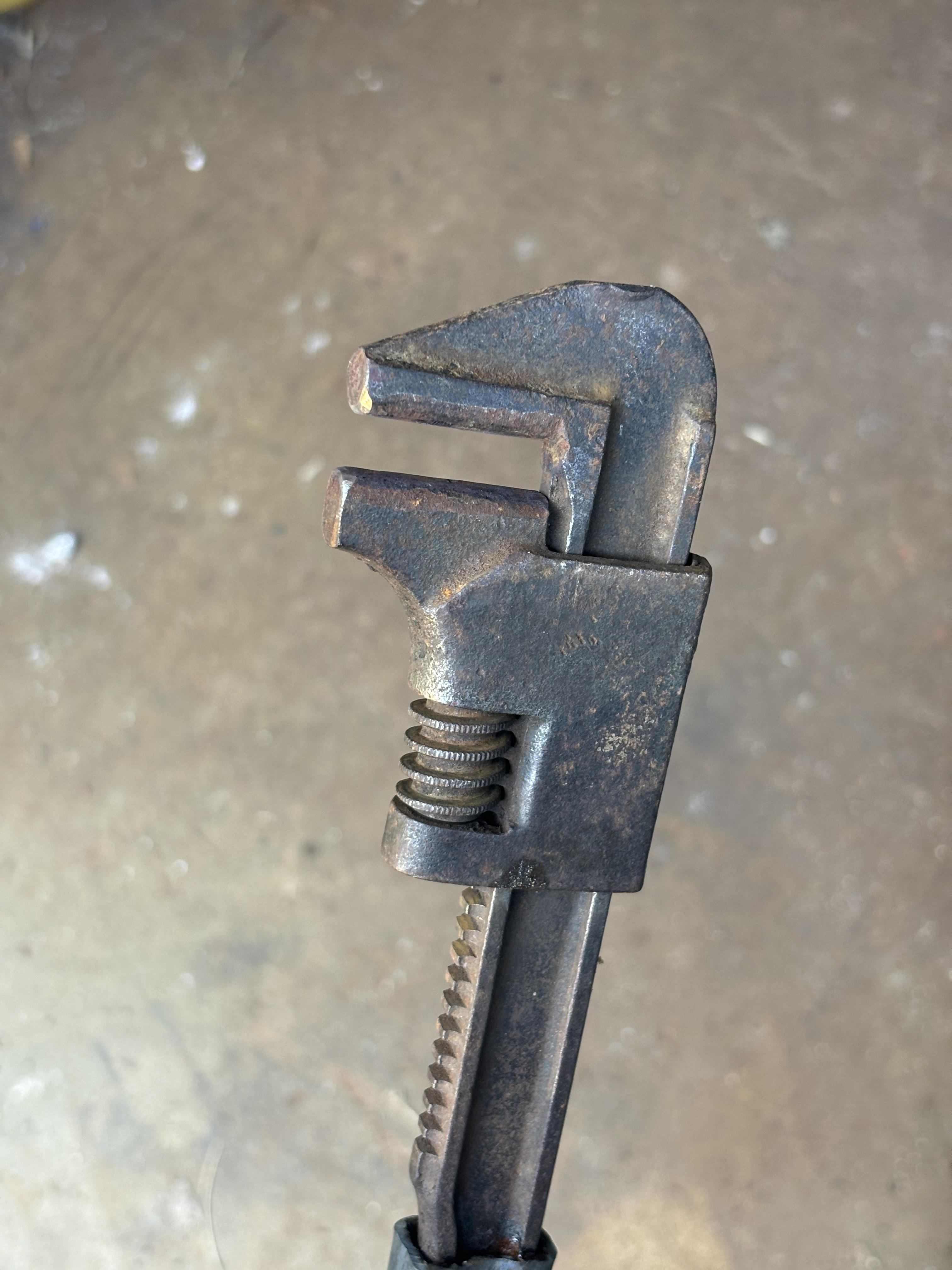

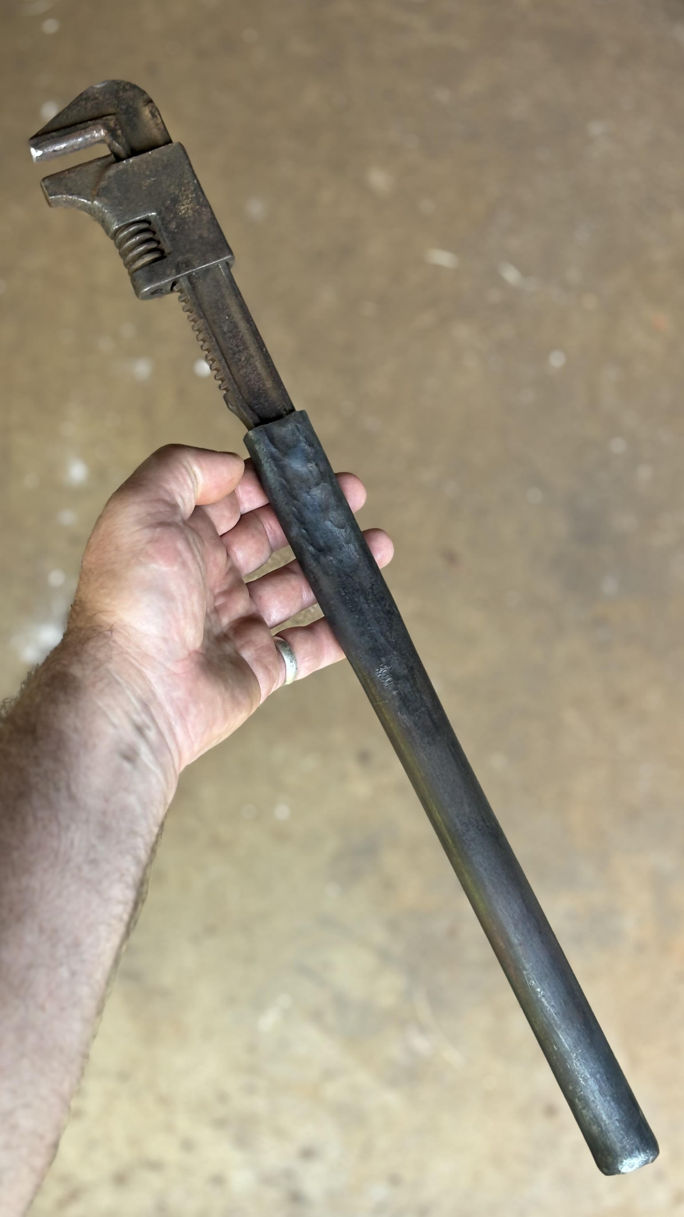

JHCC Posted September 14 Share Posted September 14 A few years back, I picked up an old adjustable wrench at a garage sale. With the jaws rounded off and with the addition of a piece of black pipe as a handle extension, it makes an excellent light- to medium-duty adjustable bending wrench. Quote Link to comment Share on other sites More sharing options...
George N. M. Posted September 15 Share Posted September 15 John, that is a fine looking monkey wrench. Quote Link to comment Share on other sites More sharing options...
masonred Posted September 15 Share Posted September 15 Nice to see an old tool get a new purpose. Quote Link to comment Share on other sites More sharing options...
Frosty Posted September 15 Share Posted September 15 I like it John. Making it a useful tool again is a good thing. Frosty The Lucky. Quote Link to comment Share on other sites More sharing options...
seldom (dick renker) Posted September 15 Share Posted September 15 I have several of those type wrenches. They make great twisting wrenches with the addition of a handle welded to the jaw end. Quote Link to comment Share on other sites More sharing options...
