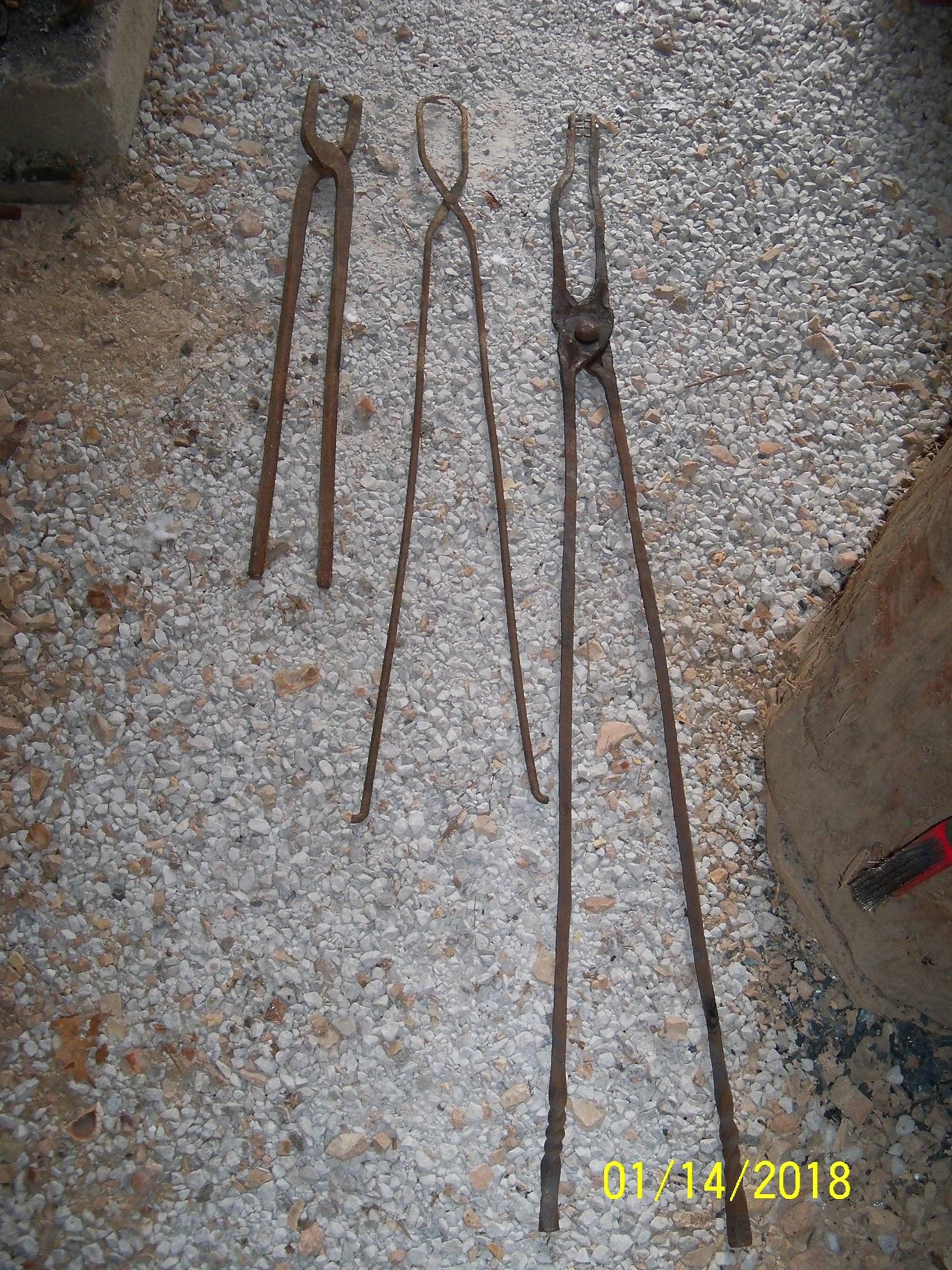

I just got a pair of tongs and a leg vise mount from a guy on Facebook.  Now I don't have to make a mount for my second vise.  I don't know what these tongs are for though.  They are long.  37 1/2" long.  Very strange jaws.  What are they?
Pickup tongs though they're awfully long. You use them to reach into a fire to pick up a piece without breaking the fire up. They're really good for snagging onto almost any shape though they don't hold solidly enough to forge with. Then you transfer the piece to fitted tongs, flats, cup, etc.
Pickup tongs in general are longer than most other tongs so that you can grab a piece out of the fire without having to get too close to the heat. They're also great for picking things up from the floor (especially hot things) without having to bend over. The shape of the jaws imparts a certain amount of spring to the grip and also allows you to grab a wide variety of sizes. Remember that all it needs to do is to get the workpiece out of the fire to where you can grab it with your working tongs, so it doesn't need to hold the piece securely while the latter is being forged.
I suspect that this particular pair may have been used in a larger industrial-type forge, where the smith needed a greater reach to get the workpieces out of a larger forge or furnace.

I have a pair of tongs like that and we used them to retrieve small fired clay items like candle holders and small necked flower vases from the kilns. Also another pair with much larger jaws to pick up fired pots etc. Here is a picture of a couple and a set of hammer tongs that I took for another thread. The two on the right are kiln tongs and the jaws are easy to adjust for what ever shape being worked with.

IDF&C, i was thinking that same thing with the kilns, maybe glass work, or some sort of blast furnace, something along those lines.
Then i also thought maybe the guy who made them just did it for no reason other than look at how long i drew these out to be.
I was also thinking they might be good for grabbing a crucible full of molten metal
Maybe a very small crucible, but you don't want to be messing around with picking up molten metal with tongs that aren't beefy enough for the job. Dropping a solid piece is one thing; splashing 2000° liquid is something else entirely.
