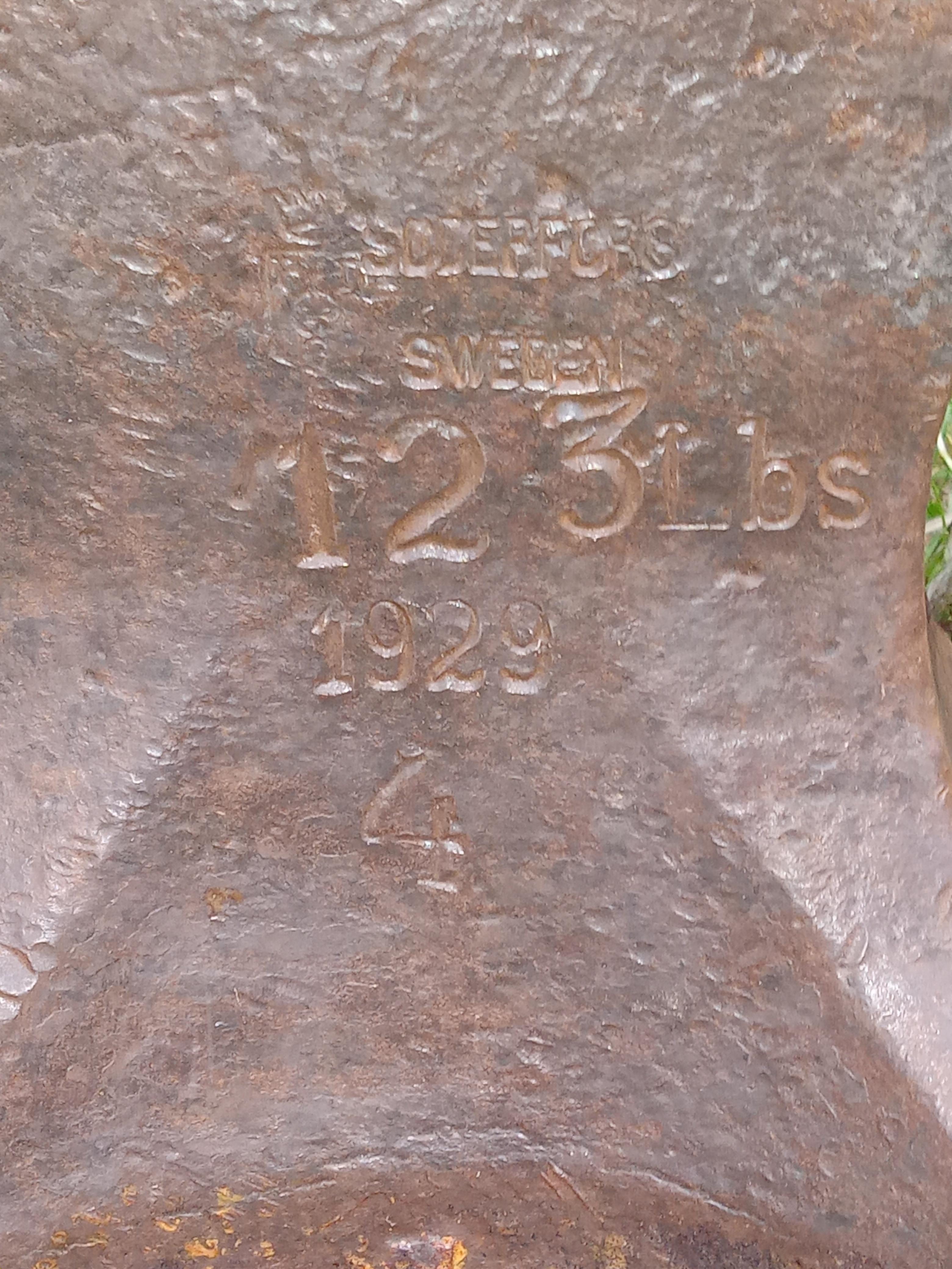

Maybe this will help just would like to know value of and who might give a fair price today so they do well as myself I surely appreciate everything everyone's time and help is greatly appreciated thanks

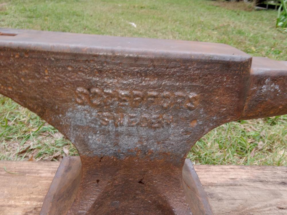

Where are you located? General location is just fine. This is a top grade anvil in a good size and visually very good condition. If the ring and rebound it good, $600~800 would be a reasonable price point in my area (south central Indiana).

Oh, Tina, that is a VERY nice anvil.  It is a top brand and has had very little wear in its 95 year life.  It is barely broken in.  Anvil prices vary by availability which means that they are more expensive in areas where there are fewer anvils available.  So, they are somewhat less expensive in the eastern US and more expensive in less populated areas like the western US.
Goods mention ring and rebound tests.  These insure that it has not been through a fire which softens the temper in the high carbon face plate and that the face plate has not delaminated from the body.  For the ring test you tap it across the face.  The ring should be clear and consistent in all areas of the face.  It may change a bit near the heel (the part at the opposite end from the horn).  For the rebound test you need a ball bearing.  You drop it on the face and measure the rebound, e.g. drop it from 10" and hold a ruler so that you can measure how high it bounces.  Anything in the 80-90% range is excellent.  70% is OK.  Anything under 50% is not very good.
I agree with Goods about value.  I wouldn't take less than $600 for it.
And 123 pounds is a decent size for a one man shop.

DRATTED IFI update cut me off and lost what I'd written. Your anvil is in near pristine condition, the original owner radiused the most heavily used edges to prevent chipping. Soderfors anvils are as good as any anvil on Earth. If you want a quick sale subtract maybe 20% from the highest, most recent SELLING price. There is always a difference between "Asking price" and "Selling price."

Oh MY!:o A Soderfors is as good as anvils get! I have it's brother, a "Sorceress" #4, 125lb. made in 1926 and I have never struck better! Yours doesn't have ANY edge chipping, a common bit of wear for Soderfors anvils. The first owner, probably, radiused the most heavily used edges so it wouldn't get chipped. Your anvil is in pristine condition the little bit of weathering on the body is no issue. Laugh if anybody brings it up and tell them Frosty said to.
What you have there is a top dollar anvil. Where you live is all important now, if you live in Sweden or close it's almost give away yard art. In Alaska it'd be cheap at $8+/lb and potential buyers would be bidding. Most anyplace in the lower 48 it's probably worth no less than $600 up into the $1k+ range. Easy.
