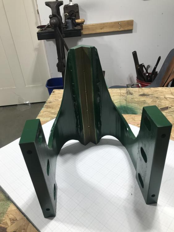

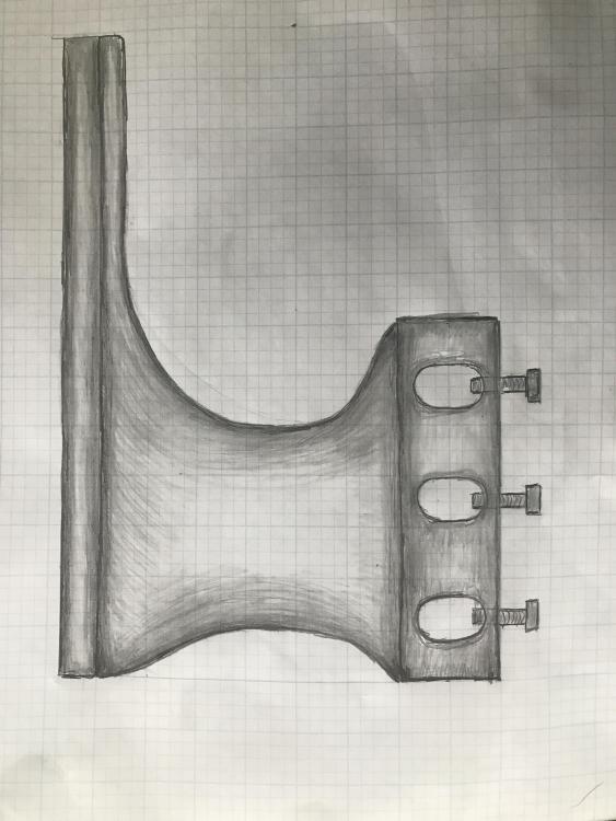

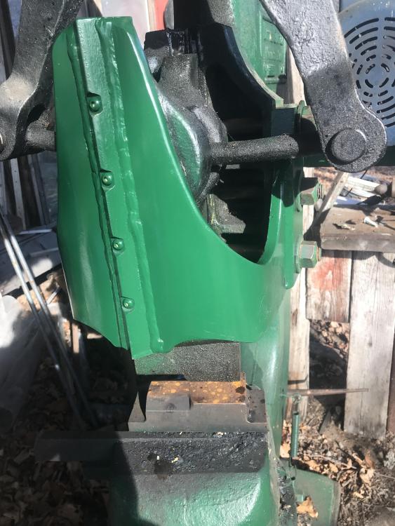

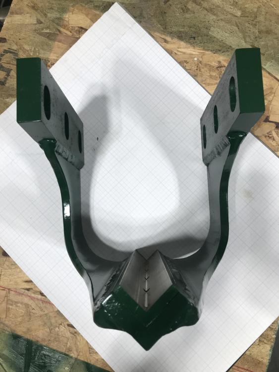

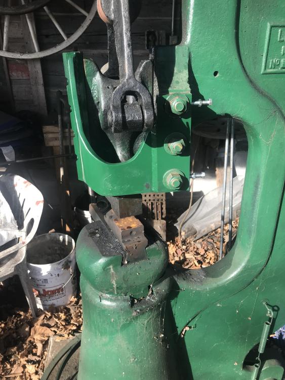

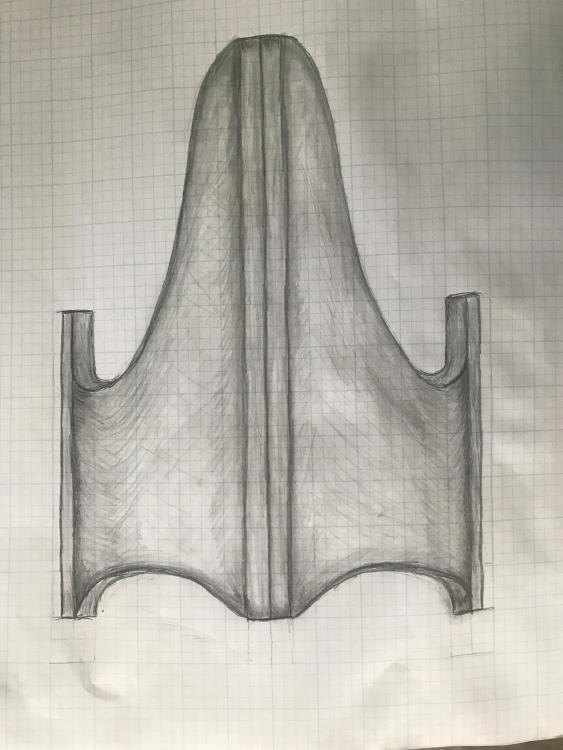

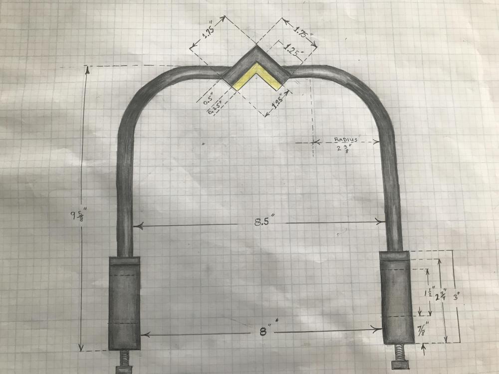

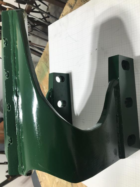

Raspberry Island Posted February 12 Author Share Posted February 12 I took the advice of Janson and went the fabrication route. I made full size drawings of the ram guide from multiple perspectives and decided on using 1/2 inch plate for the two curved side pieces, 1/2 inch x 1-3/4" x 1-3/4" angle iron for the front "grooved" piece, 1/4" x 1-1/4" x1-1/4" brass angle iron for the front liner and 1 inch thick plate for the two side mounting pieces. The curved side pieces were cut out using flat card stock patterns that I made from the original guide. They were bent cold in a press at L&M Steel in Brainerd, Minnesota where I buy steel. The brass insert was held in place by threaded brass screws in the center of the angle iron. L&M Steel also drilled and milled the oval shaped mounting holed (three on each side). I fabricated a frame to hold the 5 pieces in proper alignment for welding. The pieces were welded, cleaned up and painted. The new ram fit in place nicely and a new die key was fitted and installed. Quote Link to comment Share on other sites More sharing options...
Irondragon Forge ClayWorks Posted February 13 Share Posted February 13 Outstanding, ya done good on that one. I can't control the wind, all I can do is adjust my sail’s. Semper Paratus Quote Link to comment Share on other sites More sharing options...
Frosty Posted February 13 Share Posted February 13 Beautiful job! Have you run the hammer with it installed? Frosty The Lucky. Quote Link to comment Share on other sites More sharing options...
Goods Posted February 13 Share Posted February 13 Honestly, the drawing is just as impressive as the fabrication! I’m not much of a fabricator, but I have a lot that I should work on. I would just rather spend my time forging. Let us know how it runs! Keep it fun, David Quote Link to comment Share on other sites More sharing options...
