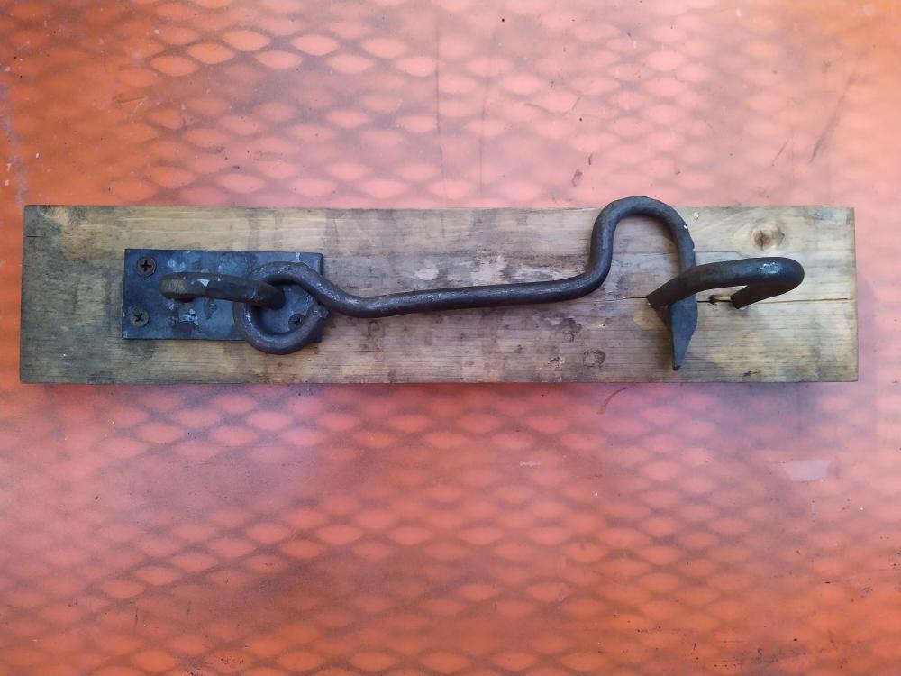

Now that y'all have been at it awhile, has any one successfully finished the gate latch?  From what I've seen it has to be prefect to the ABANA drawing, not Mark Aspery's video.  Print the drawing (Found on ABANA's web site under education) as full size.  I've made 10+ and still don't have it right.
Yes, I finished mine. And yes, I laid it on top of the full page printout when I sent the photo to my coach. I made 4 before I finally got it perfect.
What part isn't lining up for you? Have you talked with your coach about it? Tomorrow (Tuesday) is the final video session and they'll be covering the latch project. Hopefully you get some good tips.

Can you post a pic of your finished hook? I'd like to see a real world completed level I hook.
My problem has been with all the opportunities to screw up, (overall length, length of hook, curve , ring size) I always find one or more item that just doesn't measure up.
Were you in the course? And if so, have you asked your coach for any feedback? They should be helping you - that's what you're paying for, lol
I don't mind trying to help - I'm not trying to get out of it - I just wondered if there was a coach not holding up their end of the deal.
So, here's the pic of my finished and approved hook latch:
He had declined my previous submission noting the eye wasn't correct - and sent me an image of what the eye should look like. I took my hook eye and laid it above the picture he sent to show him they looked the same to me and asked what I was missing. I also sent him step-by-step pictures of the hook so he could hopefully tell me exactly where I was steering wrong. But he ended up passing it, lol
If you don't have a coach - hit me up in the Messages and I'll share my coaches notes with you to see if that helps.
No, it was just a single fold over. My double fold (with the filler material) kept showing side seams and the coach didn't like that since he couldn't tell from a photo if it was a weak weld it just a visible seam from the weld. He suggested a single fold over instead so that's what I did.

If I recall correctly, I had it very close to the specs provided in the drawing. I don't know that the instructor would have split hairs over a fraction longer or shorter though. Mostly he was focused on the bends and dimensions of eye and hook ID.
