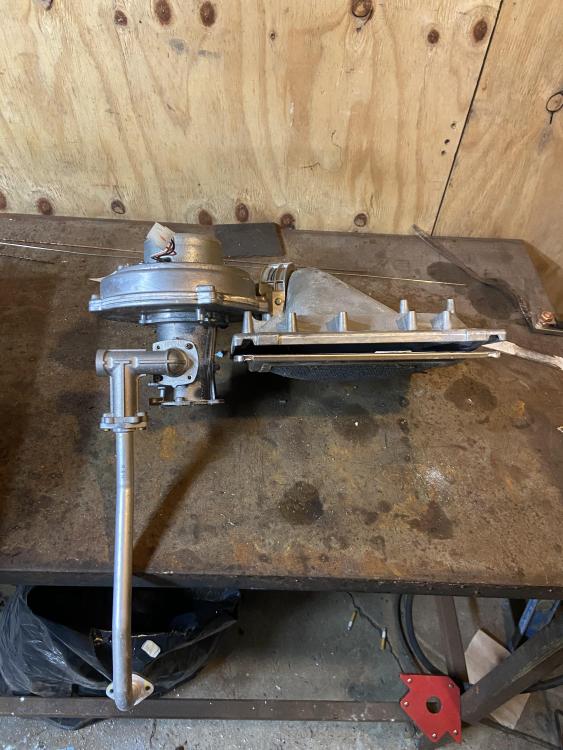

Frosty, the burner came out of a Navien NCB 240 combination boiler. That was the first burn and I was messing with the gas and the blower. At standard household gas pressure they run around 97% efficiency and it’s just a small panel of blue flames. It’s designed to fire down through the heat exchanger. They’re reliable, if they’re serviced annually. https://s6e1619fceb451b6f.jimcontent.com/download/version/1512634722/module/11899834199/name/Navien Gas Boiler NCB-Service-Manual.pdfimage.png.5996c5564c6ac41fbf2b71a328fbfb4b.png
Also, the metal mesh was cool to the touch 30 seconds after shut down.

Hmm.  That looks a lot like the inner workings of the Richmond tankless water heater I installed last year.   Mine runs on LPG, so if it fails I'll definitely scavenge the burner assembly out of it.  Like the others here, I do have concerns/doubts about it holding up in a forge environment.  However, if it does hold up that gives us another potential source for burners without a lot of casting.  Thanks for bringing this up.
You’re welcome Buzzkill. I have 3 more of these old units that I’ve salvaged so I can sacrifice 1-2 to the forge gods in experimenting. I ran it for about 2 minutes and the fiber metal was cool to the touch 30 seconds after shutdown. I’m going to see if Navien has the temp rating for the fiber, the housing is aluminum.

The blower for these units is palm sized. I'm wondering if a naturally aspirated version is doable without  exceeding the normal home shop equipment and expertise. From what I could see the thing is not much different than a multiple outlet burner. Hmmmm. Maybe when it gets warm I'll hit the local HVAC service company in search of a couple to take apart and see.
Funny, we'd be talking about NA propane forge mantles instead of burners. Sounds like fun.

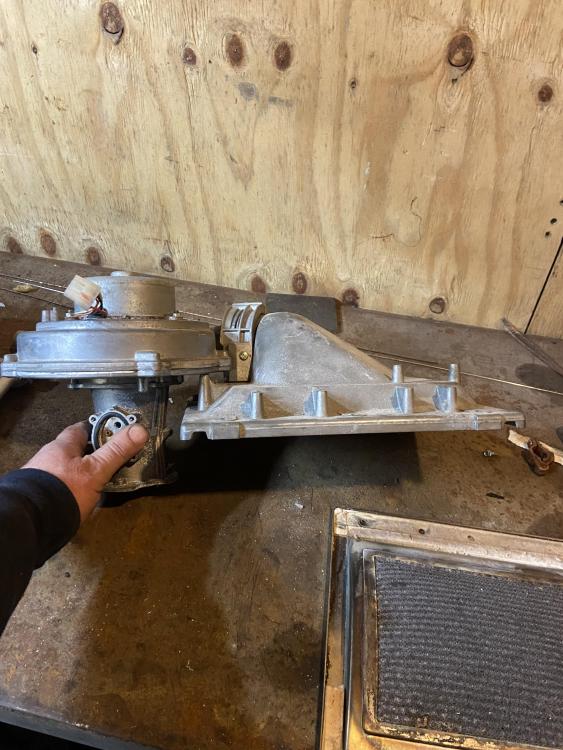

Buzz, yes the fiber metal can be removed. It’s held to the manifold by 6 bolts. I’ll check to see if the frame can be separated easily and let you know.
Frosty, the blowers that come with the unit are 24v and connect to the manifold in a pretty unique way. Connecting to that setup would challenging with the tools I have. I’ll take some more pics tonight and post them.
Here you go, guys. The small tube is from the gas valve. The blower sucks gas and fuel in. The oval with the rusty screws is the gas orifice, this one is for Natural Gas. Side note, that orifice is the only thing you have to change to convert it to LP. The screen frame is actually stainless and it looks sintered to the frame. Frosty, you can see the funky slotted collar that connects the blower and manifold.
Oooh, that's doable! I love a gun burner that introduces the fuel gas into the blower, especially if it's been designed that way.
A little tweakage of the plenum's shape  to get everything farther from the forge chamber and some creative thinking to mount the fiber and outlet (diffuser?) plate and it might make a good forge burner. If nothing else I'll bet it'd make a nice heat treat oven.
