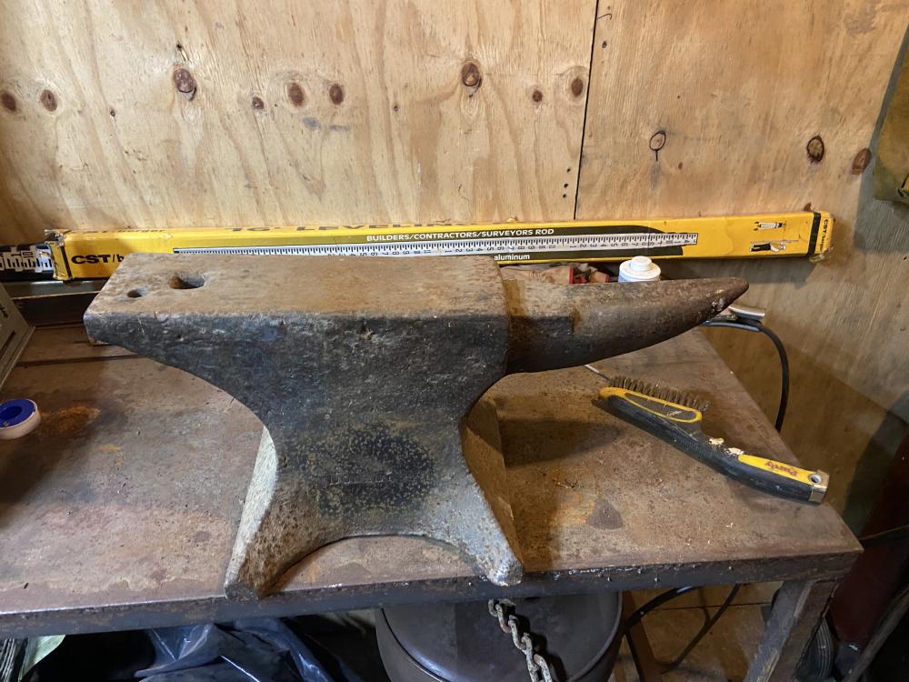

  6. I got this anvil from a neighbor for $50. It weighs 155lbs. It was their great grandfather’s who was a farrier in Central New York. Any help is appreciated!
